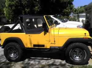

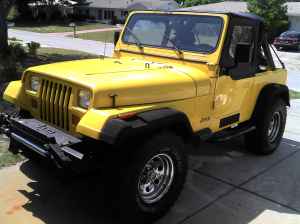

I can get something like this for under $5K which is about my max budget.

What is the towing capacity of the jeep?
My biggest concern would be the weight of the jeep compared to the boat/trailer. Knowing that most braking systems on boat trailers now a days are surge brakes on one axle, I'd want my towing vehicle to at weigh more then what I am towing if I'm going out on the highway with it.
The center of gravity also on a jeep would scare me pulling a 20 foot pontoon. I think making a quick swerve could send the whole thing on it's side???

Not sure, but found this on a website
Capacity
Jeep Wranglers have a towing capacity of 3,500 to 4,000 lbs towing capacity. This means that the loaded weight of your trailer (weight of trailer plus all gear) should not exceed this weight range.
They also addresses the issue of sway and weight control.
Weight Distribution and Sway Control
Adding weight distribution to your trailer helps to keep your Jeep and trailer level and distributes the load you are carrying more evenly. Adding sway control can help your trailer withstand gusts created by sharing the road with large trucks or towing in strong winds. Sway control is particularly helpful with enclosed trailers that have a large surface area.

Found this on another website...
Ever heard of 'the tail wagging the dog?' think of the jeep as a lap dog and stick the tail of a great dane on there and start wagging... thats why towing with wranglers generally isn't the best idea.

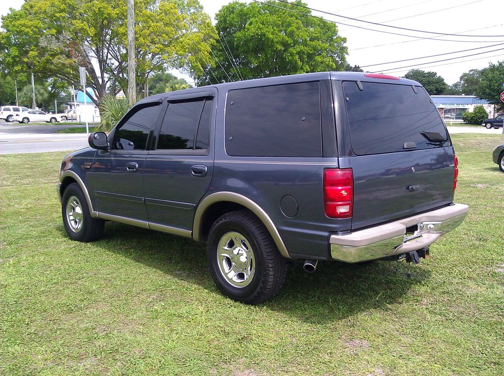

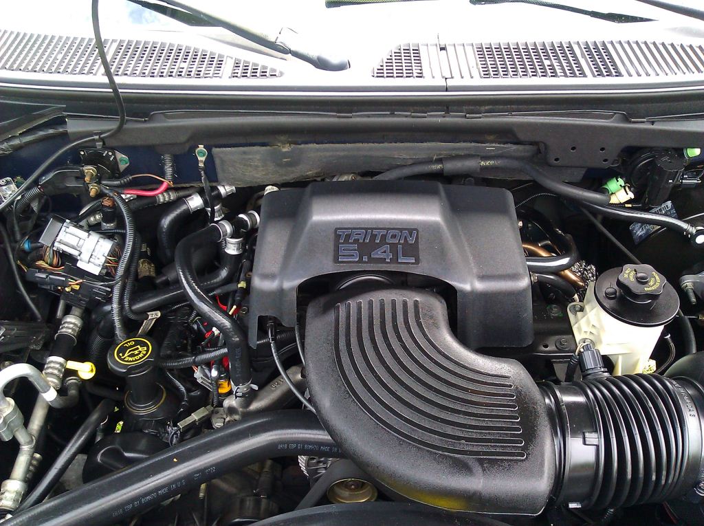

Maybe an Expedition would make a better tow vehicle. Anyone have one? The suv's in my price range have pretty high miles in the neighborhood of 125,000 and up usually. Do they have enough life left to make it a decent purchase?

Ron, I tow with a Yukon XL which is just a little smaller than the expedition and it does pretty well. Can't get above 60-65 without the trailer starting to sway, but don't feel comfortable towing an 8 1/2' x 34' trailer behind me at those speeds anyway.

I have 2 Expeditions, a 98 with 200,000 on it and it still runs like a champ, averages 14-15 mpg on rural roads lots of hills, 8-9 when pulling the toon.
We just picked up an 09 and it averages 19-20 on the same roads, 12-13 pulling the toon.

Ron, we had an 06 Explorer that we traded for the 09 Expedition, it pulled our toon pretty well it had the 5800 lb tow rating and 4.0 v6, to get the heavy tow package they use a lower rear gear. It got 17-18 mpg regularly but only 9-10 towing. the only prolem towing with it was if you got a heavy cross wind it would move over a half a lane or more on the road. with your boat that could be less of a problem. The Expeditions don't move at all in a cross wind.
The 98 Expedition has the 9500 lb tow package (low rear gear and part of the reason for the lower mileage)
The 09 Expedition has the light tow package 5500 lbs and the higher gear so it gets the better mileage. we are up hear in the White Mountains of NH so that also hurts MPG, with FL being pretty flat you should be able to get a little better mileage.
