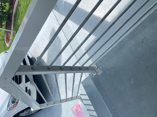

This some railing I built for my porch, but it would work on anything all materials available at Home Depot. Very inexpensive. See picture. Made from screen cage aluminum and EMT conduit.

#11 Post by mgarvie » Sun Sep 18, 2022 7:29 am
That may be what I need! Framing for a pool enclosure and railing netting like you would get on a sail boat. It would keep the dogs in ,the Asian carp out, and I can see my fishing line and dogs through it. Think I found my winter project.
