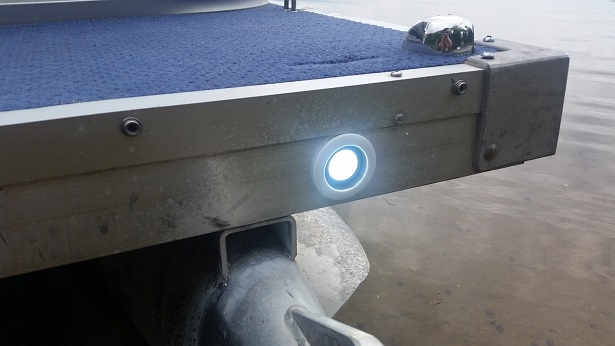

[quote="curtiscapk"]SWEET! I still have to hook these up but man are they bright!
https://www.pontoonstuff.com/collection ... king-light
use forum10 as a code for 10% off too.[/quote]
Nice. I don't think those were available last year when I made my own (LED).
You can see the imprint in the carpet left by my trip hazard lights.

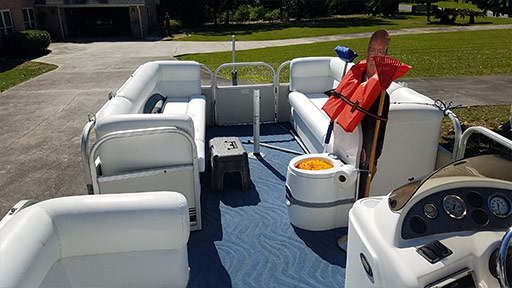

Sooooo... I get home from work today and my neighbor buddy decided he needed to announce that the new porta-potty arrived. He enlisted some great help! LOL
Plus -- A look at how things are shaping up. Getting close!

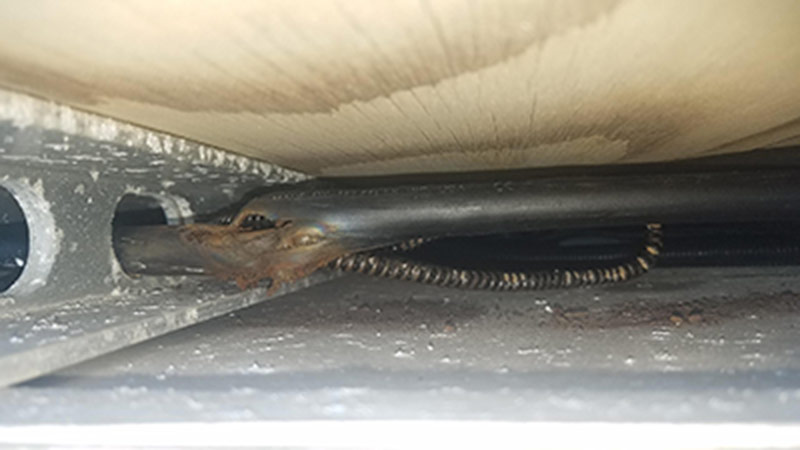

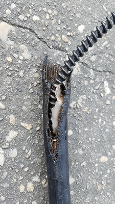

Holy Crap! Trying to fix my broken steering cable, I couldn't get the cable to pull out for love or money. I just thought I was doing something wrong. I just thought it was because the steering cable was bundled with other wiring. But Noooooo! Toward the back of the boat the cable had been rubbed enough that it blew out. The interior cable had blown out of the outer shell and had a loop in it about as big as your hand. You can tell by the discoloring how long it had been that way.
I'm amazed it steered at all - even for a short time. Getting that out took until dark. Back at it this morning. Maybe now I can get it fixed!

What does a rubbed, broken steering cable look like? THIS!
And of course, the next monster rears its ugly damn head. Geez! When it rains it pours.

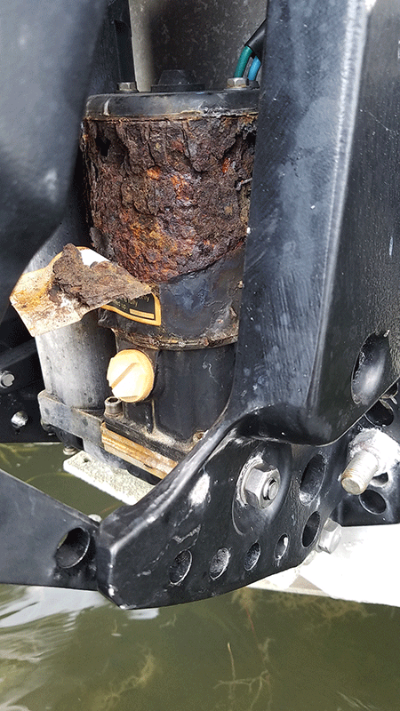

QUESTION for you mechanics -- Can I verify that the trim motor is dead by touching the leads at the motor with a voltmeter looking for power? Right now, I have no trim control, but am concerned that it may be a yanked connection somewhere from the steering cable pull. Then - No power = pulled wire. Power, but no response = dead motor. Could really use some insight. Thanks!
Does it EVER end??

HOLY CARP
I don't think you need a Multi-meter for that diagnosis

I know you're right, bansil. I guess what I am/ was hoping would be that it work just long enough to get it to the launch and on the trailer. You can see in the picture that under the motor I'm on the lift. I did the steering cable replacement booger standing in waist deep water for 2 days, but I can pretty much know that this is gonna be a driveway job. Dammit.
Oh, and obviously trim motors aren't cheap.

Do you not have a bleed valve you can loosen for manual operation?
Do NOT be under motor when you loosen it, that shit be heavy YO'
what year or model and SN of engine, we can look for diagrams or a manual.
mine has a manual bleed, as well as manual electric controls on the side of engine (great for installing transom saver)
