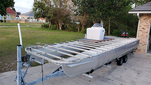

I'll get some new pics up soon. I'm still having to work, even though most everything else is closed. That means the boat work is in the afternoons after I get home. Got about half the deck off yesterday. As so many already know, old bolts and screws don't give up easily. And some SOB was apparently paid by the number of screws used! :x
Found that some of the strange deck boards sizes are due to the way they installed them. There are 2 separate pieces on the frame on either side of the transom cut. Then the 4X8s started. I thought it a bit out of the ordinary, but it won't be hard to replicate for the new floor. :| Famous last words...
Moving along. The tedious console wiring removal, frame cleaning/ prep, etc. is still to come.

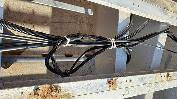

#23 Post by TWB » Fri Mar 20, 2020 6:09 am
Continued removing deck boards yesterday. Now down to carefully disconnecting and labeling all wiring from the console to get it gone. Hoping this afternoon will lead to a fully naked, clean frame.
Gonna devote a bit of time to cleaning up the wire runs while it's laid open. I'm not sure what the thought was with the way some of it is just piled together. I like neat and organized.

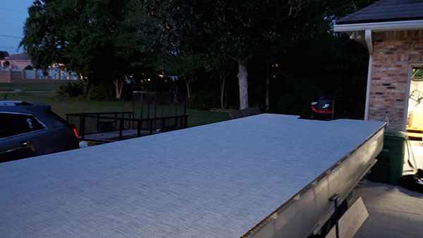

#26 Post by TWB » Mon Mar 23, 2020 7:33 pm
Got the deck laid (finally). Starting to look a bit more like a boat again. Getting excited to move on the flooring soon. :alright

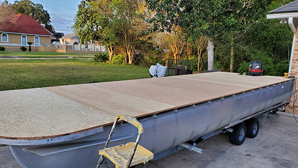

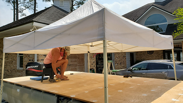

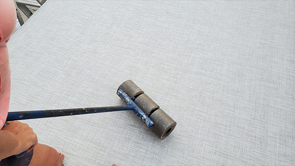

#27 Post by TWB » Sat Mar 28, 2020 7:24 pm
Got the deck laid and sanded all the putty and paste... much thanks to my wife for pitching in. :nana
Flooring went down and (if it's still there in the morning) I'm tickled to death. That REALLY feels like progress! :alright :alright
