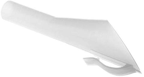

Had a similar problem on my Premier. Took forever to figure out. There's a safety mechanism that the pump on the trailer by passes but that does not get bypassed likely by your Dockside pump. Search ford fuel funnel or Nicemeet funnel. I've attached a pic. Works like a charm and it's cheap. I have no idea why it wasn't standard equipment on the boat!

#6 Post by jediger » Fri Jul 26, 2019 6:39 am
There's an anti backup valve that the nozzle has to get past somehow. Gas stations with commercial pumps seem to do it just fine. But every time we tried to fill up at the dock it would take forever and we get blowback. Took me months of asking questions and talking to people. The manufacturer finally sent me two of those funnels. Work like a charm! The book sucks down gas like a champ now.
