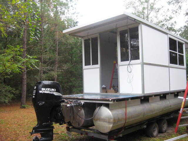

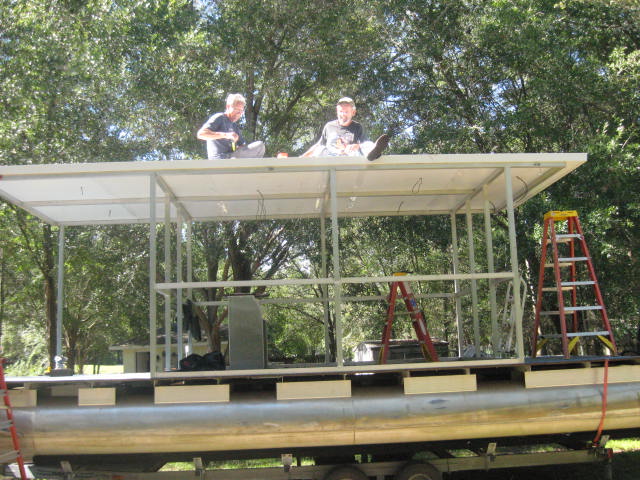

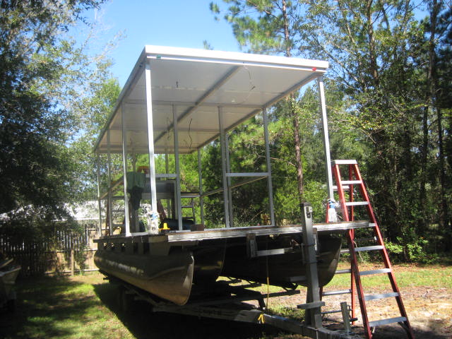

I started this some time back and after gather and assembling the parts and materials the project stalled.My brother in law and myself had built the cabin frame,installed the third log and new deck.I then hauled it from Okeechobee Fl. to my house in Inverness Fl. were I built the windows and put marine vinyl on the deck.The project stalled because I needed a hand with the panel and windows etc;thankfully my brother just retired and agreed to help finish it.The deck is 25',cabin 8' x 12',it will sleep four and has galley,hot water shower and chem.toilet.These pictures show the early progress,I will post latest pics as soon as I can get them down loaded.

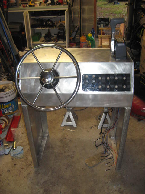

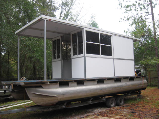

Here's some more shots of the boat with side panels and windows installed.Panels are 3" foam w/alum sheets[roofing panels],windows are aluminum framed w/ acrylic panes.The windows I found on craigslist at a fraction of the cost,I had to cut them to size of course which was no easy feat.Also you see a pic of the console with top mount shift and switches.Out back it will have a hot water shower a chemical toilet and Camp Chef stove w/oven inside.Hope to have it in the water by the end of this month.will finish the inside as I decide how I want to lay it out.
