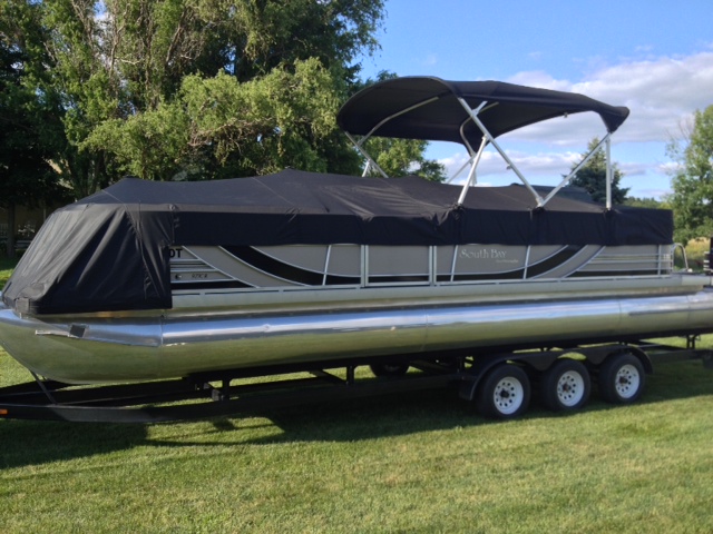

On a side note I had the cover finalized yesterday and got the bimini fabric on as well. VERRY satisfied with the finished product, even though the price has increased a couple hundred bucks in the last 2 years.

Cover looks awesome Ty, I'll need to have one of those made for my toon when I get it finished.. What are you using for the support poles under it? And can you trailer it?

Thanks Ryan. I'm really picky about having oil injection...and I think it's a huge selling point. I know...to each his own. The cover uses the adjustable cam lock poles that fit the plastic vented tops. It's a factory cover. Another (small) bonus of living up here in the artic circle for 6 months of the year...just run down to the shop that makes all the covers for South Bay, Bennington, etc etc etc. Technically, no cover that does not have safety straps is a towing cover, although I did trailer a short distance with it. I never trailer with my cover on so it doesn't bother me.

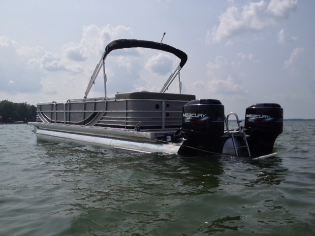

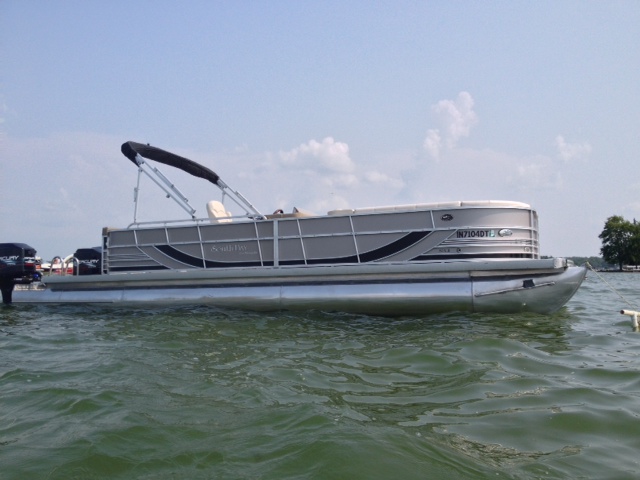

WHEW...what a busy couple of weeks. I've been working out the bugs on her and have come a long way. I figured out my oil injection issue, fixed one faulty gauge, and ALMOST have my water in the fuel issue taken care of. Thought I had it all out but man that pesky water seems to come out of no where. Still some tinkering to do but the good news is I spent a few hours on Saturday AND Sunday on the lake! Did some fishing, some swimming on the sand bar, a few cold ones, and oh ya....some speed testing
Full tanks, lightly loaded, motors trimmed all the way down, running in approx. a 2' chop she cruises at a solid 30MPH at 3K RPM. She tends to stay at 10 = 10 as you speed up so approx. 40MPH / 4K, and just below 50MPH / 5K.
Then I trimmed up...HOLY CATS
. As you can imagine this boat stays on top of the water pretty good. But man you hit the trim and it JUMPS out of the water! I only picked up about 200 RPM but jumped up to 56-57 MPH and might have seen it hit 58 once
So at this point she sits at a best of 57MPH at 5200 RPM. This is on my pair of 23 pitch Mirage props. I have a pair of 19 pitch Raptures but I doubt I'll ever have the boat loaded enough to even bother testing them. I still need to fix both trim gauges, and I never even came close to blowing out so I'm guessing this set up is good for a solid 60MPH with some more tweaking and seat time. Anddddddd....here's the proof:
