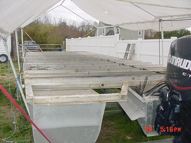

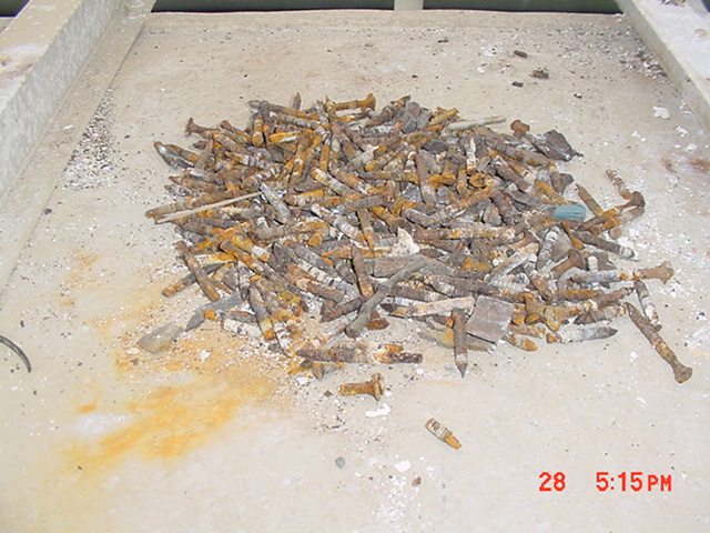

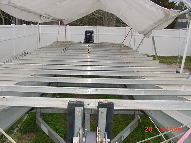

#22 Post by VaGent » Thu Mar 28, 2013 3:28 pm
Finally got some half way decent weather to work on getting the rest of all those 2,150,496 RUSTED aggravating screws out of the cross members today. :x :x :x I couldn't get my mini sawzall into the areas I wanted to & it vibrated too bad to cut the tops off the screw heads off so I had to break every single one of them off one at a time top & bottom BUT I got 'er done. :happy :happy :happy With that job out of the way I am ready to acid wash the cross members, transom & the logs. Then I'll install the under skinning & follow that with the pontoonstuff electrical harness as well as the plumbing for the aerated live well & any other electrical wiring I might need like speaker wires, & other items. THEN I will be ready to install the deck. My son who is going to OWN THE PONTOON when it's done, wants to put a product called Kiwi Grip on the deck in order to have a non skid surface to fish on. A good friend of his has it on his 24ft pontoon boat he uses only for fishing & he swears by it & has told us he has had on his pontoon for the past 8 yrs without any troubles at all other then a couple of minor repairs where he had dropped an anchor on it. He said he touched it up with a paint brush & you can't tell where he made the repair until he shows where it was at. So, since it's my son's money & his boat I suppose that is what is what is going to be going on the deck. Any comments would be appreciated good or bad.

#25 Post by VaGent » Sat Mar 30, 2013 2:33 pm
Was finally able to get back on the tear down. Got all of the last remaining rusty screws out of the cross members & the old deck tape peeled off too. Need to grind down a few screw heads that broke off close to the surface & then it will be ready to acid wash the entire thing. Got the plywood almost ready to install after I put in the wiring harness & other wiring for speakers & lights. Then I'll under skin it & then put the deck down for good. Want to leave plenty of open working space to install everything. Ordered the Kiwi-Grip anti skid material & waiting on it to arrive. Once warmer weather gets here I'll have everything together to get the rebuild done & ready to go fishing.
