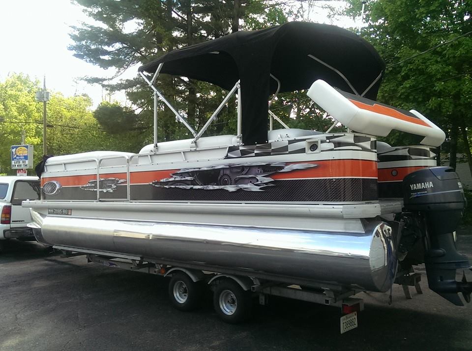

#22 Post by ROBBSRACINGENGINES » Mon May 26, 2014 5:45 am
I finally got the wrap done. Its getting there.
I planned to post a pic but for some reason its not letting me.
ROBBSRACINGENGINES
Posts: 73
Joined: Sun Aug 28, 2011 9:40 am
Location: New Hampshire
Re: 2001 Godfrey Marine Aqua Patio 240LE
#23 Post by ROBBSRACINGENGINES » Mon May 26, 2014 5:49 am
I figured it out. lol
Pontoon with wrap.jpg (114.29 KiB) Viewed 15434 times

#25 Post by ROBBSRACINGENGINES » Wed Jun 22, 2016 7:06 am
Back at the resto. I upgraded the engine to an 80 Hp Yami. Still wanting a 150 but its much much better than the 50hp was. Also got the underskinning finished up last week. Big Big difference in the ride when the lake is rough and I picked up 3 mph. With the 50hp. max speed was 16 mph. With the 80hp. I went up to 21 mph. With the underskinning I am up to 24 mph. Light load and just me onboard. All verified using the same Garmin GPS. Pics to follow.

#26 Post by ROBBSRACINGENGINES » Mon Jun 12, 2017 7:30 pm
It's that time of year again. I'm back at the pontoon boat. I sold the Yamaha 80hp and just bolted on a 2006 Yamaha F150. I can't wait to get it wet. I also finally purchased the lifting strakes. I got the factory ones that Godfrey is now using on there 2 tube toons. They are 6" on the bottom and 5" tall. I'm running into some problems trying to find someone willing to do the welding to install them. At least with the tubes installed. If I take them off no problem finding someone. To those who have installed there own strakes how did you go about getting them welded on. Everyone I have spoke with about doing it is scared.

#27 Post by Harvey » Wed Jun 14, 2017 6:10 am
I had to remove my tubes to get the weld shop to weld my strakes on. I added a center tube off a old toon I found and added strakes to it also. Installed a new Mercury 250 hp four stroke. I'm enjoying the toon now. What a difference. 50 mph top speed. Cruise at 30 mph all day at 3500 rpm, 3.7 mpg at that speed. Love it.
2007 Party Craft tri-toon
Mercury Verado 250 hp
50 mph
#28 Post by Bamaman » Wed Jun 14, 2017 9:04 am
You might want to see if you can find another Aqua Patio toon around with strakes that you can use to copy the exact positioning of the strakes--taking measurements.
I see no reason that the stakes cannot be welded on with the toons mounted. Gorilla duck tap would hold the strakes onto the hull strong enough to tack weld them on.
You should be looking for a superlative welding shop as I assume they'll have to be good at TIG welding to mount the strakes. With .080 inch thick toons on most boats, the metal's pretty thin. But it's not an impossible job for the right welder.
