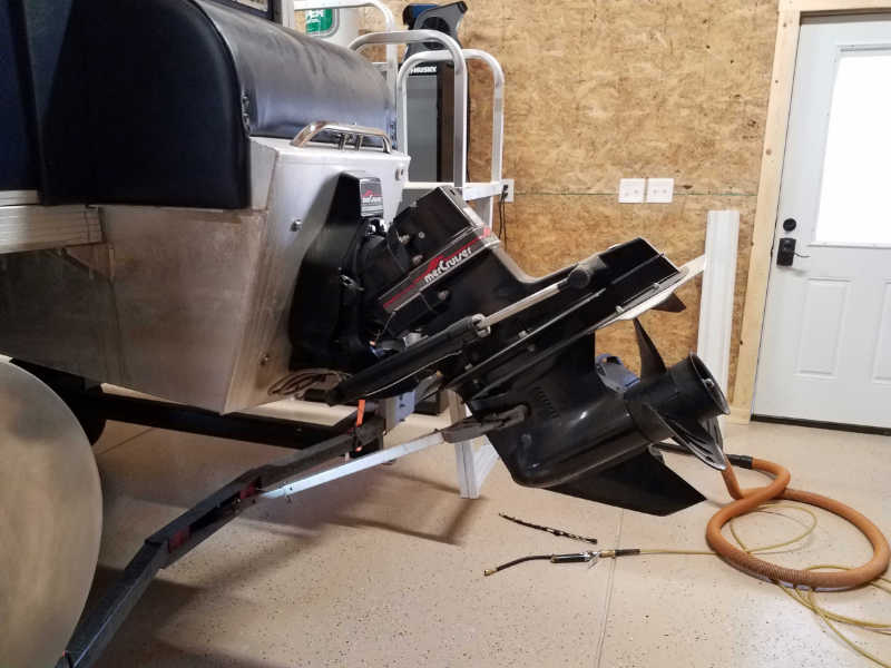

completed the gimbal bearing/bellows job,
was not as hard as i expected, next time should be a breeze.
discovered a few things along the way such as the gimbal has been taken apart before.
Here's a thought, when you take the gimbal apart, I would suggest re-installing all the seals. The PO did not bother to do that, I am not sure how long the gimbal bearing has been bad , but it has been a long time.
new bearing in place:
here is just one of the missing seals: there is supposed to be an oil slinger type seal on that shaft right at the water pump housing this was one of at least four that were missing, the other were more critical, but i was too greasy to get photos.

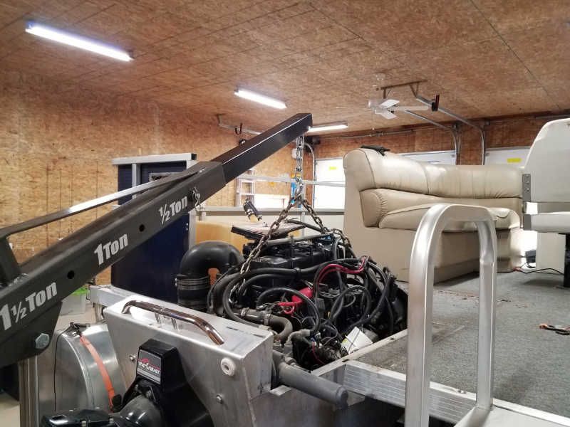

the old heavy i/0 is coming out this week. a few electrical connections are all that's keeping me from unbolting her.
the new shop is a bit bigger, so i have room to really tear into her. sourcing a new transom or third tube now, sourced a newer mercury efi 150hp out board

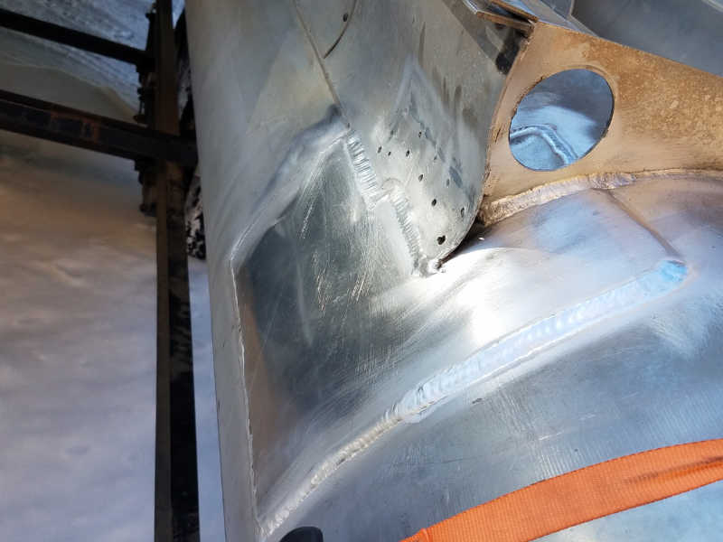

have arranged for the stress cracks to be tigged over with new patch

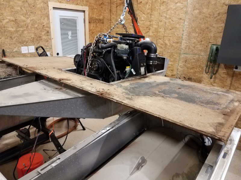

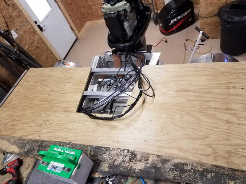

the engine pod is ready to come out, easy peasy
i will have to take part of the deck apart though to remove it cause the previous owner or the manufacturer siliconed the crap out of it. need new crossmembers across the transom anyway so not such a big deal.

Ill make adjustments and get some posted, the boat has been at the local welder to have the minor damage from the old I/O patched, I bent some aluminum and made him templates of what i wanted, he reworked some 5250 to match. i should be able to pick it up today,
the donor motor is out of the donor boat, new transom with integrated feul pod is here as well as the new console, new binnacle throtle, switches, gauges were sourced from the donor boat as well as the entire wiring harness,

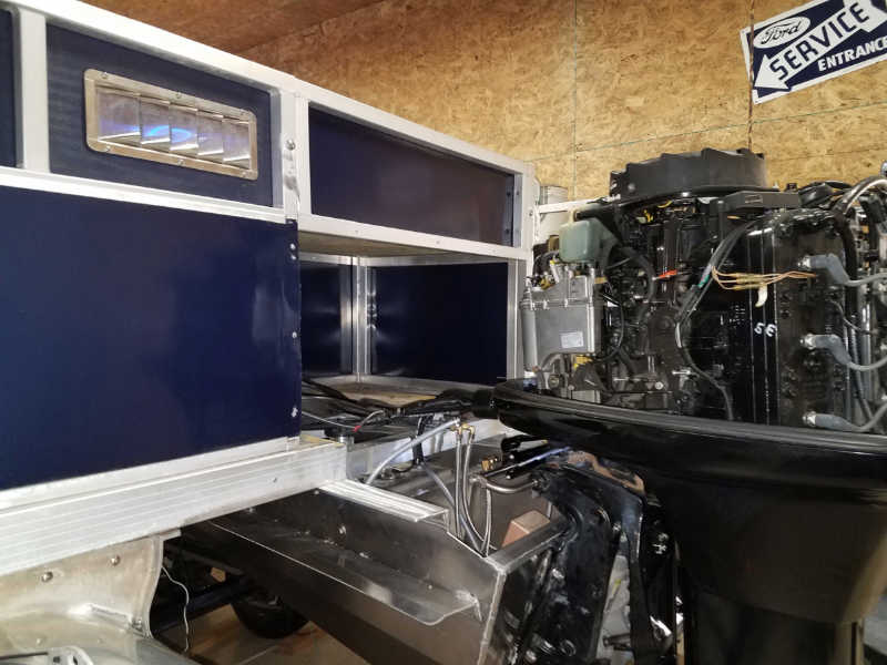

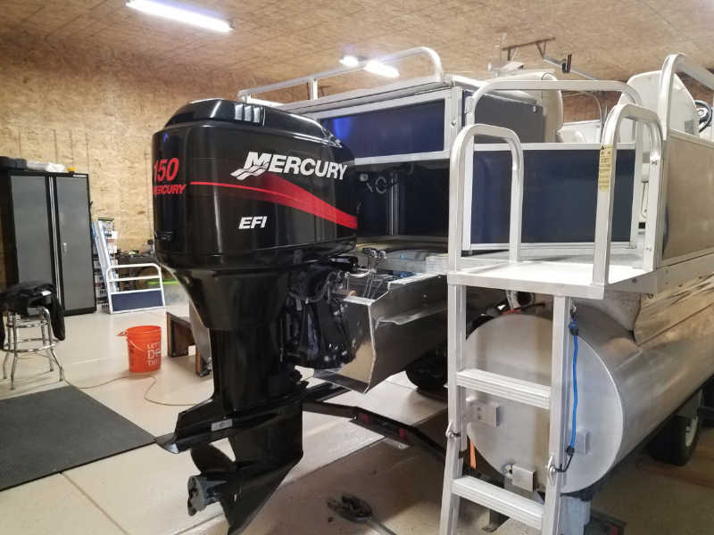

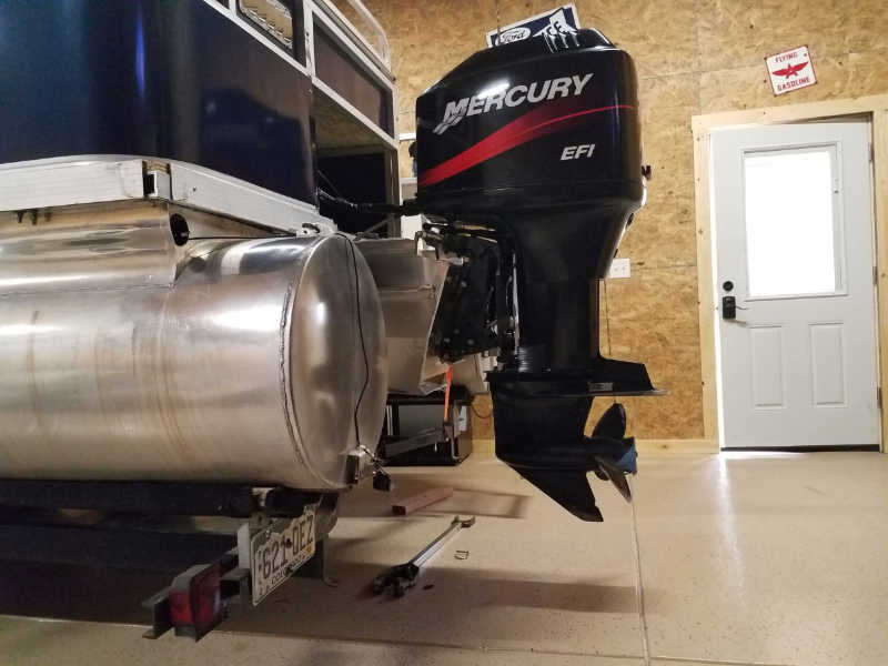

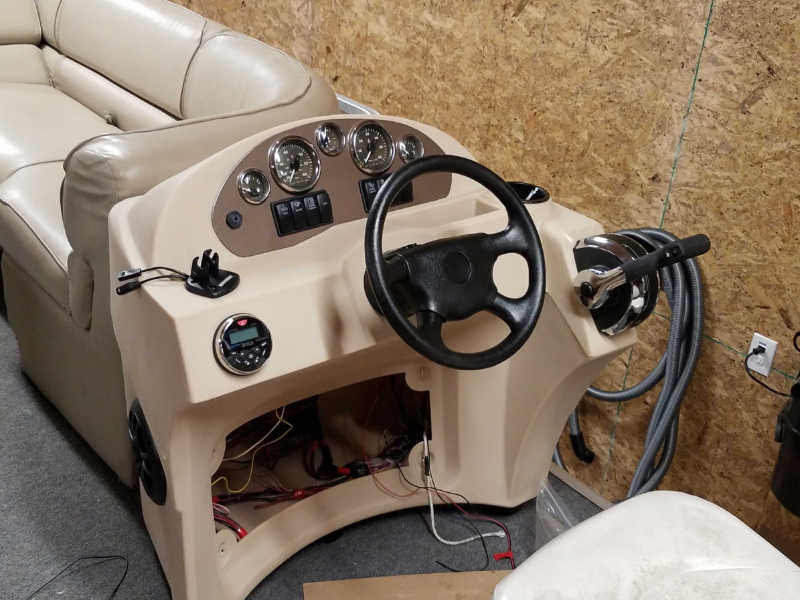

so summer is here and my project is back in the water
the upgrades include a 2001 mercury efi 150 (less than 100 hours on it), in place of the old i/0 that she came with, new hydraulic steering, new 300 hp transom fuel tank combo, dual batteries, new console gauges and switches, new decking and additional crossmembers, repaired the damage from the old owner trailering her without supporting the motor pod, new controls etc etc etc
had her in the water last week, she needs less prop and the motor needs to be lowered (already done and will retest next week)
i won't bore you with the dozens of photos i took but here are a few:
