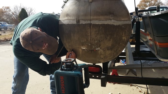

Using a laser level to make sure reference lines are in place
measure once.jpg (58.27 KiB) Viewed 9515 times
measure twice.jpg (102.73 KiB) Viewed 9513 times
looks good enough to start cutting
looks ready to cut.jpg (57.8 KiB) Viewed 9514 times

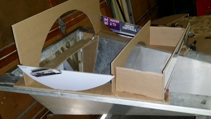

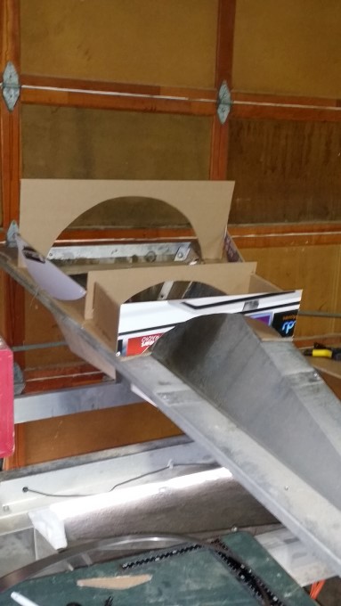

all the compound angles and round edges was too much, after drawing lines all over the log I decided to make a template to Triple check.
template of transom.jpg (51.83 KiB) Viewed 9516 times
you can see the transom in the back ground
template in the transom.jpg (73.24 KiB) Viewed 9518 times
The template needed to include the top of the cut
Template got a little bigger 1.jpg (76.54 KiB) Viewed 9516 times
Template got a little bigger 2.jpg (74.5 KiB) Viewed 9513 times

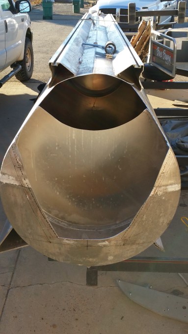

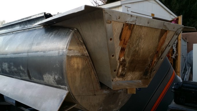

first cut, and found a surprise inside...a divider within about 12 inches of the back
center log showing its guts.jpg (95.66 KiB) Viewed 9510 times
side view of first cut.jpg (94.2 KiB) Viewed 9506 times
took it real slow, fitted/shaved a little, fitted/shaved a little
fitting the transom little by little.jpg (82.62 KiB) Viewed 9509 times

A couple of things to watch: The distance from the top of your transom to the bottom of your log. The standard would be +/- 20", or 25" if you like to run an XL shaft. You can always mod the transom top to get it down if needed, and while you're at it I suggest ditching the wood and rebuilding it out of 100% aluminum. You also need approx. 22" from the motor mount to the front of the motor well in order to let your motor tilt completely up to the lock. :thumbsup

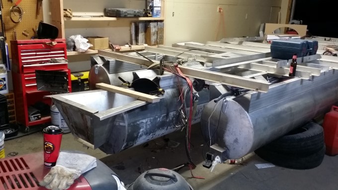

transome fitted (Custom).jpg (90.02 KiB) Viewed 9456 times

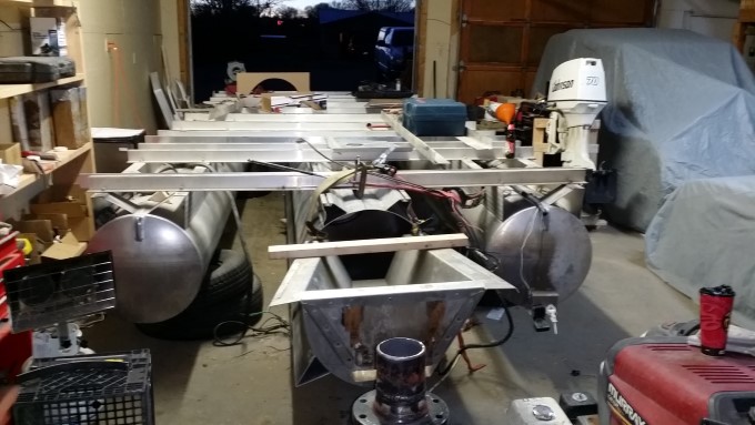

here is a pic of the third log on the boat temporarily (the 2X4 is holding the edges of the cut transom)
in the garage on the frame 1.jpg (100.92 KiB) Viewed 9451 times
in the garage on the frame 2.jpg (106.8 KiB) Viewed 9455 times

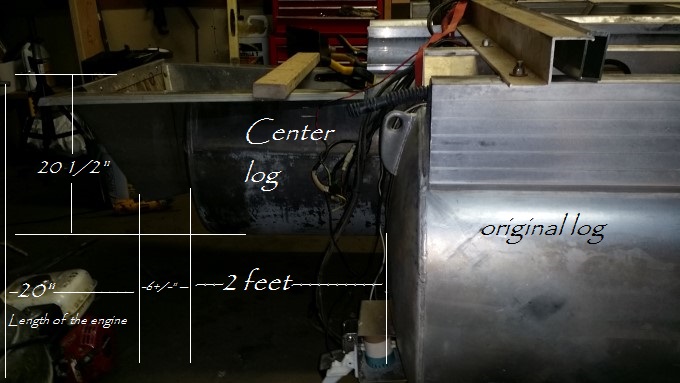

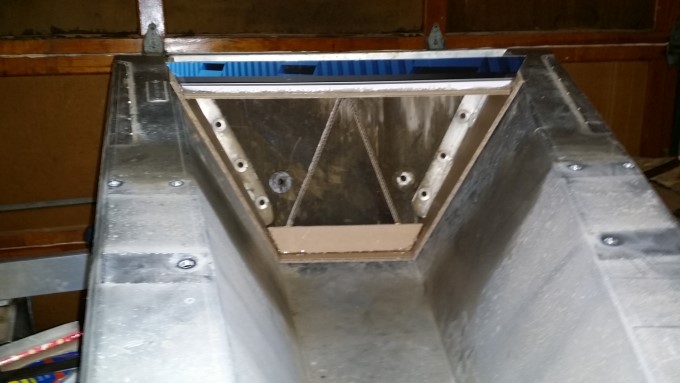

Here are some dimensions of the center log...seems way too long (sticks out too far out back). What do you think?
too big edited.jpg (83.29 KiB) Viewed 9454 times
sorry about the over sized image...cannot seem to edit it out. At least you can kind of see/get an idea of how tight I was able to fit it in.
Thanks for the comment Satt. And thank for the advice Toonguy! At first I thought about leaving the wood in the transom, or replacing it with more wood. However, I think I will take your advice and try to replace it with aluminum. Thanks a TON for the measurements, that helps more than you know in just re-assuring me that I didn't just ruin a log
My plan from here is to fit a piece of scrap aluminum (probably the "end cap" of the cut off center log) into the hole at front of transom and center log cut out. take the whole mess down to a machine shop to get a quote on bending up another strake. Then I can haul all the pieces to my welder and pray he doesn't freak out on the amount to be done.

#21 Post by ToonGuy » Tue Dec 02, 2014 12:25 pm
As far as your center tube sticking out the back, I see no major problems. Moving it forward of the outer logs in the front won't be a problem, as mentioned many manufactures do just that. You can gain even more room in the rear by many methods. Your stern doesn't have to be a straight line...use that center tube and some extra support and curve the rear out towards the middle. I've even had the machine shop fashion a "Z" shaped cross member with a 4" top lip, then hung the wood over another 3" to gain an extra 5-6" over the back. Be creative, it's been working well for ya so far!!! :biggrin2

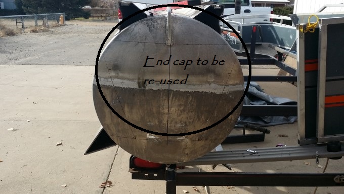

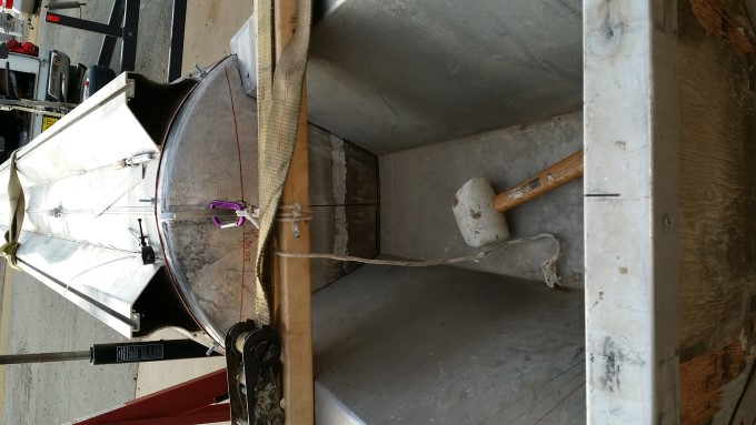

for anyone familiar with aluminum welding. Can I use aluminum pop rivets, to temporarily secure a couple pieces (end cap), without messing with the welding process? Can the welder weld the rivets in place?
Here I am again without a photo...I would like to be able to temporarily hold the "end cap" in place while I scribe the end of the transom, to get a a nice tight fit.
end cap.jpg (100.44 KiB) Viewed 9392 times
I am planning on re-using the end of the center log to fill the hole at the front of the transom
in the garage on the frame 1.jpg (102.04 KiB) Viewed 9388 times
those are the only pics I have on hand, I will try to get some better ones this evening so it makes more sense with the rivets.

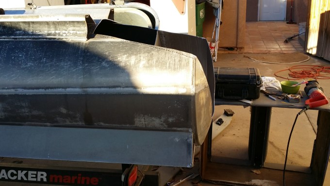

I have hit a bit of a lull, between work and personal life nothing significant has been done. I trimmed and fitted the transom and cap to be a little tighter. I have been searching for a reasonably priced welder. I took the pontoon down to a local fab. shop and they quoted me $600 to weld the transom in place, $400 to cut and bend a new strake and another $200 to weld the strake on. That is a bit to high for me. I am considering buying my own Tig welder and learning how to weld aluminum (I know what some of you will say...but I am always up for learning something new). Needless to say I am not in a huge rush on the rebuild. My deadline is end of April...for crappie fishing in may! Anyhow here are a few more pics (of the same that you have already seen) of where I am until I get things welded up.
2014-11-29 17.26.57 (Custom).jpg (106.8 KiB) Viewed 9262 times
2014-11-29 17.27.27 (Custom).jpg (74.72 KiB) Viewed 9268 times
I guess this is the latest pic
2014-12-08 16.12.56 (Custom).jpg (89.38 KiB) Viewed 9267 times
