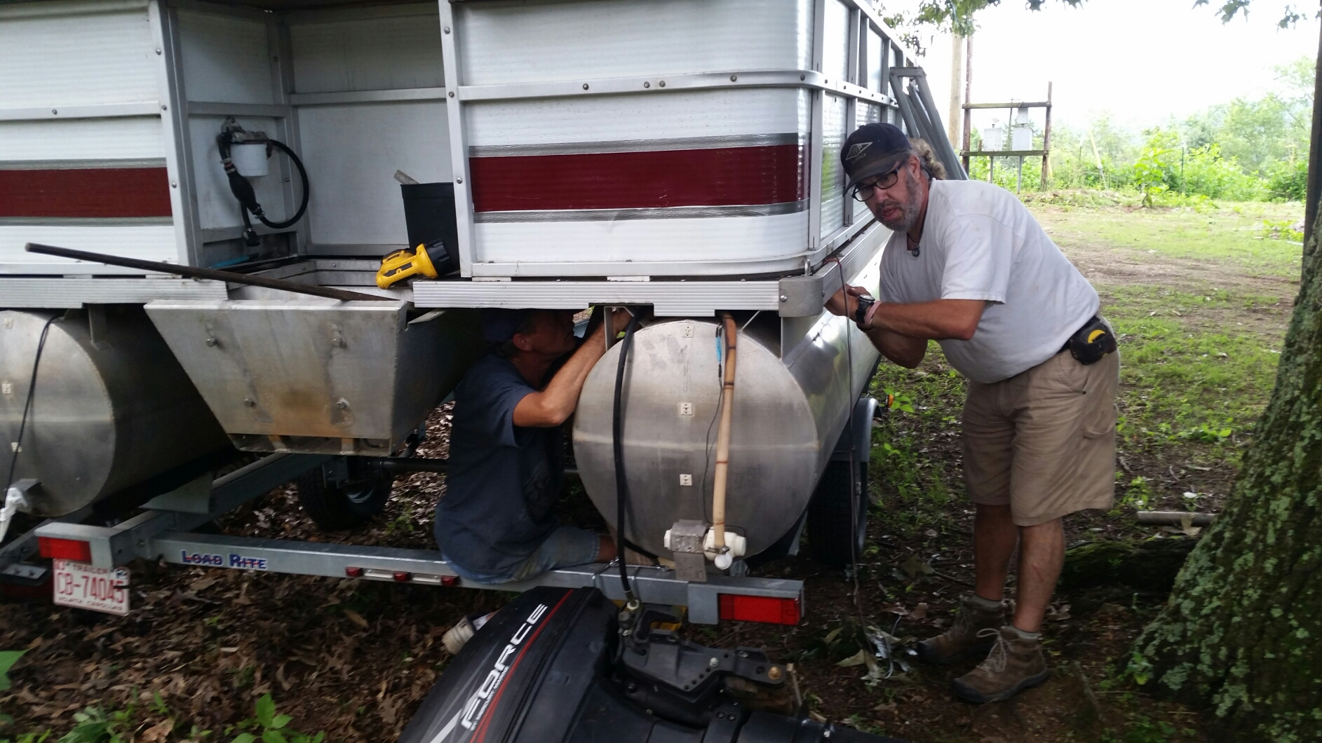

Removing the toons
2015-06-15 19.15.25.jpg (1.32 MiB) Viewed 8600 times

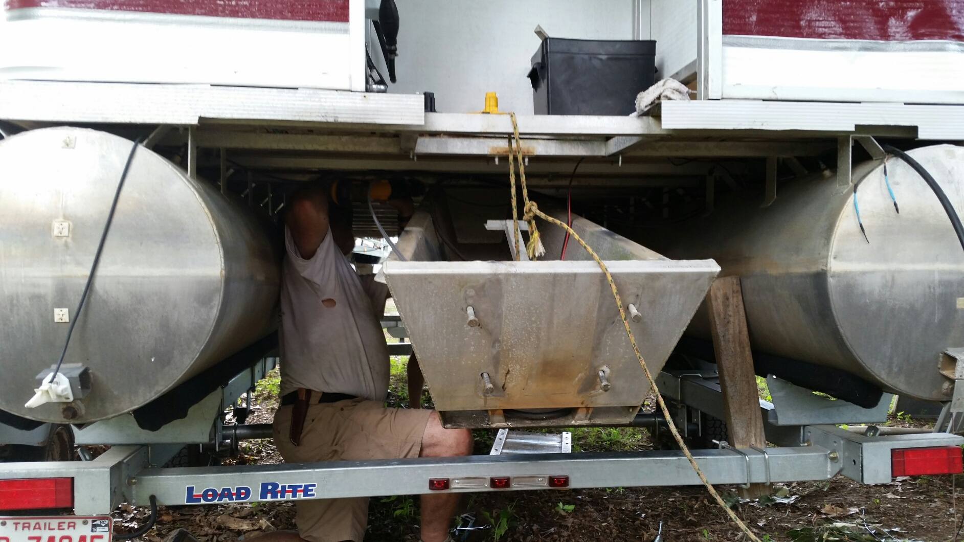

Removing transom
2015-06-15 19.14.54.jpg (1.25 MiB) Viewed 8590 times

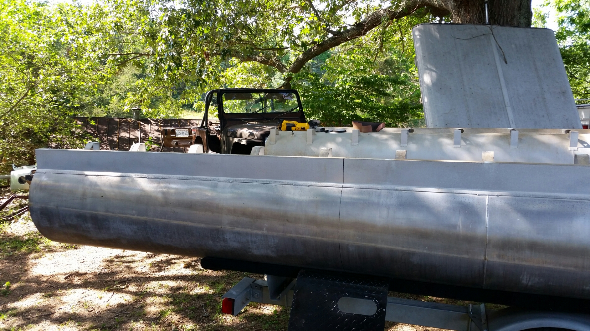

Marked to cut
2015-06-15 19.13.34.jpg (1.8 MiB) Viewed 8584 times

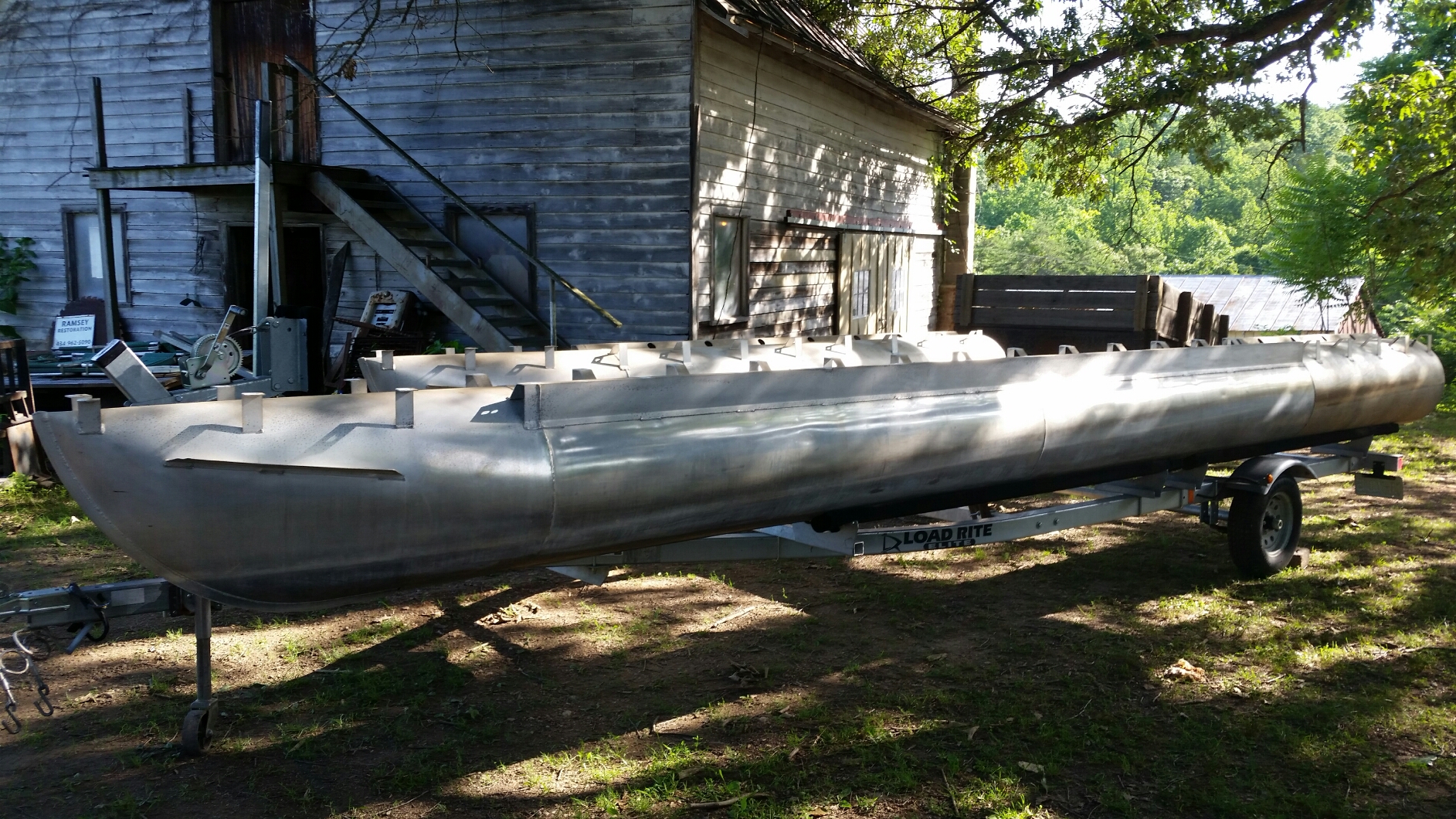

#26 Post by Luke » Mon Jun 15, 2015 5:17 pm
26' toon. Do you think thats going to be too long?
2015-06-15 19.12.42.jpg (1.78 MiB) Viewed 8578 times

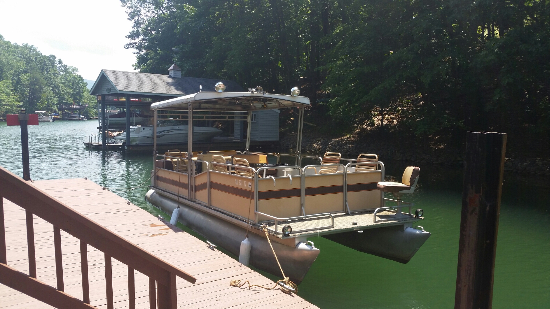

#29 Post by Luke » Wed Jun 17, 2015 1:06 pm
Fun-Toon just before taking her out of the water for upgrades
2015-06-17 15.36.04.jpg (1.42 MiB) Viewed 8478 times
ron nh
Posts: 979
Re: Fun-Toon
#30 Post by ron nh » Wed Jun 17, 2015 1:23 pm
The water is so clear it looks like its floating. well I guess it is floating but looks like its in air.
