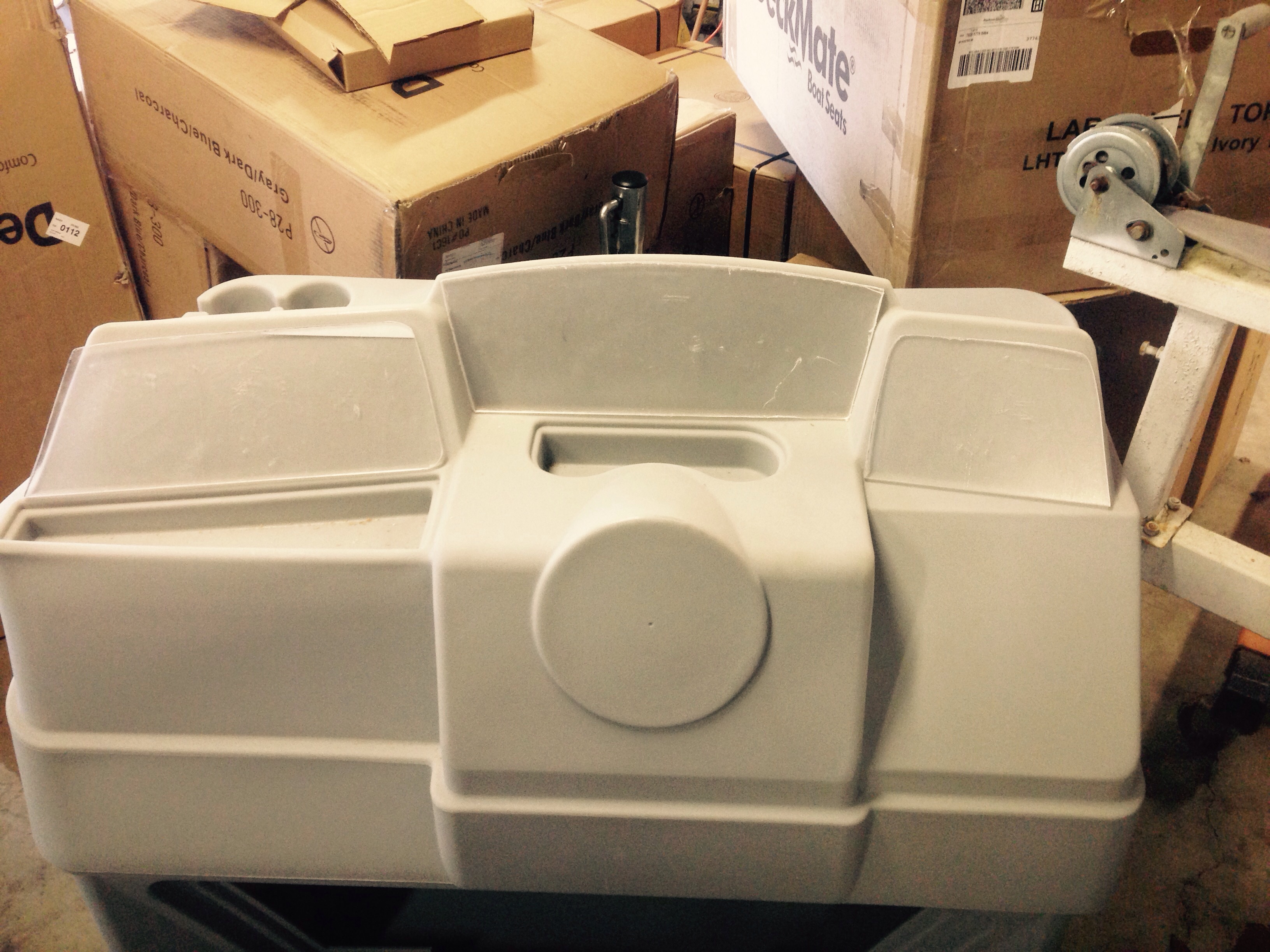

Re: New toon build
I did alittle work on the helm today.

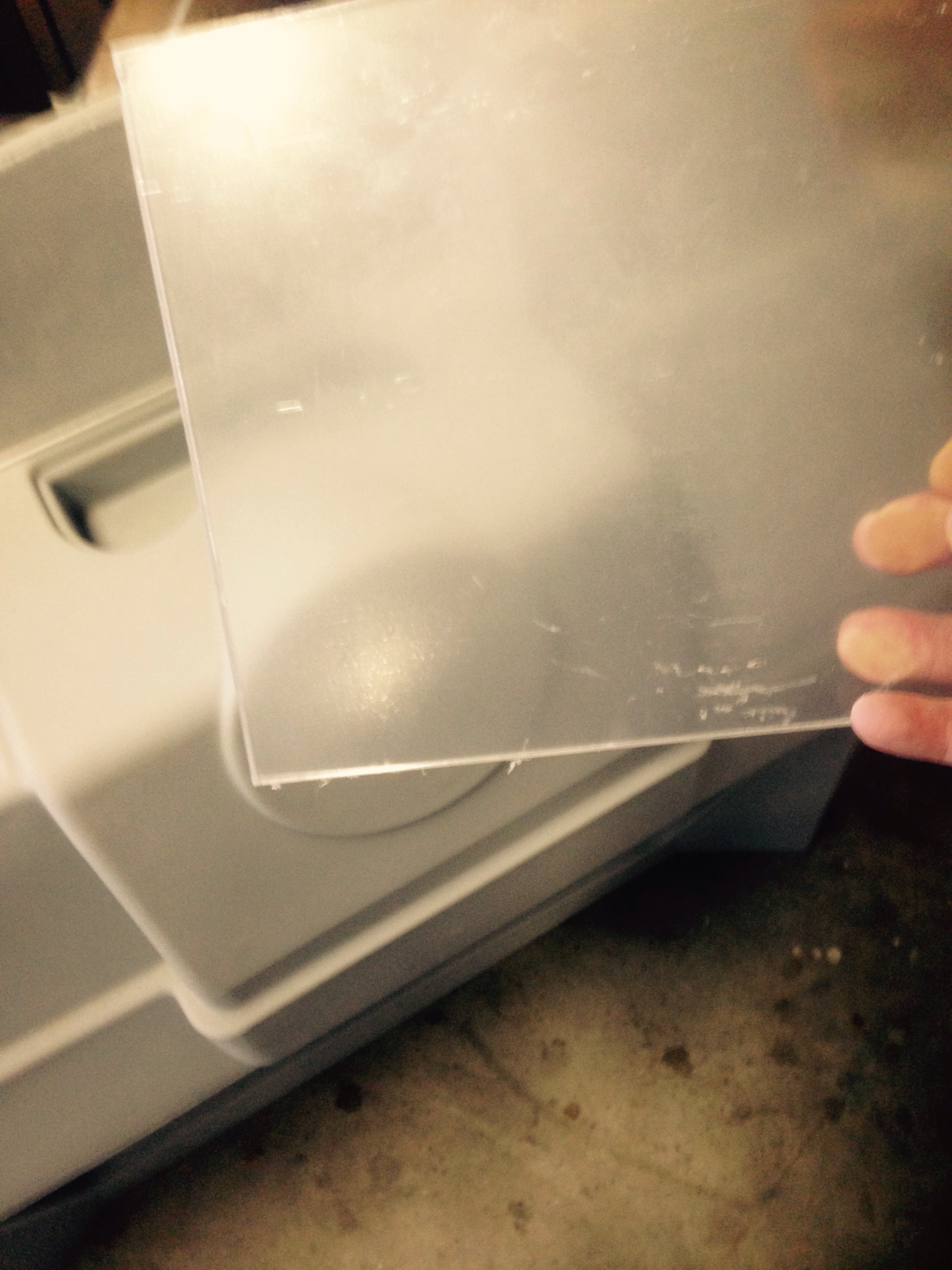

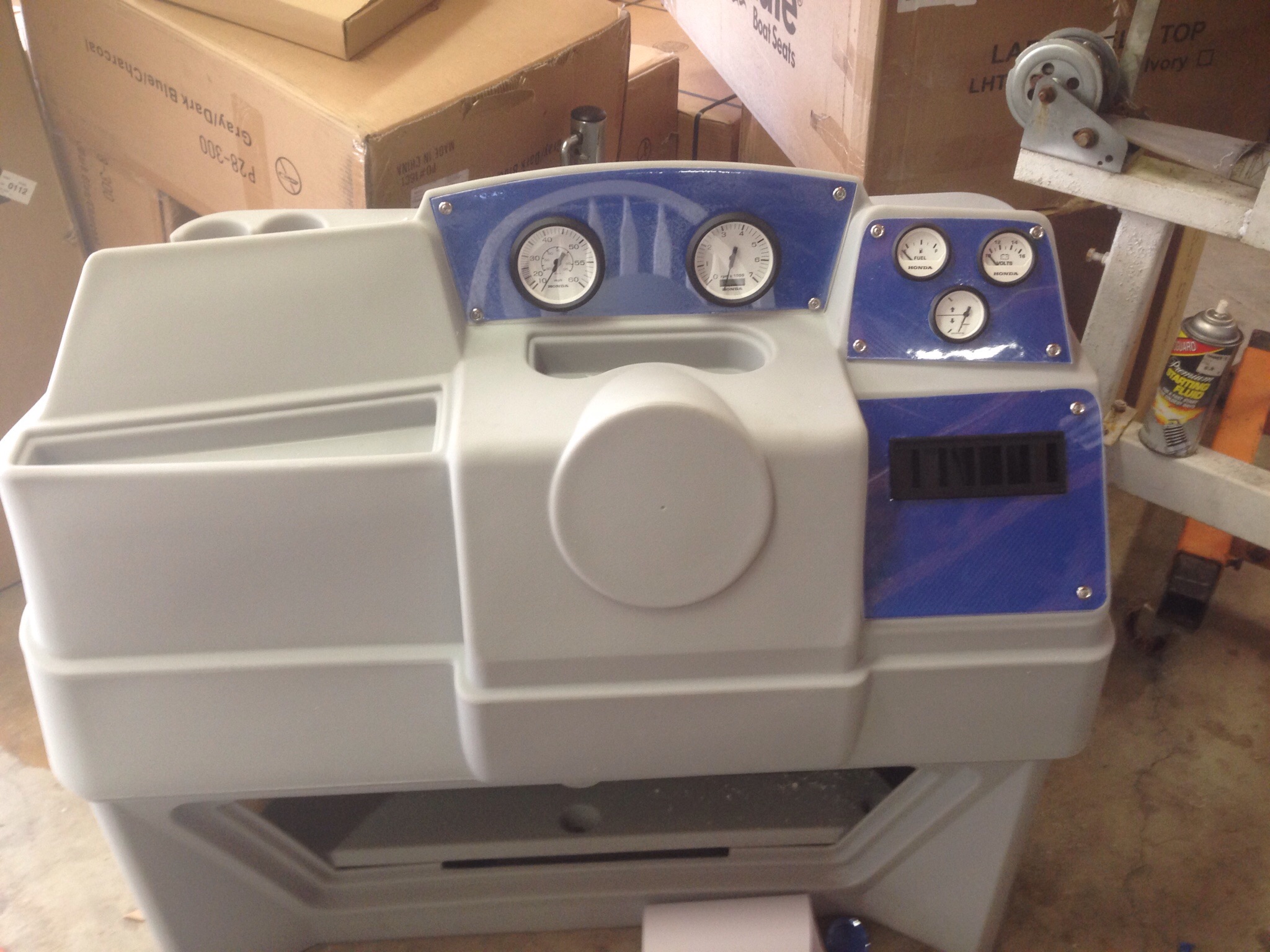

Re: New toon build
Vinyl wrap and plexiglass

Re: New toon build
Have you mounted the steering assembly yet? I'm using the same console in my re-build right now. I had to put spacers behind the bracket that holds the teleflex steering cable because the cup holders were in the way. Then the smidt steering wheel I bought wouldn't fit the 3/4" taper. Just curious if you'd tackled that yet.
