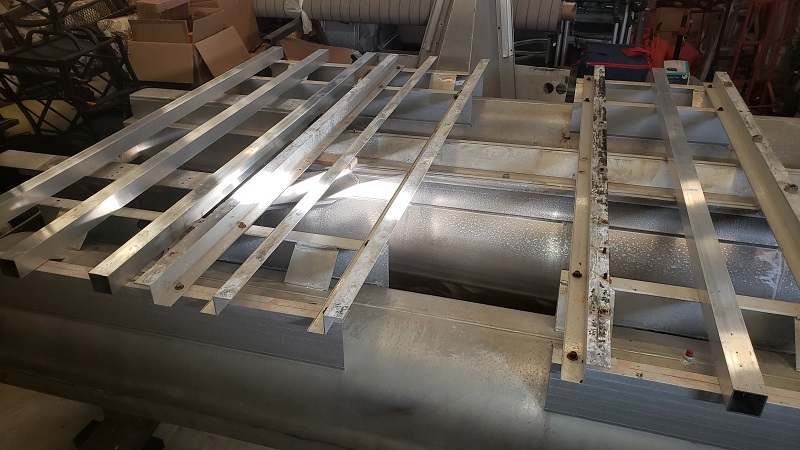

So I've decided to add some more 2-1/2" box tubing to the entire boat. The current Z-bars are on 24" centers, So I think to add a little more comfort...at least in my mind
...I will add a box tube in between each of the crossbeam sets. Lake St. Clair here in Michigan can get pretty rough and ruthless. In total 8 box tubes, 3 in the back by the motor pod and the other 5 will fill the spacing between the rest of crossbeams. What do you all think?

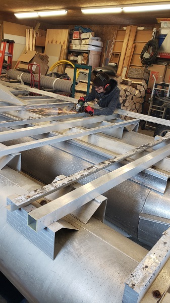

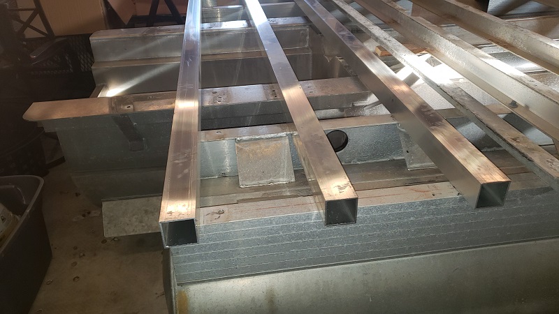

Ok...so I got my extra box tubes layed out in the rear and across the rest of boat. In the rear transom area, I will have the box tubing on 12" centers to match the original z-bars spacing, which was 12". I then added an additional 5 bars, to fill the rest of the crossbeam sets. Now I have to get the center tube as perfectly lined up as possible and begin laying out all my drill hole locations. I think while I have it down to a skeleton, I may replace all the OE carriage bolts that hold the toons onto the crossbeams. They are corroded real bad.

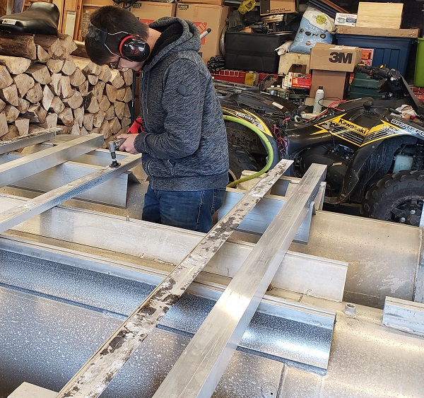

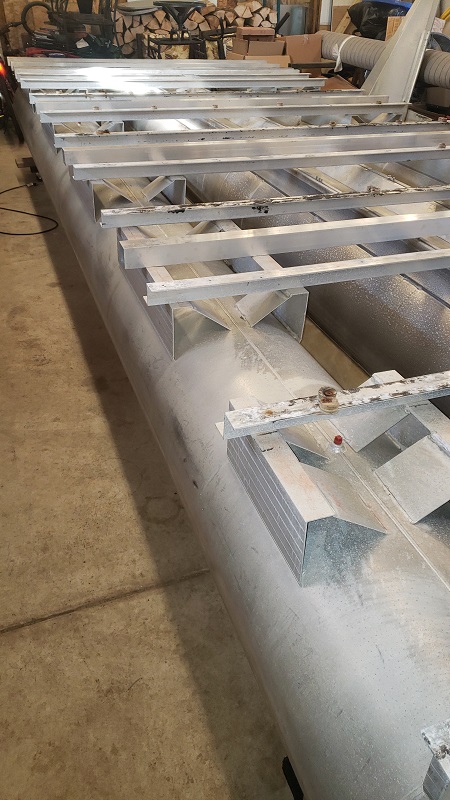

Haven't made too much headway with the boat...had my best helper (my son) grind all the rotted screws down and metal finish. I got some aluminum sheared and bent to make lifting strakes on the inboard side of the outer toons. I will TIG weld those on in the next few weeks. We also bought new 316 stainless hardware, to replace all the old rusty originals.
Covid has put a damper on progress...Hope everyone is staying safe.

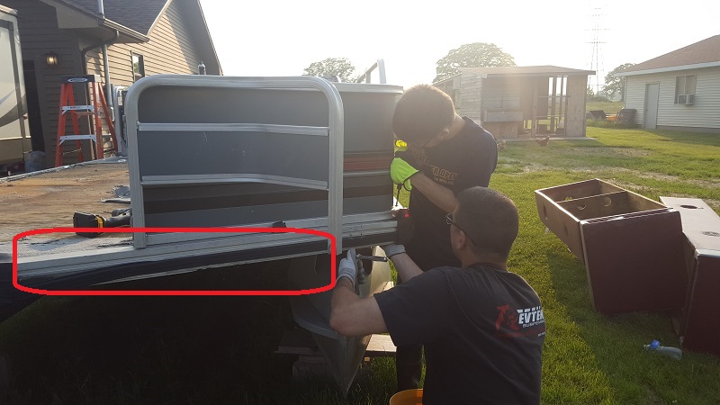

The rubber trim circled in the picture:
What is that called? I have been searching for this and cannot find it. I have a 95 Party Barge 21 and the trim is gone. I have found all kinds of rubber trim online but none of them are what I need.

I've always heard that called the Rub Rail. Who knows whether or not that's right!onlybillhere wrote: ↑Fri May 08, 2020 7:21 amThe rubber trim circled in the picture:
