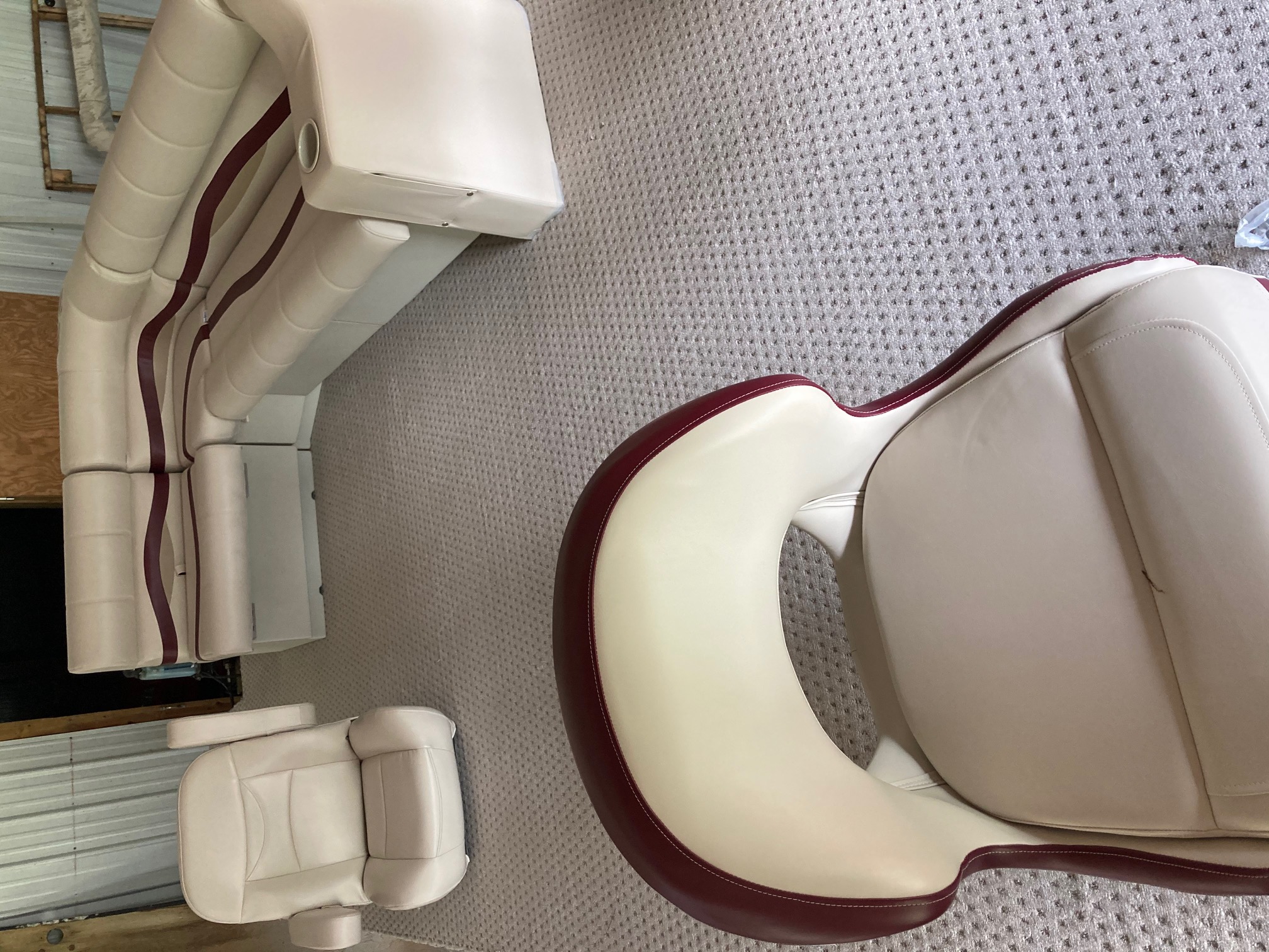

Not installed just a glimmer of where we are going with this.
My take on the furniture:
Captains chair: I'm not a bucket seat guy (don't like the sides squeezing legs) and the captains chair is definitely a bucket seat. Seat is not firm. Frame is metal not rotomold. I do like the arm rest and the higher back of the captain's chairs. If this chair had the seat cushion of the other red and ivory chair it would be a 10. rating 8/10 on expectation.
The red and ivory chair is a flat cushion with a very firm feel. If this chair had an arm rest option and little higher back it would be a 10. (overall I like this chair slightly more than the captains chair) rating 9/10 on expectation.
I still have not decided if I had it to do over again would I get all three chairs being the Ivory and red without arms rests though I have toyed with the idea of calling and seeing if they would swap out.
so far all furniture being deckmate seems well built, vinyl feels good. My one suggestion would be to stick the deck mate label somewhere a little less prominent. I'm faced with having to cut it off (defeats your purpose). I'm impressed with the fit of the individual couch pieces as 1 unit everything looks like it fits right nothing out of place or odd shaped. I say that because when shopping the various brands I did see some furniture lines that when it was all put together I thought well that doesn't look like those two pieces fit correctly together. Maybe it was installer error.
- IMG_2720.jpg (826.86 KiB) Viewed 62670 times
- IMG_2719.jpg (817.74 KiB) Viewed 62670 times
