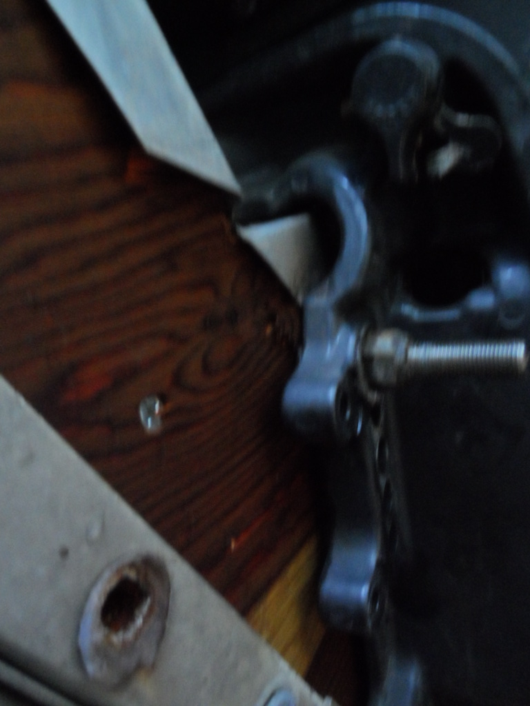

One more thing, the transom wood is a little tired and will get replaced this winter. Any reason not to use two pieces of 3/4" or one 1.5" section of HDPE for it instead of 1.5" Ply?

I'm surprised these older boats had wood transoms. Wouldn't it be better to replace the wood with steel or aluminum and not have to worry about future rot?
Re: 33 year old 28' Party Hut restoration
It's possible to use Al, but for me it will be easier to slap another board in there. I'm not sure HDPE can take the stress a 115 will put on it, safer to go back to proper thickness ply & will last another 30+ years.
Oh, and another tip to get the plywood nice and tight since it's hard to re-position over the self stick caulking strips. Bolt down the first sheet, then get all the others up there and lined up. Use a ratchet strap(mine was 30' long, but you can use two or three shorter ones) hook it behind the first board and to the front of the last, then tighten the strap. It does not take much to pull them together just make sure the boards stay even so run the strap down the middle.

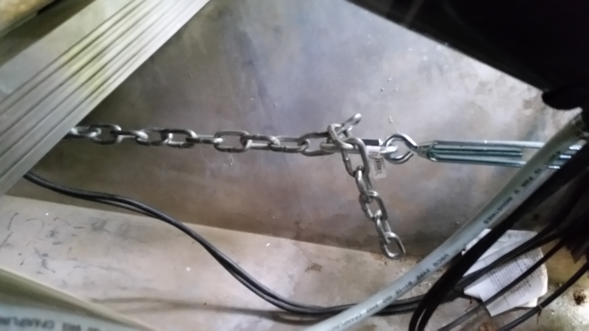

I 2-plyed my transom on the rebuild. But I added a Transom safety chain after my rebuild.... Steel plate on outside of Transom with an eye bolt on inside of transom then shackled to a chain with a turnbuckle which is then shackled to another eyebolt attached to crossbeam,
Can't be too safe! I don't have great pics but it does the trick! After the first replacement cracked on first day I wanted some more support back there.
- 20150523_120647.jpg (555.59 KiB) Viewed 70531 times
Curtis, that is an interesting solution. Why is your transom so weak it cracked the new ply? Was the original ply cracked too?

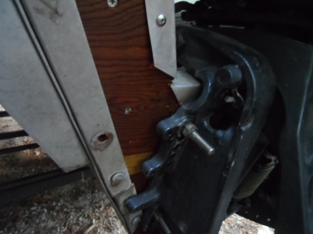

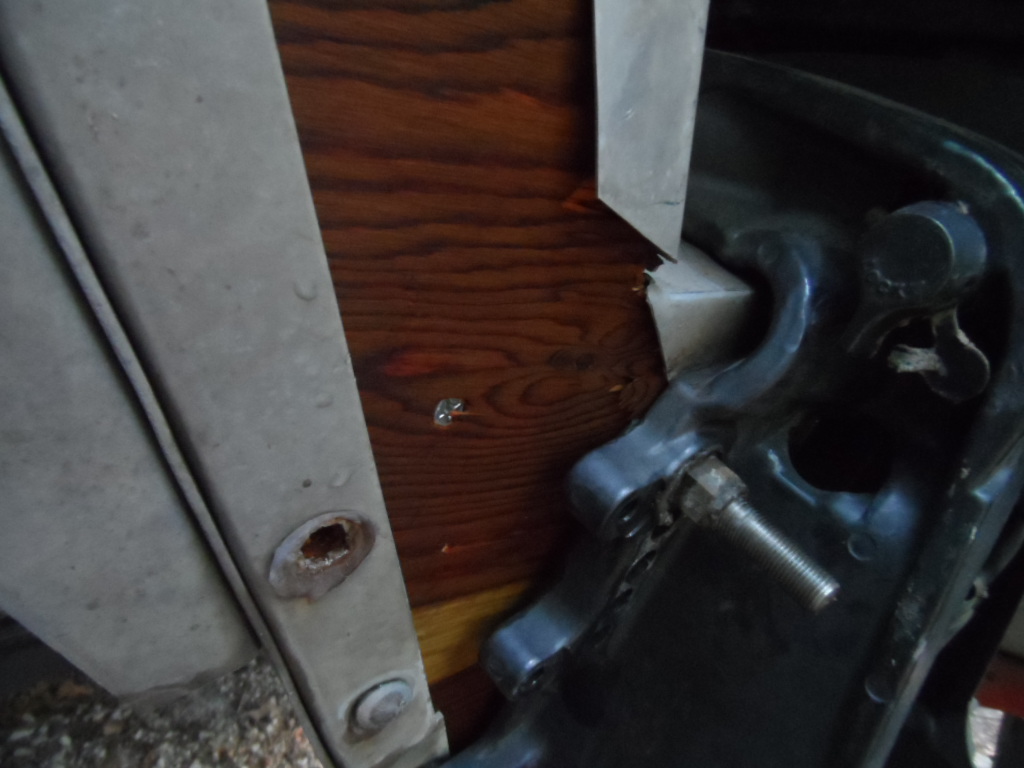

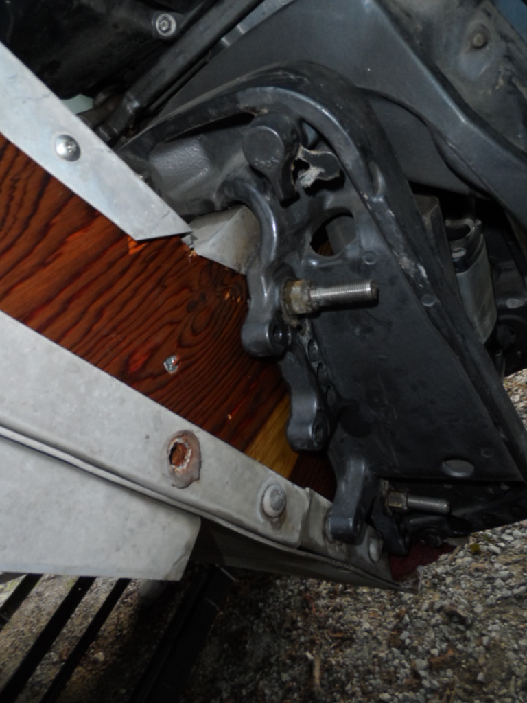

It was a bad sheet and I missed it. Me and 3 guys Replaced it in the dark to get it ready for the next day...
