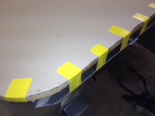

sunedog wrote:Herb -- You're rebuild is looking great.
I bought the same Alpha vinyl kit from pontoonstuff and will be laying it down tomorrow afternoon. How did that part of your project go? Was it easier or more difficult than you expected? Any last minute tips you can give me? Thanks for posting the pictures of doing your floor. I know a little more what to expect now. Thanks.
Have a roll of masking tape handy, you will want to tape it down all around the edges. Use a GOOD roller. Just like rolling linno, you can't skimp. You need some thing heavy yet narrow,
