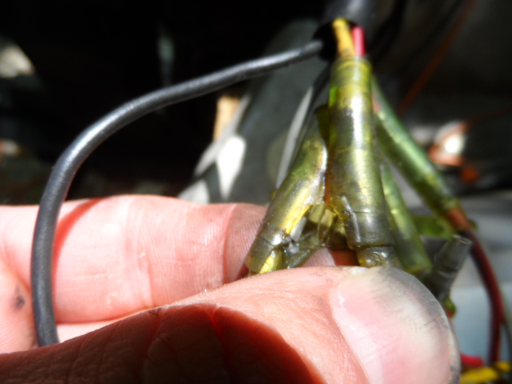

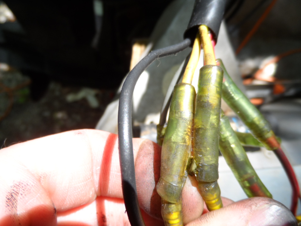

I started unhooking the REgulator and noticed two of its wires were melted together... Damn these barrell connectors suck!

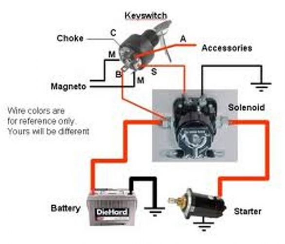

#156 Post by tuned » Thu May 30, 2013 11:29 am

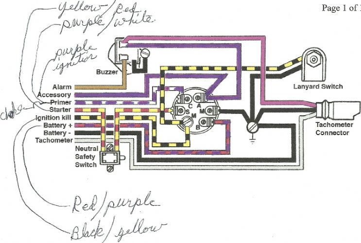

Hmmm. Looks like fun. This is the type of thing that I have to stare at for awhile, and I am on the run today. I will try to get back on this later tonight at earliest. I assume that the second diagram is what you are working with. Is the bottom photo your actual switch?
Shooting from the hip, I would take all wires off and try to verify them one at a time. Lots of work.
Find the full time hot wire.
Verify the ground wire.
Then start jumping hot or ground to verify the rest of them.
Instinctively, you are likely on the right path with the keyswitch itself.

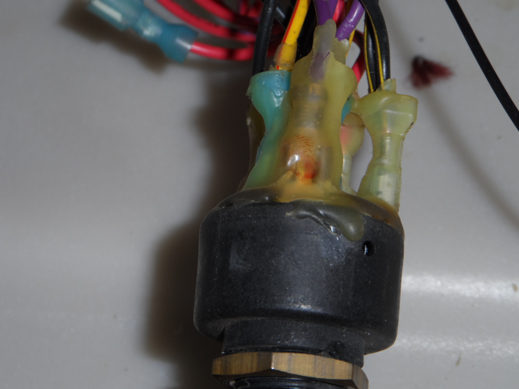

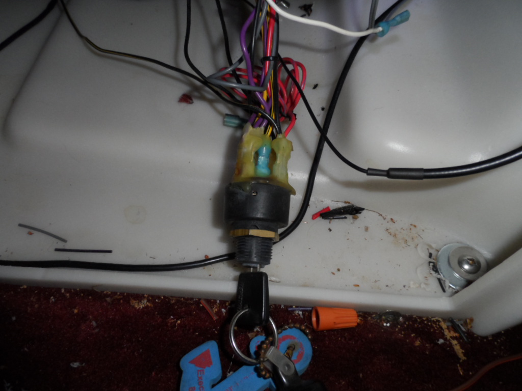

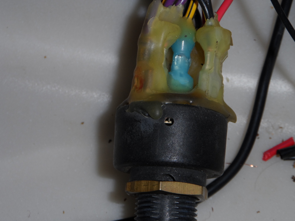

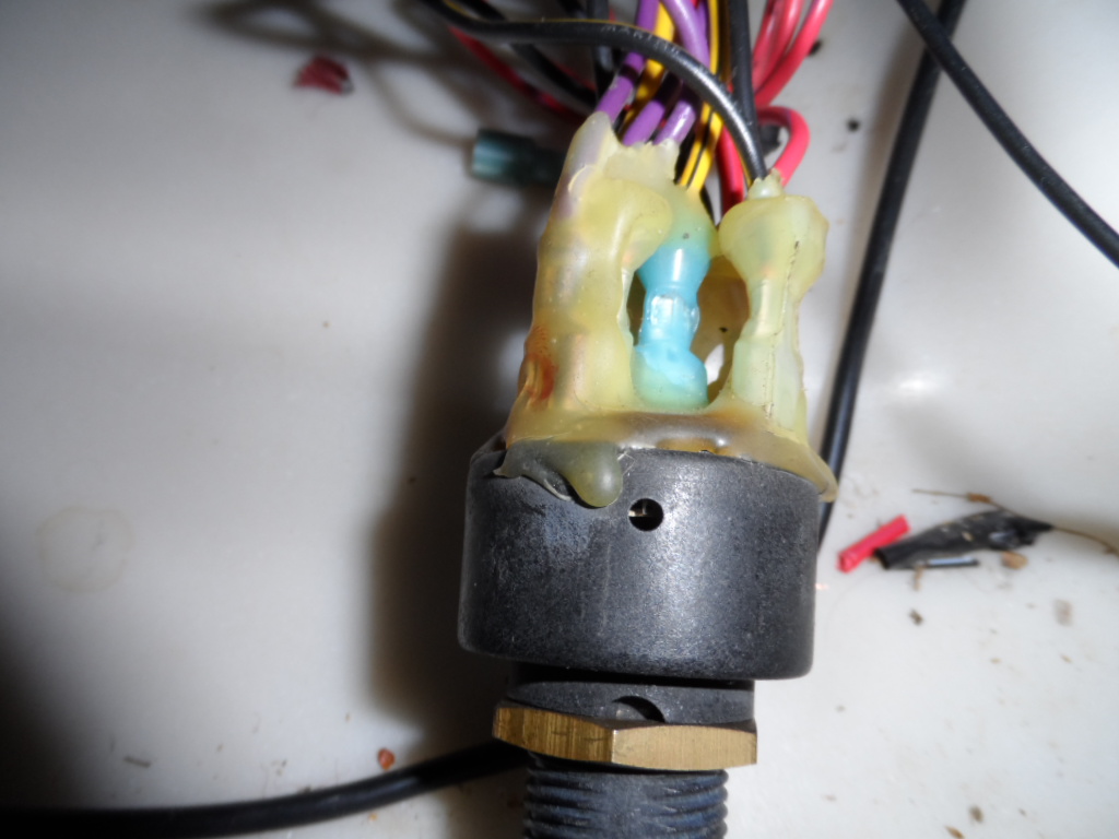

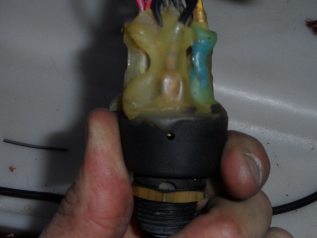

#157 Post by curtiscapk » Thu May 30, 2013 11:33 am
This is my burnt switch... The 2nd and 3rd pics are the old Regulator connectors.
#158 Post by curtiscapk » Thu May 30, 2013 12:13 pm
MOre pages from manual
Full wiring diagram
Switch
controller which was a little different than pictured as tilt and trim\ ignition switch was on dash and on\off switch was hidden behind controller on the old console.

#159 Post by tuned » Thu May 30, 2013 6:49 pm
Yep, you got some complexity to deal with there. When I get into something like this, I always try to simplify to one section at a time and verify each one. Starting 'in the middle' will eliminate whole halfs at a time. Whatever is left over is usually the problem.
Since your keyswitch is suspect, that is certainly a good spot to start. You should be able to make that engine run and do it consistently without the key in the picture.
The attachment labeled 'Key/chokeswitch continuity test' looks like a nice simplified diagram. The others are a bit small for my old eyes to focus on.
I would take all wires off.
Verify B+ on your red/purple
It looks like you might have a 'switched ground' heading to your coil (mine is switched hot). You need to carefully check your schematic to verify this before testing. If this is the case, you should be able to jump ground to your Black/Yellow 'ignition kill' wire. There is a lanyard switch that is part of this circuit, so try to jump 'downstream' of it in order to eliminate it from your test. Leave these connected when trying to start the motor
Touch B+ to your white/purple choke wire and it should click.
Touch B+ to your Yellow/red and starter should crank. Neutral safety switch is part of this circuit, so try to jump past it. Using your choke wire as well, you should be able to start and run the motor.
Isn't this fun?
Your tach and/or trim issues should have nothing to do with runability, although they do provide an important clue that makes both of us suspicious of your keyswitch.
At the risk of offending, another clue that would make me suspicious of an area is that all the wiring was pulled and reinstalled recently. It would make me consider the possibility of the wires being hooked up wrong.
The simple jump tests should tell you many things. Please take the time or ask the questions before messing with that 'ignition kill circuit' as I am unfamiliar with how it works and would hate to be responsible for bad advice. The rest should be pretty straight up. Good luck, bring plenty of beer.
