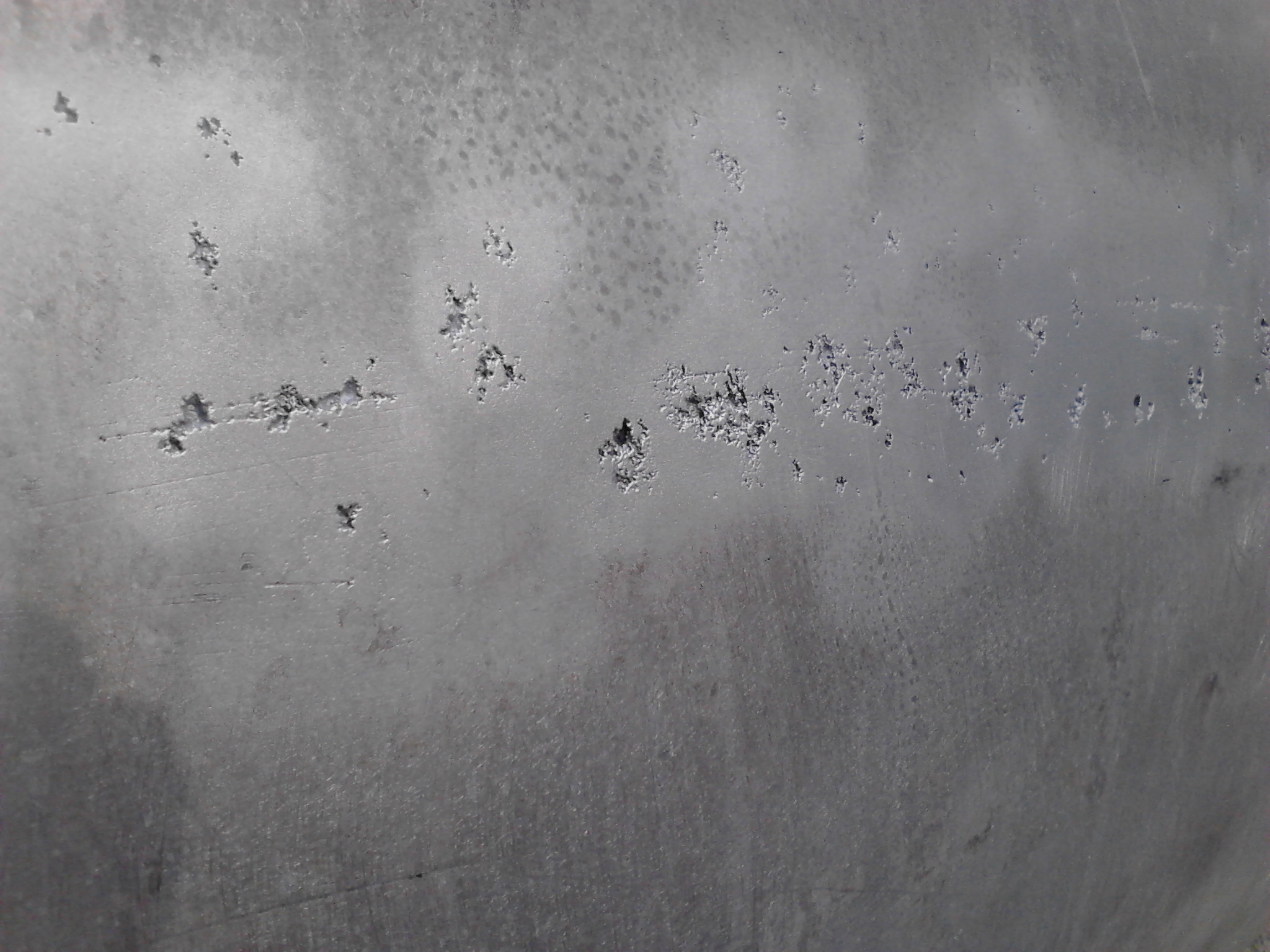

All the corrosion has been sand blasted. Ready for acetone and marine tex gray. Sorry to be slack on the pics.

Re: How to fix pitting on your logs.
Now time to clean and apply marine tex. I tried to get all the angles I could with the spot blaster. Man, I love that thing...takes barnicles, old paint and corrosioon off like nothing.

- Posts: 5446
wow that is ugly!!!
They look clean as hell though! Good luck getting them sealed!
+1! My face didn't even look that bad when I was a teencurtiscapk wrote:wow that is ugly!!!
Hopefully you can solve the original problem that created this mess in the first place.
Good luck to ya. The MarineTex is great stuff.

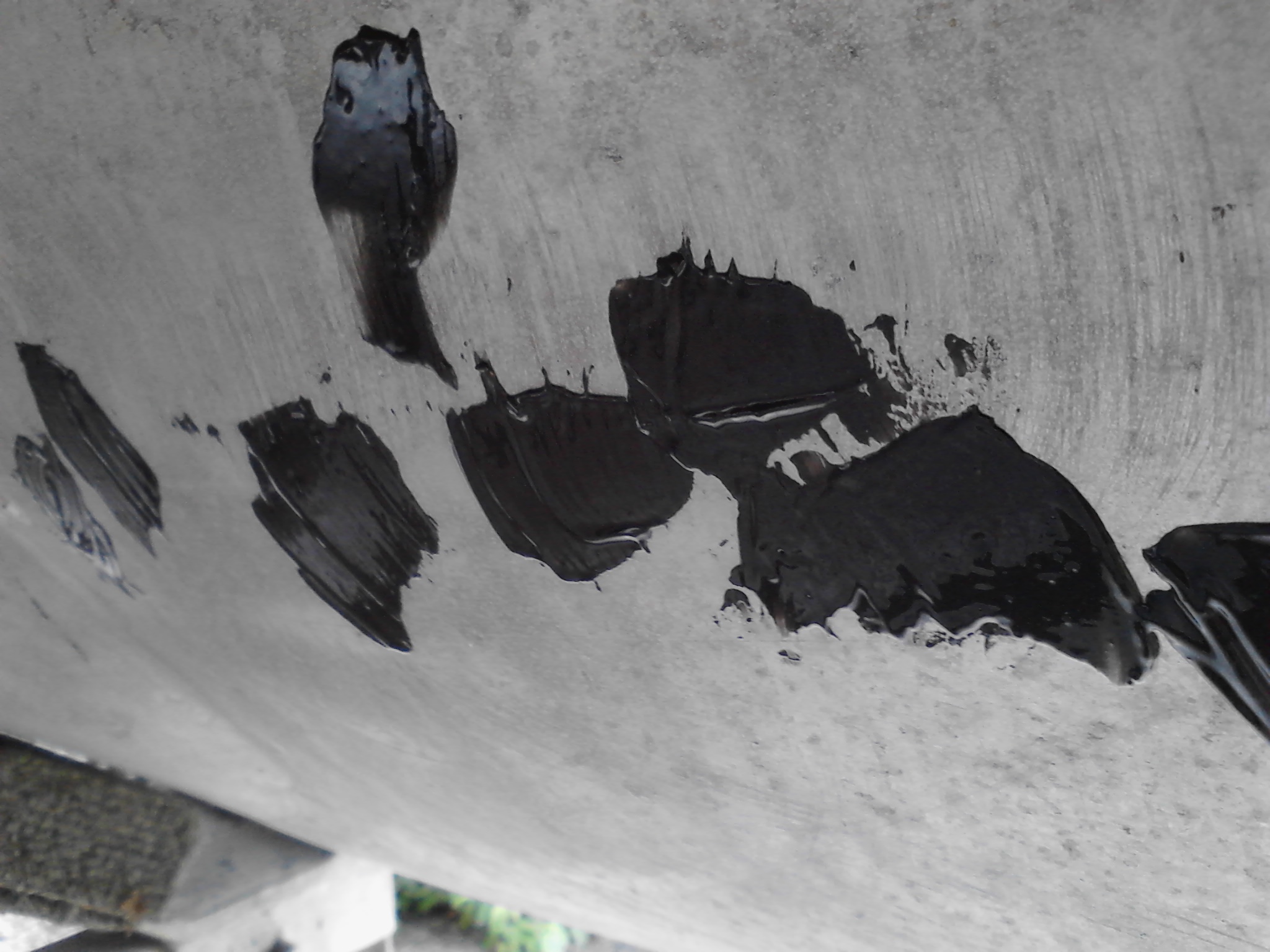

I went with marine_tex because I can get back on the water before further sealing with interlux 2000e and a few coats of trilux 33.

- emerald_coast_tooner
- Posts: 29
- Joined: Mon Aug 05, 2013 3:36 am
- Location: Cantonment, FL
Sorry for the poster size pics from my phone. Whoa!
Well its sealed up. Its ugly but it will float now.
