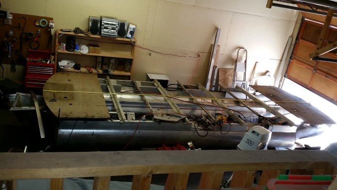

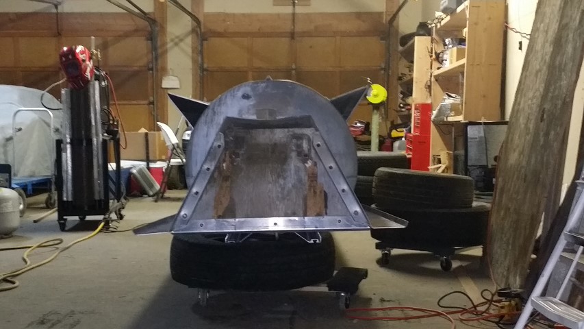

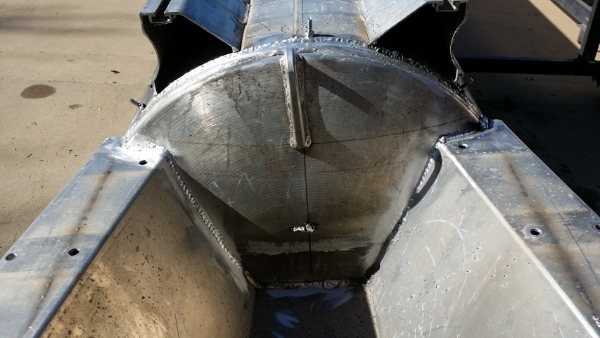

To bring you guys up to speed on my build. I finally picked up the third log from the welder. I have been positioning it on the boat trying to finalize the overall length. I think she will end up being 21' 6". Thanks again Toonguy for the push to think "outside" the box.

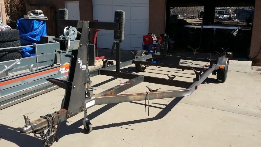

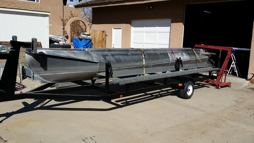

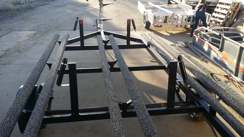

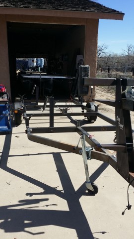

I need to take the center tube to the fab. shop to have them bend up a strake. Instead of putting the center tube on the side bunk, I modified the trailer for the center tube. I loaded the boat back on the trailer, took some measurements, removed the trailer and made the modifications (four bunk brackets, moved the "boat stop" and replaced all the bunks).

Ready for the fab shop!

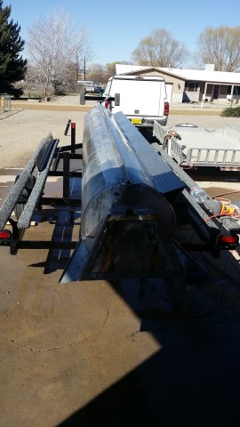

I picked up the strake from the fab shop. Spent yesterday welding it on and managed to (find a weak point) break my tig torch. The center pontoon is 98% complete. New tig torch on the way, need to pressure test the log, and plug any pin holes I find. By the way, I think I mentioned that all the bids I received on aluminum welding ended up being between 90-100 buck/hour, total for everything was over $1500.00. So, I bought a tig welder and started practicing. I figured for the same price of paying someone to weld it, I could buy my own and have something to show for it (satisfaction of doing it and a tig welder)...even if my welds are not "pretty". I will post some pictures tomorrow.

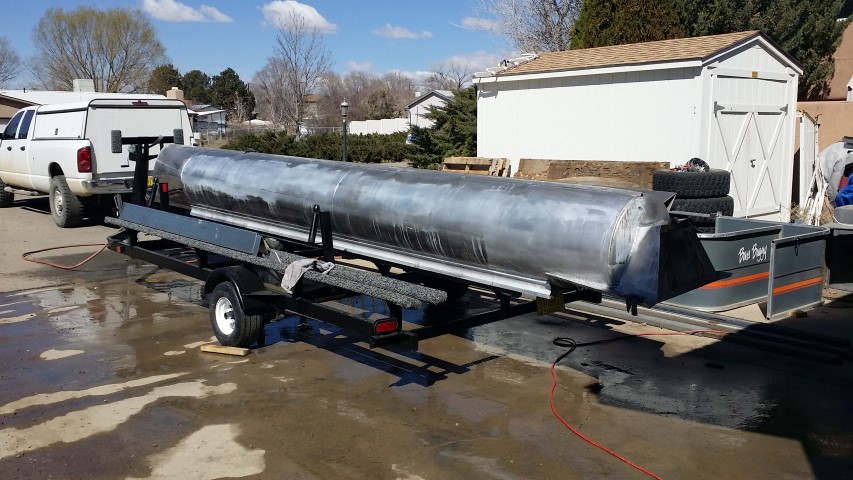

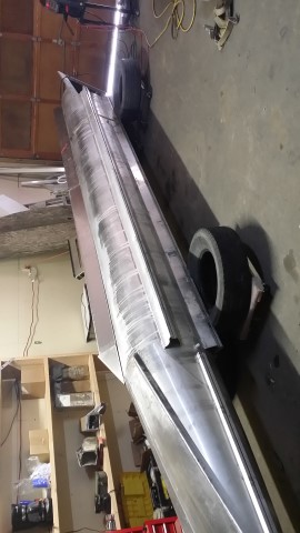

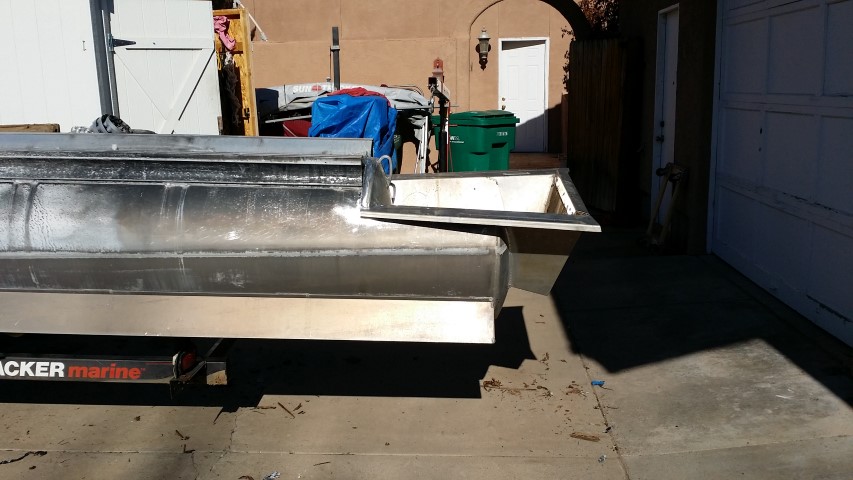

You can see the new strake on the left trailer bunk. They made them out of two eight foot pieces and a one foot end cap.

I used "toon bright" to clean up the side I was going to be working on (I would have cleaned the entire log, but I was low on acid)
2015-03-14 11.54.13.jpg (163.6 KiB) Viewed 8885 times

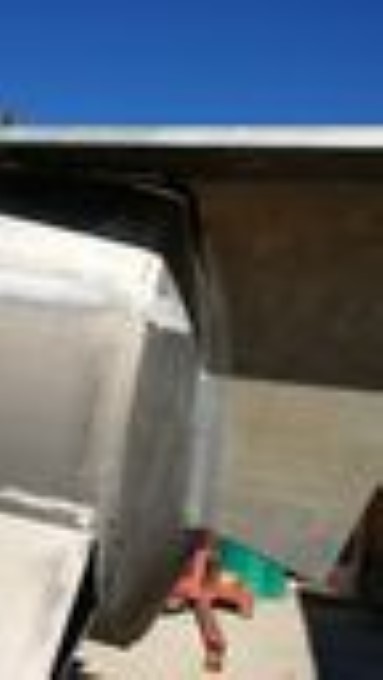

double checking the placement, used ratchet straps to keep it in place while I tacked it on
2015-03-14 16.01.56.jpg (43.66 KiB) Viewed 8887 times

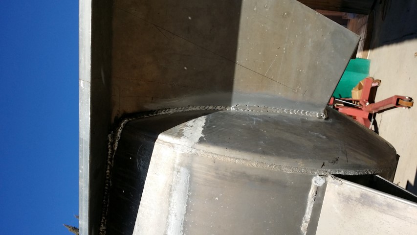

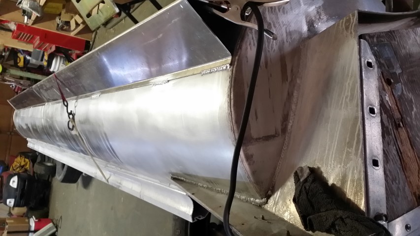

I tried to follow the same "pattern" as the factory strake...as far as where I welded it
2015-03-14 16.01.17.jpg (99.46 KiB) Viewed 8886 times
just a cool picture
2015-03-15 19.58.13.jpg (85.04 KiB) Viewed 8885 times

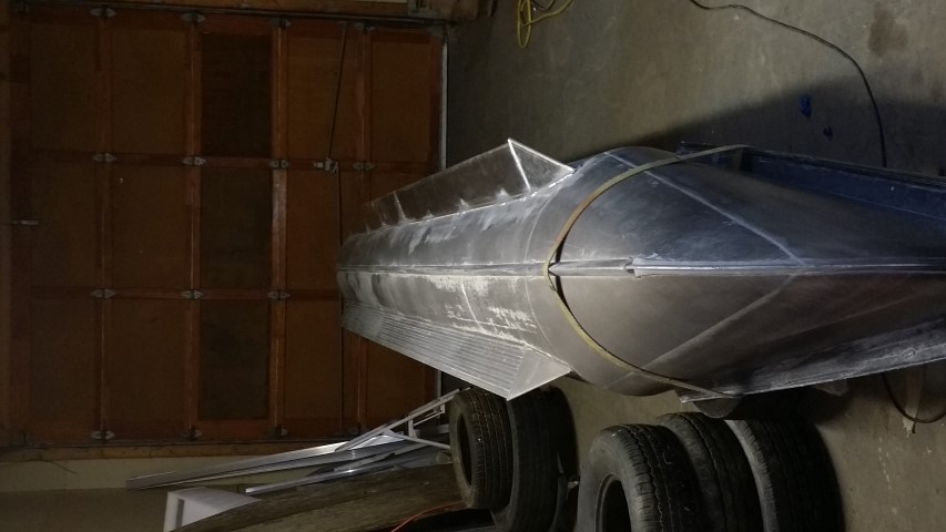

and from the backside
2015-03-15 19.59.57.jpg (121.7 KiB) Viewed 8885 times

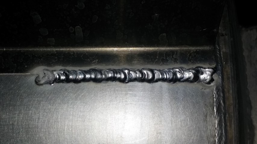

pretty proud of myself learning to weld aluminum, not to shabby for a beginner
2015-03-15 19.59.22.jpg (106.06 KiB) Viewed 8882 times

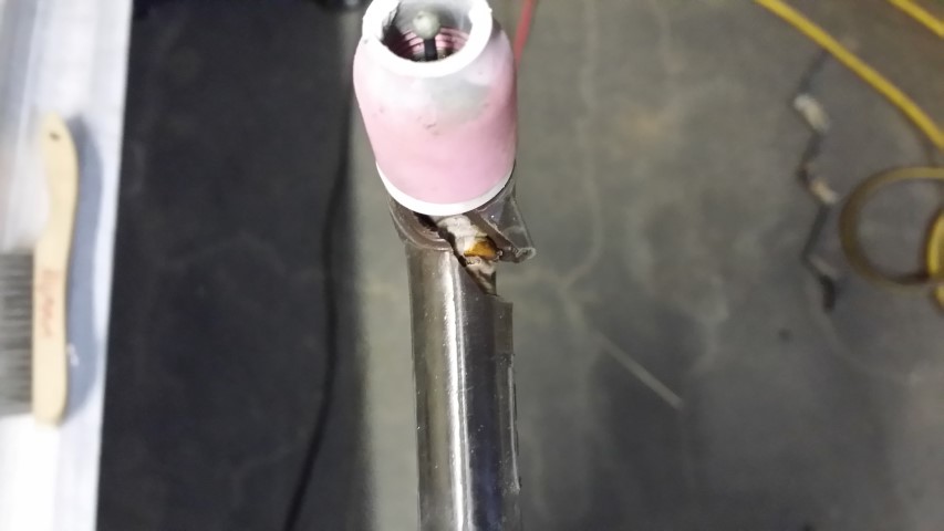

Here is what put the stop to the progress this weekend, hopefully the new one comes soon.
