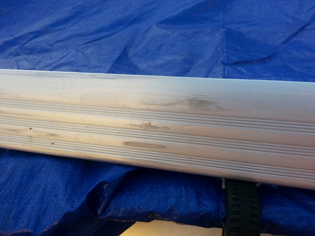

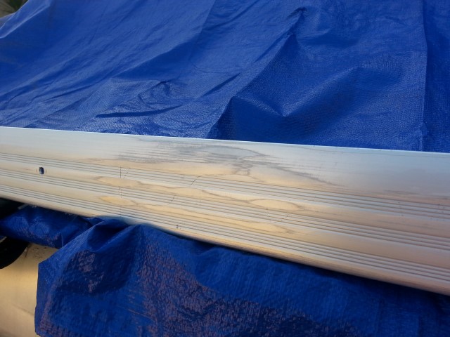

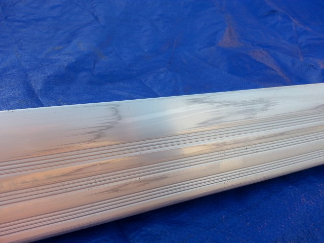

Well, I finally finished sanding down the corner brackets and they look pretty good. I decided to clean up some fine scratches on the front deck edge flashing. Most cleaned up nicely but there are several areas with blackish margins where I sanded a little deeper to remove a couple of scratches. This margin stayed regardless of sand paper grit. I am wondering if there is a factory coating that I am going through and if so, how can I take it all off short of sanding everything. It took considerable sanding to make this show up. Anyone know what is going on? Thanks.

You've sanded through the applied anodized finish of the aluminum down to the bare aluminum itself. It's pretty much like removing the paint down to bare metal when doing body work to a vehicle. As far as a way to correct this at this point, I really don't know but with time and weather exposure if the aluminum is left unsealed it has a tendency to self anodize to the point where the areas shound be a lot less visible or apparent.

Your right, I could just let it re anodize but would still have some of the scratches I was trying to get rid of. Decided to have the local powder coating folks blast it and then do a "anodized aluminum clear coat" color on it. No need to have an ugly flashing on the front of the boat while waiting for it to re anodize. I recall (a little late) reading somewhere that Premier has a protective coating on all their pontoons and aluminum. I wonder if you could apply it to areas like this after the fact?

All aluminum on pontoons is anodized, the stuff that looks natural is clear or silver anodized. I think the term you are looking for is Oxidize. When raw aluminum is left to weather it will oxidize and turn slightly darker. The only issue with this is not only will it stain easily, it leaves a black film on your hands if you touch it. Eventually it will oxidize to a point that it won't change much any longer, but the clear anodizing is to keep that "new" metal look and keep your hands and cloths from getting black stains all over them.

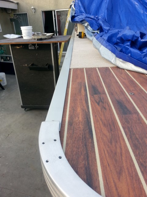

I also took the two side pieces to get blasted and powder coated. That way it will all look the same and the price was OK. There is similar flashing on the stern but it is still in good shape. Have the carpet and vinyl down and looks good. Will get the flashing back early next week just in time for another rain storm. Once that is back on can put on the new fences and measure for furniture. Does anyone have a suggestion on drilling holes in fences so that they line up with their neighbor. There are already holes for longer fence pieces but using smaller gate sizes. Maybe a simple gig to site the holes?

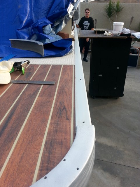

005 (Small).jpg (85.18 KiB) Viewed 9195 times
Pulled the cover back to show the carpet and vinyl with test fitting of side and corner flashing.
004 (Small).jpg (91.17 KiB) Viewed 9195 times

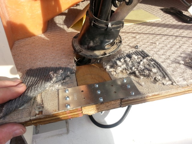

Filled in the slot for the control cables so I did not have to disconnect everything. Glued the carpet back down.
002 (Small).jpg (101.79 KiB) Viewed 9197 times

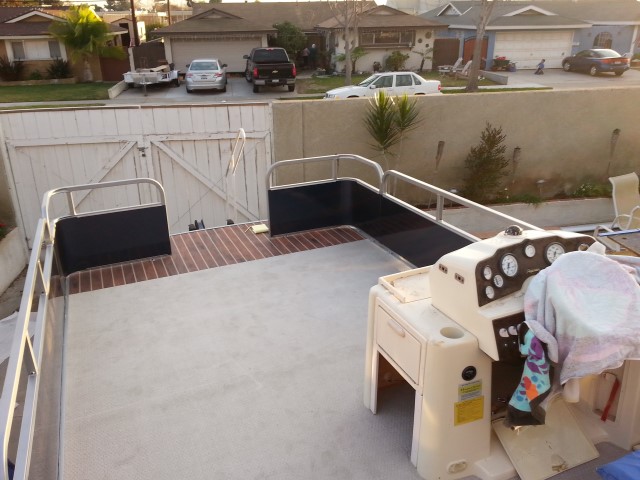

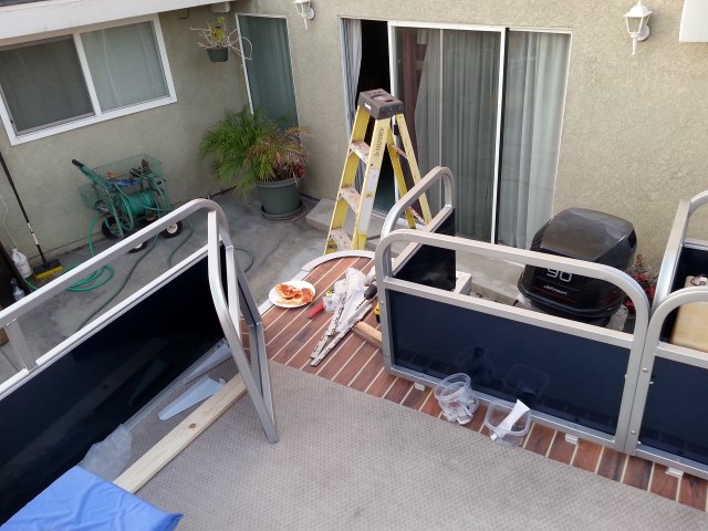

Well, after a little holiday break and weird weather I have some progress to report. Finally got all the fence up and bolted down. The stern was a real bugger but it finally all came together. Even with trying to do things in a logical order there was a lot of putting together and then taking apart going on. Had a minor glitch in the front gate measuring out at 32" instead of the planned 28". After reviewing with the pontoon fence folks we realized we had measured for full width in the stern and inside the finish trim line in the front. Their making another gate to fix and all will be well. Got the trim back from the powder coater and it looks great. Fuel tank is back in. Now need to order furnisher and paint the outboard. It looks so big inside without furniture.
Question. I have a 90hp and the literature notes can go with a 115hp. The official capacity sticker indicates max HP of 150. Is it worth thinking about going to a 115 or 150hp?

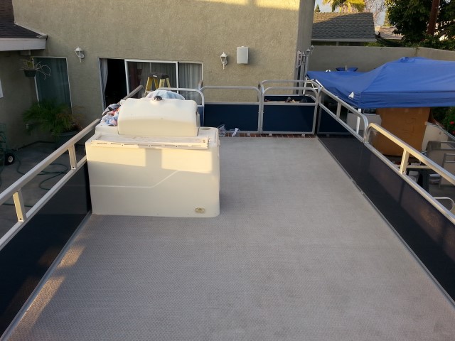

004 (Small).jpg (101.43 KiB) Viewed 9032 times
003 (Small).jpg (88.5 KiB) Viewed 9034 times
001 (Small).jpg (83.23 KiB) Viewed 9033 times

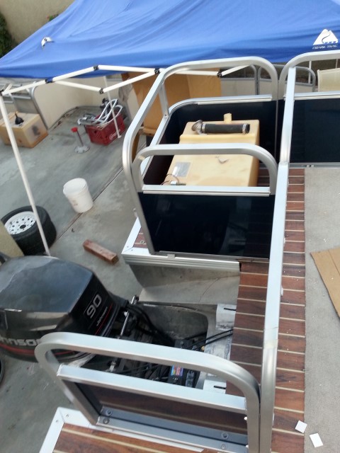

Stern with fuel tank in and new rear entry.
017 (Small) (2).jpg (91.21 KiB) Viewed 9032 times
Posts: 5446
Re: When to run wiring?
#40 Post by curtiscapk » Fri Jan 09, 2015 6:55 am
Awesome work! Oh the memories of rebuilding! :scared :happy
tuned
Posts: 1259
#41 Post by tuned » Fri Jan 09, 2015 7:18 am
Build is looking good. Rails are great fun aren't they? *Rolls eyes*
As far as powering up, most people want to at some point-depending on usage needs.
If you do, don't mess around and put the biggest motor on you can afford. The hassle of remounting a new motor just isn't worth making only small changes. Good luck!
