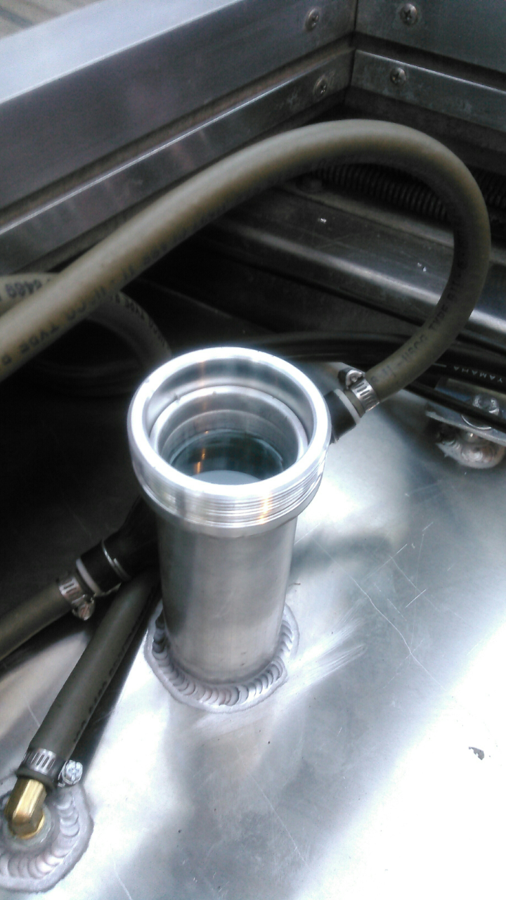

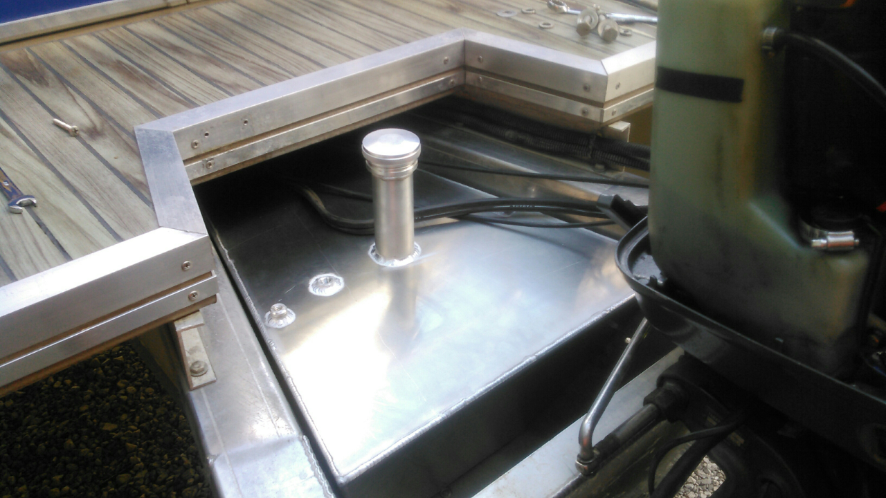

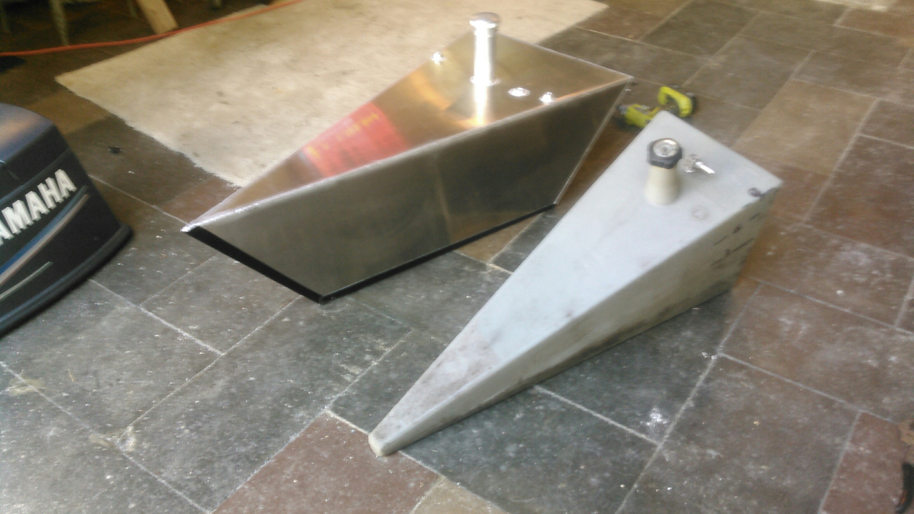

Ok so it has been a while since I made a major improvement to the boat. I consider this a never ending project, until I build another lol. My fabricator friend needed some floor work Done in his new house so I horse traded for this. [img][/img]
The original tank I used was ordered new from tracker marine. It's fit their smaller fishing pontoon at the time, but more importantly it fit the manitou transom I used. It's 9 gallons and the new one is 18 to the top.[img][/img]
My normal day at the lake I never had a issue with fuel until I started towing a tube lol.[img][/img]
Next project is a ski tow bar so stay tuned. My friend builds the copo cameros if anyone is up on race cars. Also if you need a tracker transom tank I have one available lol!
