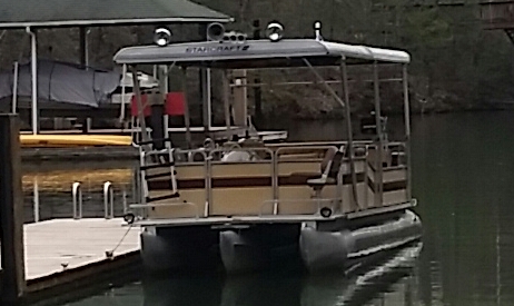

#47 Post by Luke » Tue Jun 30, 2015 5:41 pm
Put the boat in the lake today to try it out. The back sits a good 4" higher with the 3rd toon. Even after adding the front hard top and 2 seats up front I'm still going 22mpH gps. Rides much better too especially with a load of people you really notice the difference as the speed doesn't plummet so much. I need to hook up the tachometer to see what rpms I'm running but it definitely seems like I'm not taching as high as I could.
As for the pin holes I slapped some marine epoxy and spray on bedloner over until I can take the boat to a proper welder.

#48 Post by RcgTexas » Tue Jun 30, 2015 7:11 pm
Depending on how much area you put the bedliner on might cause you some drag. Maybe some acrylic vinyl, or epoxy might be a better coating.
But hey its in the water ! Enjoy :thumbsup

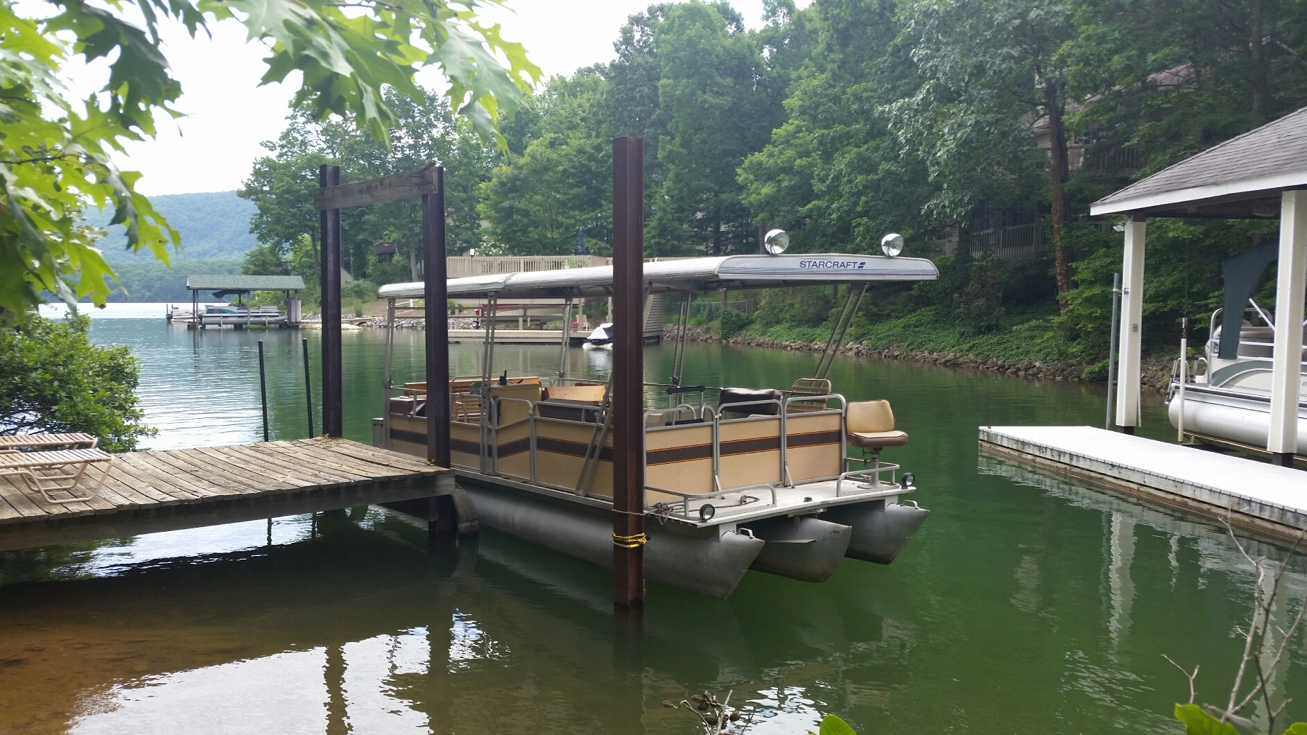

#52 Post by Luke » Sun Jul 05, 2015 6:42 pm
Taking the Fun-Toon out on the lake

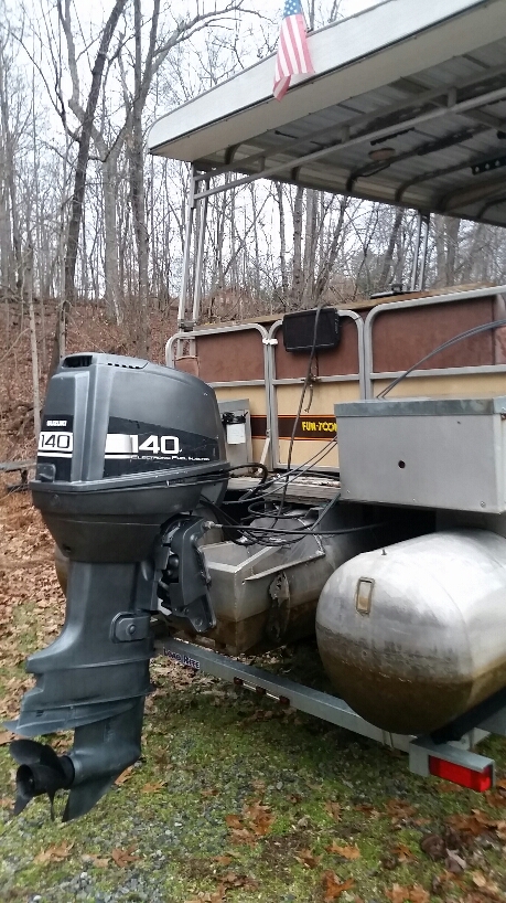

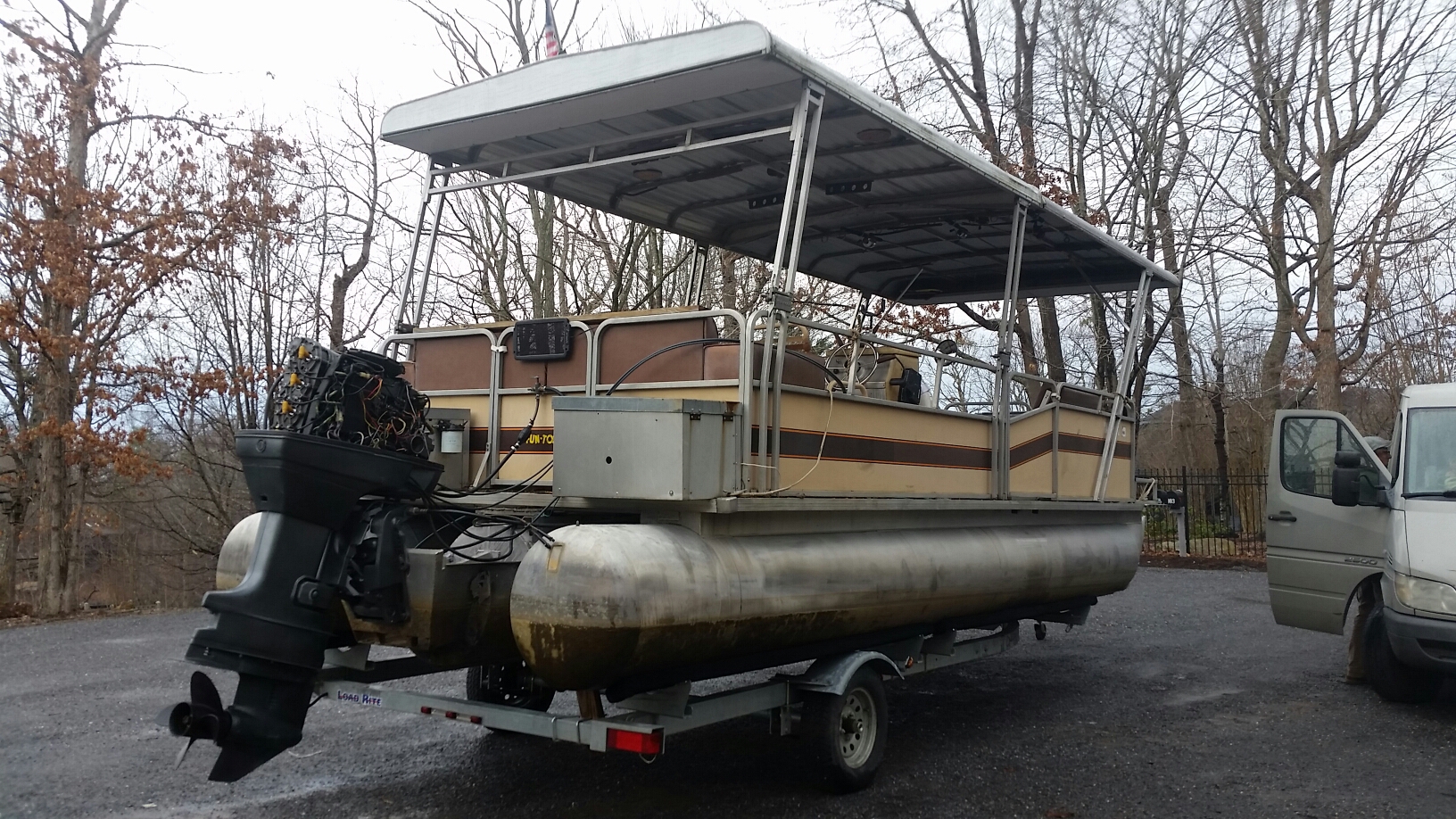

#53 Post by Luke » Sun Feb 21, 2016 4:26 pm
Picked up a 2000 Suzuki DT 140 HP 2 stroke. Got it mounted today and hooked up controls temporarily to do a test run. It's going to need new controls and a tune. Also need to get a tachometer to see if a different prop will improve the speed. It topped out at 22mph gps with very dirty toons. The 1999 Mercury 115 was struggling to get to 20 mph with the dirty toons
