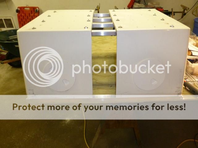

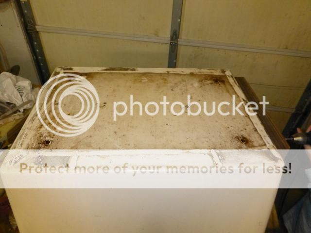

Moving forward, I have started 're-purposing' the doghouse from the donor boat.
Before shot with warmup beer.
Just a bit of cleaning required
Fiberglass dust sux. Notice I had to measure twice to cut once. I just realized that there is actually LIQUID water in the shot! Unreal.

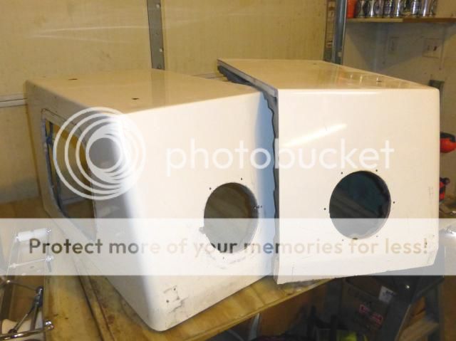

Looks like I now have a couple of cat doors in my doghouse. These will become 3 hatches. As the doghouse will end up being large and fairly heavy, I am hoping to only have to remove it at the end of the season. I SHOULD be able to do things like check my oil and even add oil without moving it if I planned it right.Image

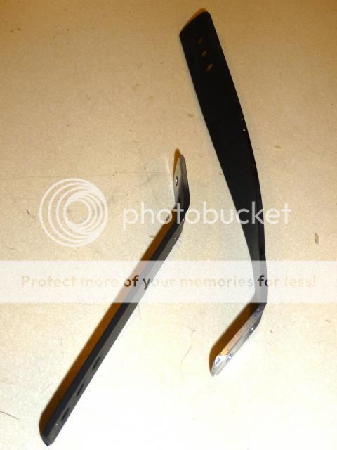

A miscellaneous shot of precision bent braces for.....um....something or otherImage

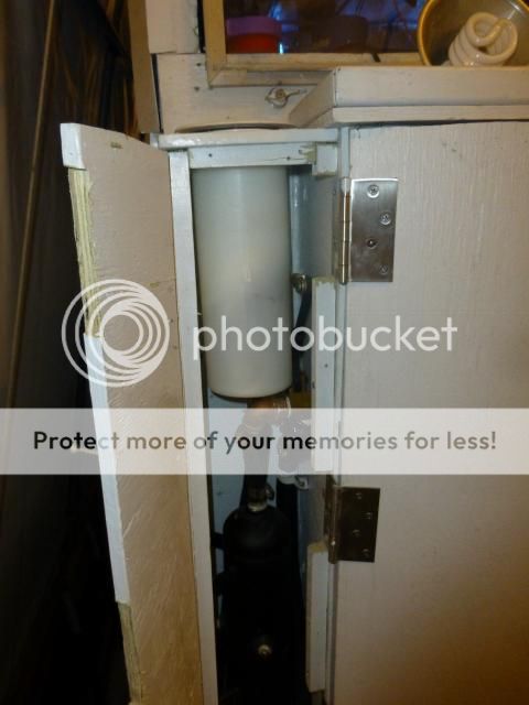

Actually wrapped up a few sections!
3 gallon air tank, 2 air compressors, dryer, manifold, breaker panel, helm, plus miscellaneous gauges and controls.
The upper cup holds my coiled washdown hose, within easy reach of the helm, for unruly passengers. :drink4
As in---SPRITZZ--"Settle down!"
Also 1 gallon air tank. Air contol valve is shoehorned way in there as well.
System runs at 140# Those big-ass train horns are back on line.
All access with four screws and four barrel bolts. Access is good.

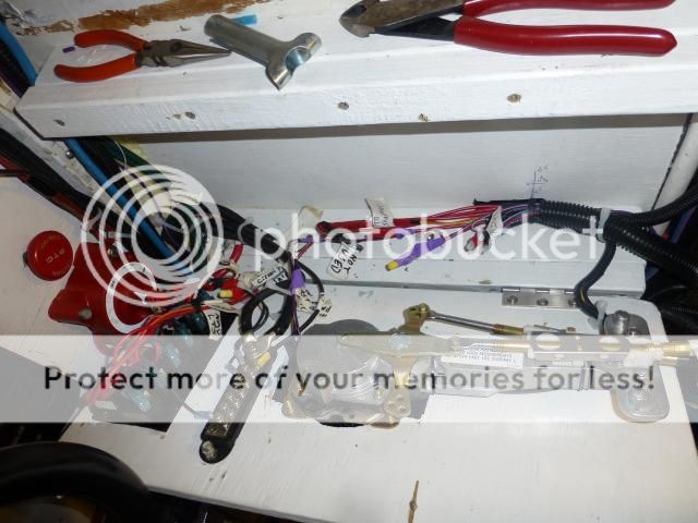

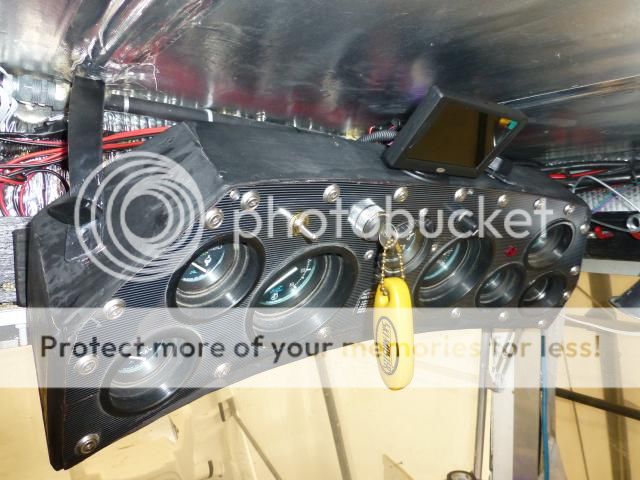

Back of the gauges I stole from the SeaRay. Completely rearrainged and rewired. The box is hand built around the original curved faceplate. So many angle cuts, including curved angle cuts. It may not look like much, but I put a buttload of time in on that sucker.
Oh that's what those funny braces were for.
Back of the contoller panel including 2nd breaker panel. Man I love hinged panels for good access.

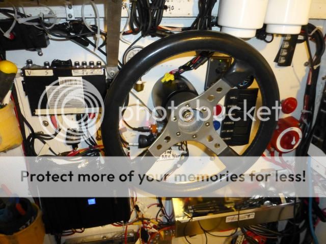

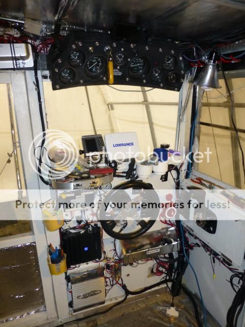

Controller and breakers. Master power switch-ON/OFF only (for two large circuits). Note the little red PTO knob? Straight to the train horn, baby!
Helm area. Stereo wiring is cleaned up. Surface wiring is almost as better than the quick access panels. Just in case I have tunes go down, I don't wanna waste any time troubleshooting :guitar There actually is a completely seperate mini stereo shoehorned in there as well. Redundancy, redundancy, redundancy. 3 Fire extinguishers, 3 seperate horn types, 2 flare guns, 2 vhf radios etc...ad nasuem. You get the picture-I'm a freak :smoke
I have a few tools to clean up, but the boat is now about 98% wired. Each and every wire pulled and terminated by yours truly. No smoke so far :scared

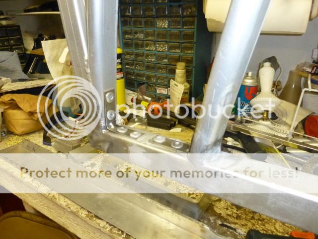

Still a bit more cleanup to do, but initial grind-down with the flap disk shines those joints right up. Note the vertical weld (factory) doesn't look as nice as the brazes IMHO. Some polishing followed by a little time in the weather and it all should end up one color and look pretty good. STOKED!

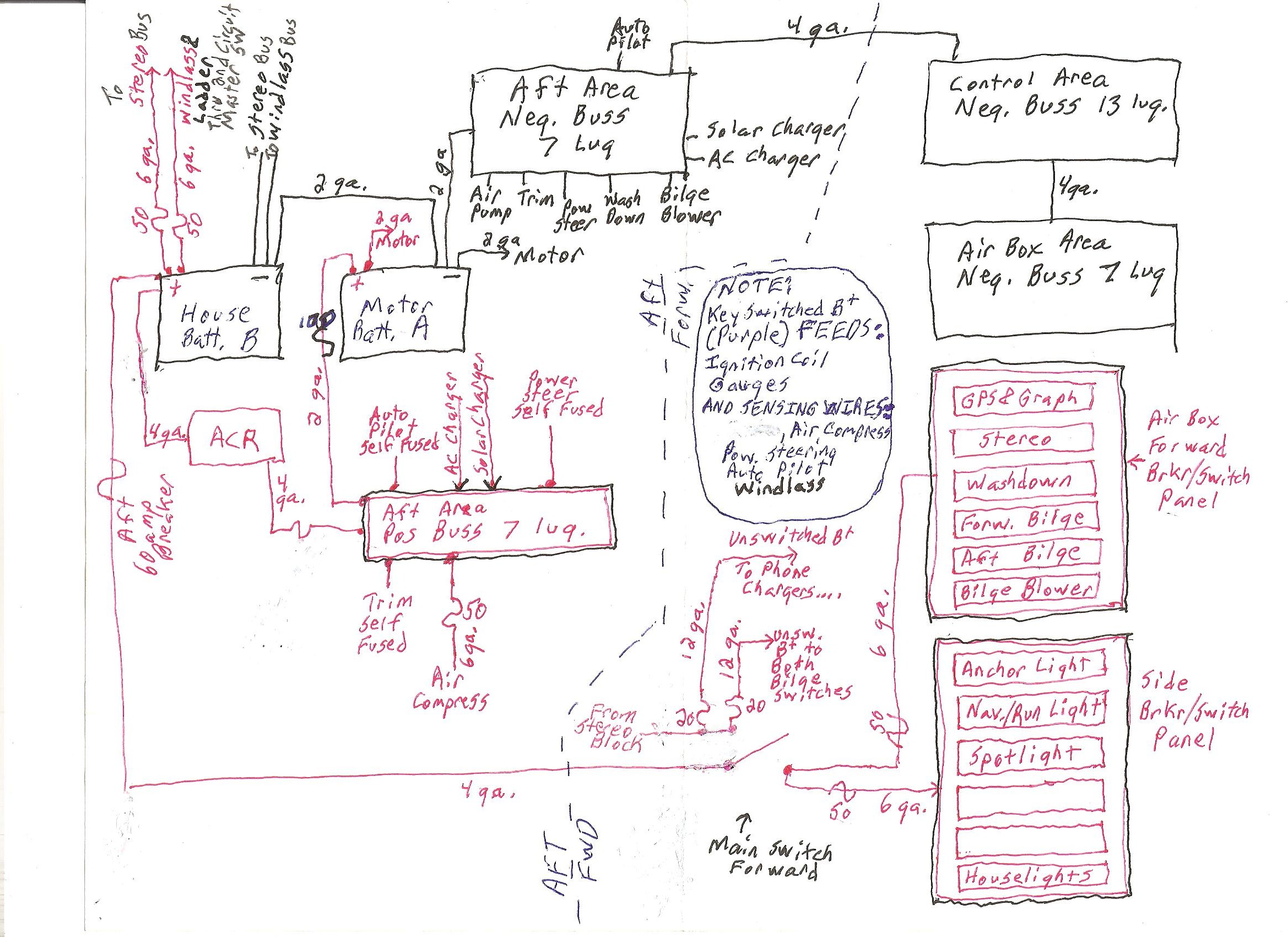

You have a wiring diagram for that???

tuned
Posts: 1259
Re: Al the Mirthmaker (Mark III)
#90 Post by tuned » Fri May 03, 2013 8:32 pm
kryptonite wrote:You have a wiring diagram for that???
:rofl
Funny you should ask...this particular one is the rough draft of the large wiring only.
