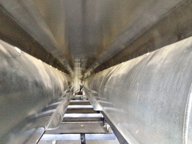

Re: Project Twin
You got that right! With that being said...aint this Purdy:
- 55.JPG (135.89 KiB) Viewed 7556 times
- Posts: 5446
Re: Project Twin
wow!!
Re: Project Twin
Very purdy indeed!
2006 dodge ram quad cab
Crosby Texas
Crosby Texas
Re: Project Twin
Beauty job eh! (That's Canadian for NICE!)lToonGuy wrote:You got that right! With that being said...aint this Purdy:
Now, you need the number of a good chiropractor?
Re: Project Twin
Ya, and it's just pushed into place, I haven't even fastened it yet
Re: Project Twin
Looks good!
Ferg's Tritoon Build
