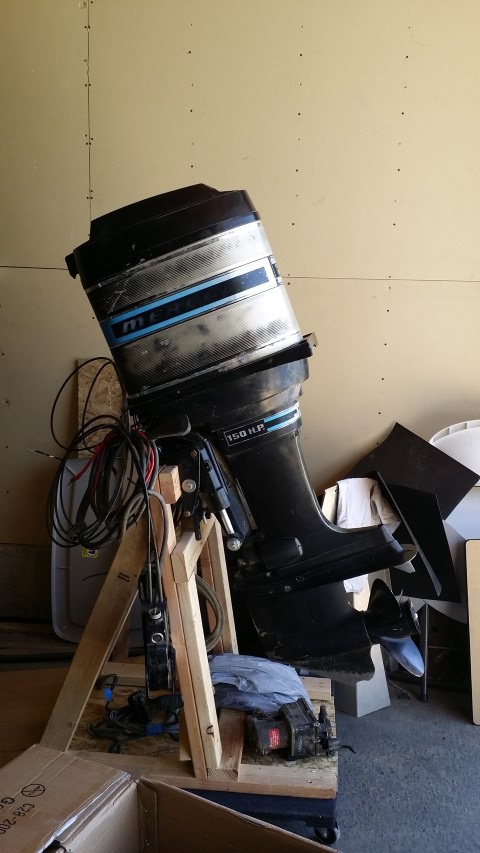

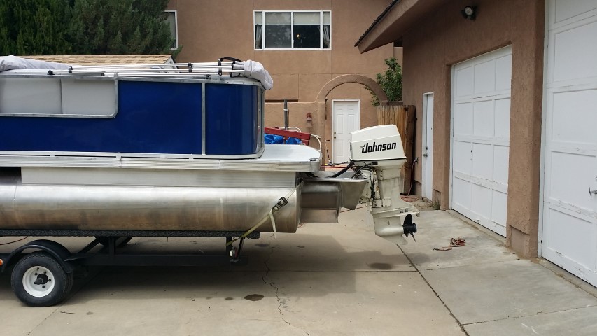

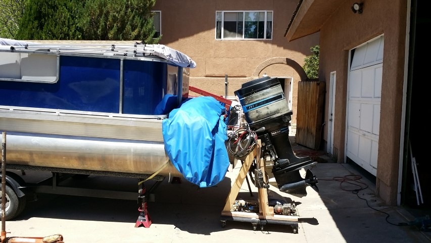

Here she is. The "Thunderbolt" tower of power.
little bit of an upgrade from this
to this

Went to the lake yesterday with the "new to me" mercury 150. It was a successful trip. I set the bar pretty low due to the condition of the engine. I just wanted to see if it would run, shift, and not fall (tear itself off) the boat. I did just enough to get it to run and pump water through itself. It ran good in the drive way. But like we have all heard or gone through in the past. It was a different animal at the lake. I got it in the water, it struggled in idle going into gear (would die shifting into gear unless I gave it a little throttle), slow to increase in rpms, stumbled at WOT. Got it out past the no wake buoy, gave it WOT...and it struggled getting to 2k rpm, then slowly crept up to 2800rpm (16mph), that is the climax of the trip. I could get it to 3k rpm but only if I cranked the boat to the left (no cavitation or ventilation). Was weird, if I drove in a 50 yard circle (to the left) the rpms came up to 3k mph went up to 18.2 mph(in a turn). When I straighten it out engine stumbles a little and rpms go back down to 2600-2800 and mph goes down to about 15 mph. Anyhow, I think it was a successful trip for a 1974 engine that only the good lord knows when it last tasted lake water.
Plan now is to put a little more money into it I am going to start with carb kits, link and sync, replace hoses/filters, fuel pump rebuild, new gaskets, o-rings and and what not in lower unit. I currently have an aluminum prop on it(says 17P on it...probably some other numbers but I didnt pay attention). I have a stainless prop for it that is a 19P.
Any suggestions other than what I have planned would be helpful.
