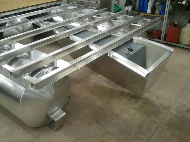

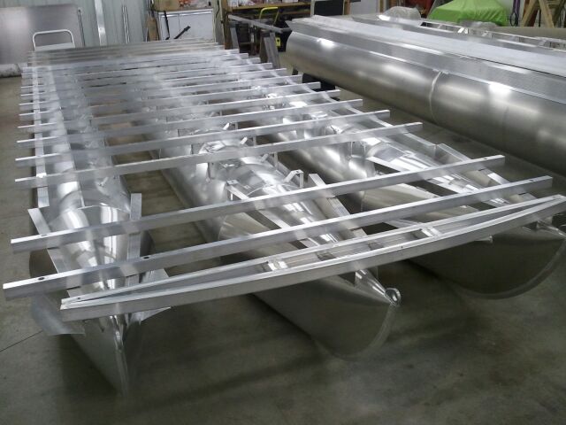

So I've been having terrible insomnia lately, worse than usual. It drives me crazy to be unproductive, usually I get up and excersize or do house work. But this morning I decided to get my arse out to the shop and start on some thing FUN! Laid out the tubes, drilled lots of holes, and squared it up. Here it is as I'm laying out the rest of the cross members and geting ready to do a LOT of bolting...

Looks great!! What kind of toons are you using and are you building 2 boats (more toons off to the right side)??

I'm using 25" diameter pressurized tubes I picked up locally. I'm always doing some thing with boats, so I guess the answer to your question is yes :lol3 . I do have another pair of tubes sitting in wait, I just decided to start some thing cooler first. Funny thing is I had a guy stop today to look at another toon I have, and he thinks he wants to buy this one when it's done. Perhaps my insomnia was for a reason :biggrin2 :donno

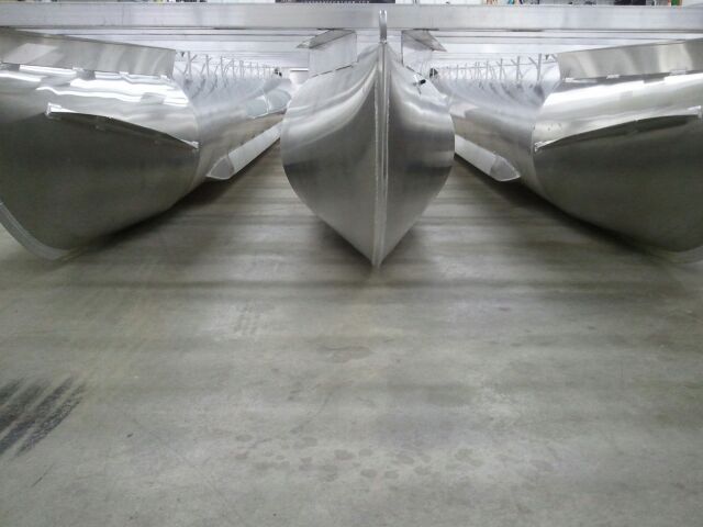

Why didn't you go with a larger center tube?
Why no lifting strakes on the inner tube?

For the same reason you don't eat the same thing every day for every meal. Some times you just switch it up. I won't be keeping this boat, so I'm using the parts I already have on on hand to build a nice quality boat. Bellieve it or not, not every buyer out there is looking for a top of the line performance tri-toon.

How did you go about squaring up? When I built my last boat (Premiere blemish tubes), we had a bitch of a time using the old tried and true method of measuring the diagonals. Although I could swear I had it perfect at the time, when I finally put the plywood on, I was about 1/2" forward with one tube. Hardly noticable, but it always bugged me.

I always use the diagonal measure method. Also, always re-check after you get a few cross members tightend up. Some times they can pull it one way or the other. Another thing...sheets of marine plywood aren't always 100% square. Some times if I'm off a bit on the 2nd or 3rd sheet I'll switch them out and that has always helped.

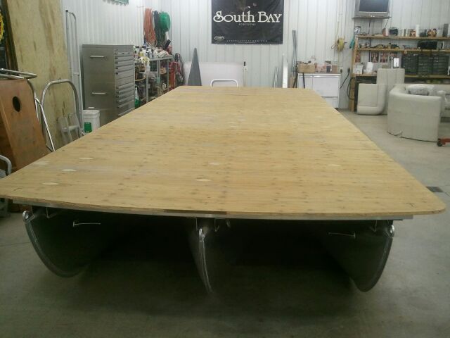

Got the transom mounted and the decking installed and trimmed up...
