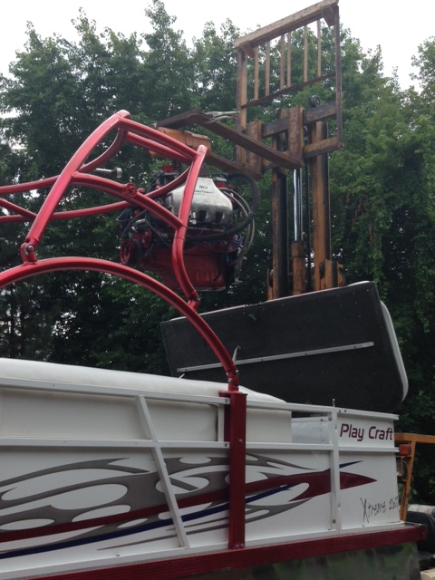

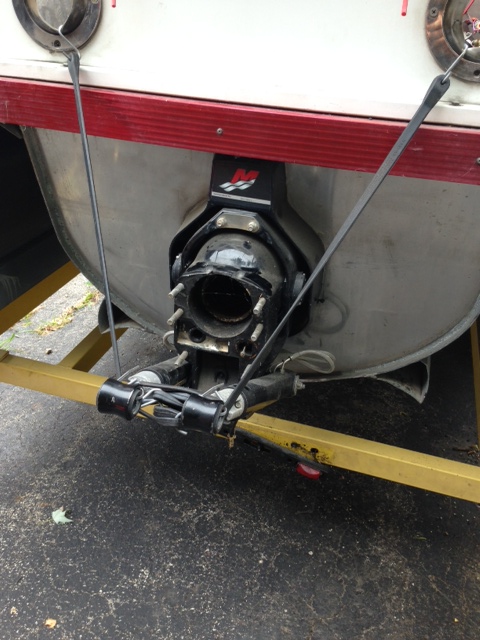

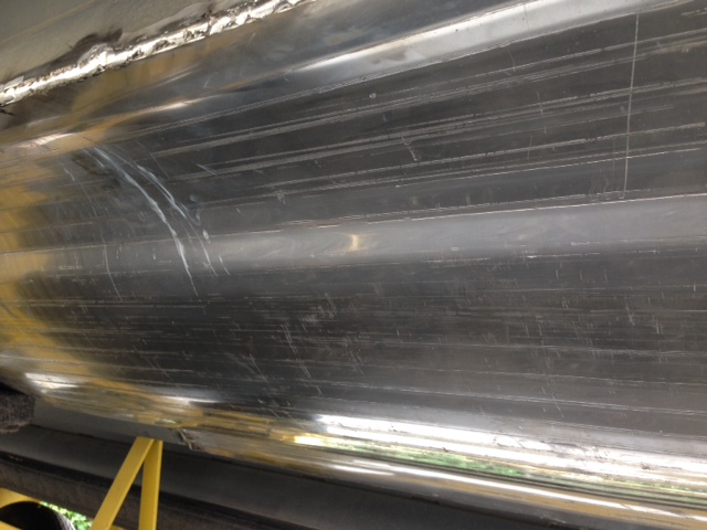

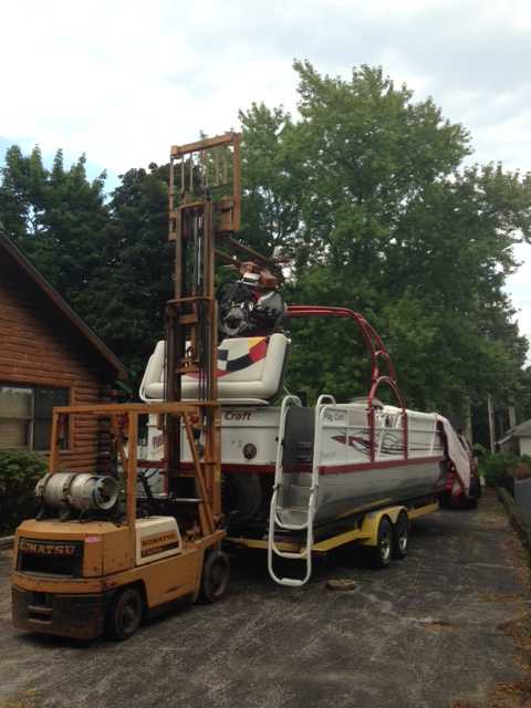

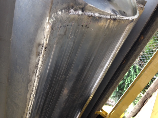

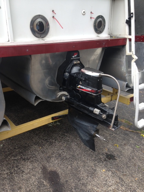

So last year, I did a form of poker run with 60 or 70 offshore boats. I wound up hitting a large wave, and caving in the center toon, under the engine compartment. Also the steering had alot of play in it, down by the drive. I used a porta-power to press out the toon, then formed a 1/4"x4'x4' aluminum plate, and had it welded below the toon. I also removed the drive mount, and rebuild the steering. here are some pics from today. JT

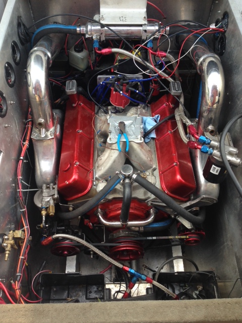

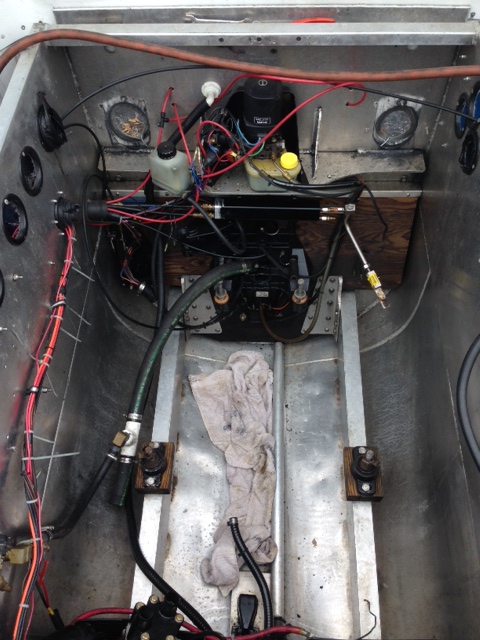

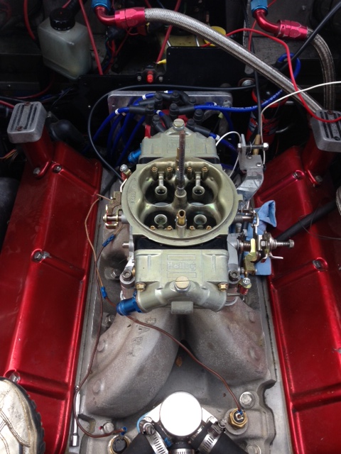

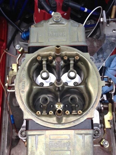

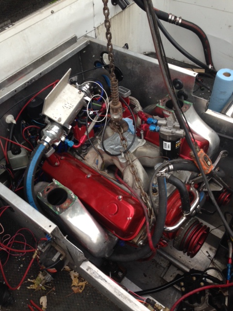

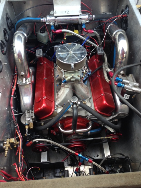

got the drive on, oil cooler mounted, fuel filter/water separator changed. alternator mounted, some progress anyways. JT

#6 Post by pond tuuunes » Mon Jul 28, 2014 5:21 pm
put the pipes, sea pump, fuel pump, and water separator today. JT

a couple small steps, getting close. JT

#11 Post by pond tuuunes » Sun Aug 10, 2014 5:16 pm
it lives. I don't know if its the plate welded to the bottom of the center toon. or emptying the front tank. At top speed the boat is riding higher out of the water. I didn't have my GPS with me, but top end was definitely faster. I raced a Sunsation go fast, and was pulling away from him on top end. Im happy. JT
