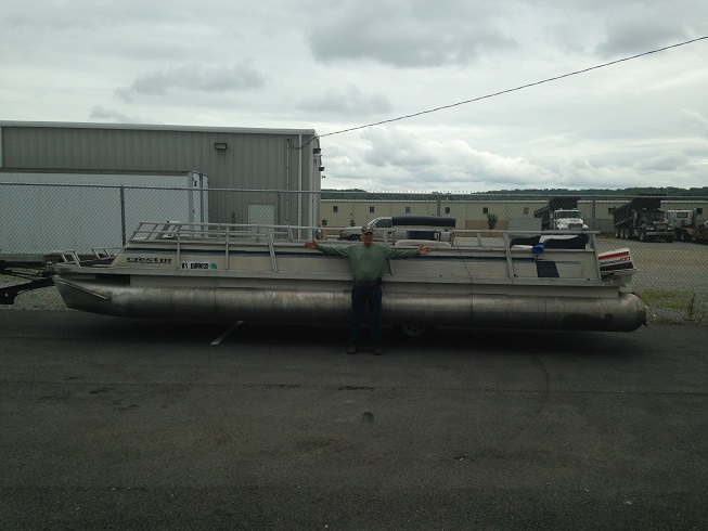

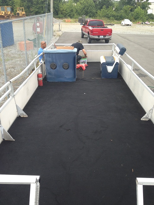

Well, my wife was out of town for 2-weeks and was hanging out with the guys looks at pontoon boats. I found a diamond in the rough and brought it home. It was a 29' Crest III pontoon (1987) with a 100hp Johnson OB Motor w/ trailer. Motor had good compression and the tunes were it very good shape. Got it home and power washed the 2-3 years of dirt and debris off it. It was located in the woods so you can image how bad it looked.
Had water in the gas, junk in the carbs.....$250 later in parts and fuel we had rebuilt carbs, fuel pump, water pump, and fresh gas in the tanks.
- Before Cleaning
- 2014-07-19 18.12.11a.jpg (94.95 KiB) Viewed 8457 times
- After Cleaning
- 2014-07-20 12.17.03a.jpg (118.59 KiB) Viewed 8452 times

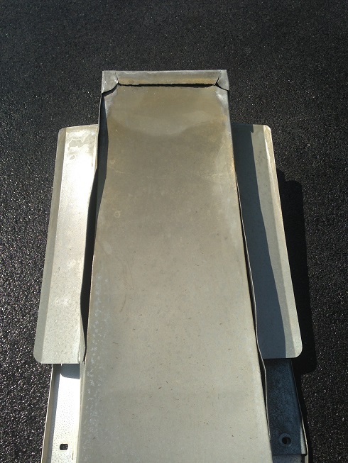

Took it out with the guys and it bucked and had water splashing up around the engine like something crazy.
Found this....transom must have froze and was splitting out badly. Was torn almost all the way around.

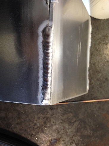

Gave me a reason to purchase a new tig welder for my project.
Forgot to take a picture of the finished before we put it back on the boat...but here is some of the welding.
- Tig.jpg (49.25 KiB) Viewed 8444 times
- Transom.jpg (133.57 KiB) Viewed 8446 times

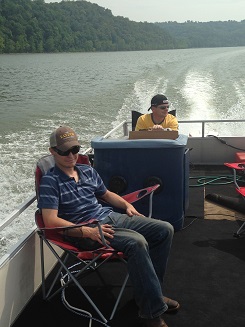

Now its running good!
- Smooth.jpg (39.85 KiB) Viewed 8442 times
