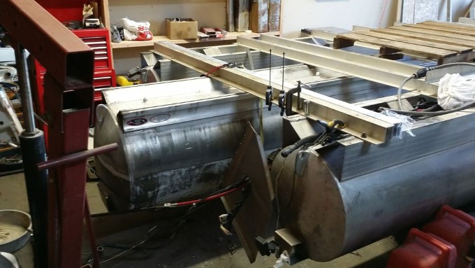

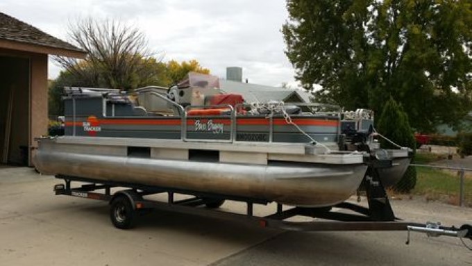

Bought this boat at the beginning of summer 2014. 1988 20' Sun tracker Bass Buggy ( deck is only 16'...lose 2 foot in back for fuel/batteries and the deck 2' back from end of the toons in front), it has a 70 hp johnson. It has been a great boat for us (although I would like it to be a little faster, nothing crazy maybe 25-30mph would be nice...max mph with me and my boy is 20 mph, with family 18mph), Family and I have enjoyed going to the lake, so it is time to give her a new start. Forgive me on my computer ignorance. Trying to transfer pictures from ipad to computer or samsung to computer...
more pictures on the way. I have plans to extend the front of the boat out to the ends of the toons (about 2'). I would like to extend the back out as well but that would involve moving the motor pod back (at least in my plan).
I welcome ideas comments.

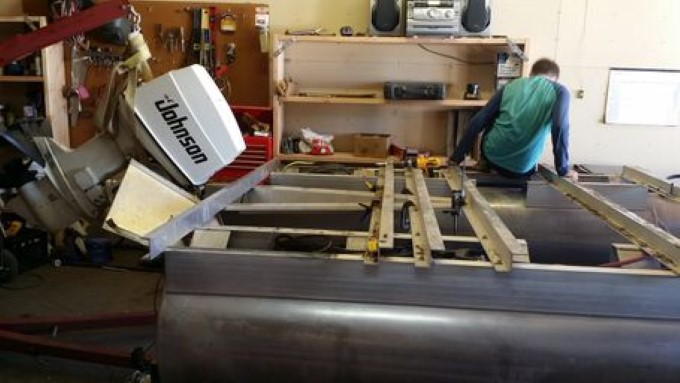

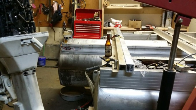

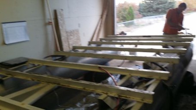

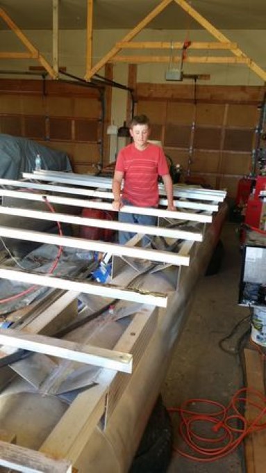

I did not have a chance to do a whole lot this last weekend. I found some "c" channel local to add a floor stringer to the front in order to extend the front out another two feet. For some reason I got a wild hair and started extending the back of the deck. I unbolted the engine pod and moved it back about two feet. I will need to add some more stringers for the floor and engine support (I will add pictures later today). I am excited, those two additions are essentially going to give me 4 more feet of floor space. The one big concern I have is that moving the engine pod back, I have really changed the balance and that thing is going to sit LOW in the water. I may have a solution to that! I found a guy in phoenix who is selling pontoon logs, I am headed there this weekend to pick one up. So I think the new plan is going to try and build a tritoon with the engine pod on the middle tune (similiar to liquid asset's rebuild).

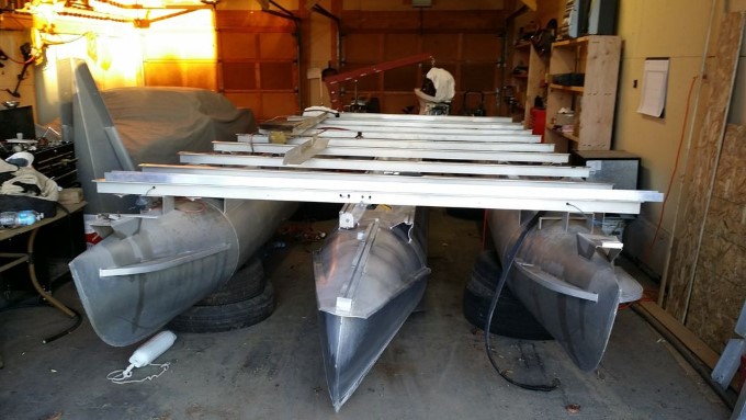

I will certainly stay on the pics. If i was not adding a third pontoon (with current engine pod/transom welded into into it), moving the engine back would definitely lower the pontoons in the water. By how much I do not know. My two batteries and two 6.5 gallon tanks probably would have found a new home (tanks under the back couch seat and batteries as far forward as I can put them). I have no idea what kind of performance change I will get out of moving the engine back (I would guess little to none...the headache of moving the engine up?), my only purpose of moving the engine back is to get more deck space. My original plan with the boat was to just flip it and make a little pocket cash. Then I made the mistake of taking it to the lake...over and over and over again. So the next plan was to rebuild it sell it and buy a bigger one. The wife was all for this plan, but she did not want to be without a boat for any length of time. So now the pan is to make this a bigger one, use it till we can afford a new boat.
As far as new railing, I am not sure yet. Possibly buy 1.25 aluminum tube and splice in, or move playpen all the way back and have 4 foot of fishing/diving/bowfishing up front. We thought we would wait to order furniture (from pontoon stuff.com using the 10% discount from this forum) until the carpet was on. That way we could place the playpen we have and make cardboard templates of furniture.

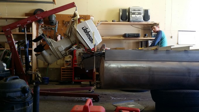

As far as the boat goes this week, not much progress. I pulled the engine off (hopefully will have a chance to build a simple engine stand tonight). possibly going to untangle the wiring and start re-wiring.

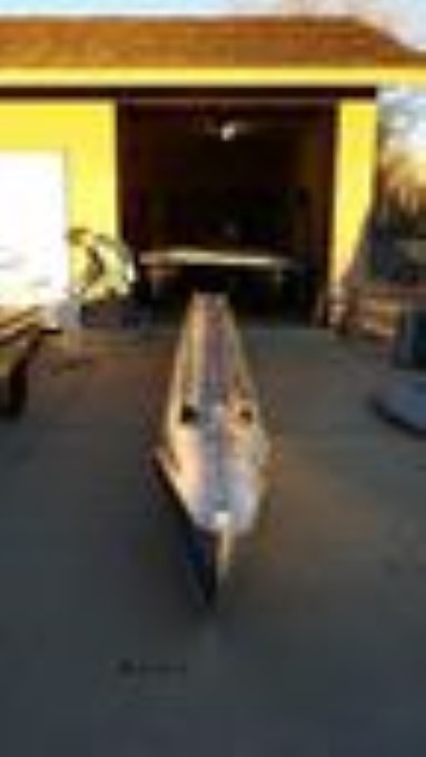

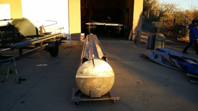

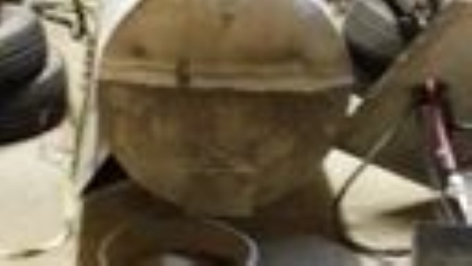

Took a trip to phoenix picked up a third log. It is a right sided 25" diameter 22 foot log from a 2013 harris float boat. It was taking on water and replaced by the Harris dealership.
Question for the day...do I remove the strake or add one to the other side? If I add one, what are my options for getting the material?

Add one if at all possible, but with the Motor you have you may not see any gain or improvement.Question for the day...do I remove the strake or add one to the other side? If I add one, what are my options for getting the material?
Re: 1988 Bass Buggy winter/Gravity project in New Mexico
Thanks for the info. I am thinking I will keep it and add another. I contacted Harris company, to ask about ordering a strake all by itself, they directed me to go through a dealership. They said all I needed was the Hull ID number
and they should be able to order it. Other option is to find the material and a shop that can handle bending it.
I do believe you are correct with my current motor. Budget limitations are going to force me to stick with what I have for now.

I will try to get pictures up later today, to bring everyone up to speed. Trying to measure and figure compound angles from the transom and transfer those to a round and cylindrical log is a mind twisting chore! At some point in that process (probably after a few adult beverages) I decided I was done trying to get the perfect line and broke out the sawzall. It was not a pretty sight. I ended up making 50+ cuts around that thing each time the aluminum slices became smaller and smaller, until the grinder came out. Finally, the transom fits snug as a bug. It is ready for the welder (if I can find a reasonably priced one).
I put the center log back on the boat, with the transom in place, at its approximate final location and realized that the engine is going to be too far back (wait for the picture). The center log is 22', the right and left logs are 20'. My goal was to get the engine a little further back (about 2'), into "clean water". However, I left the transom hanging out past the center log about 6-7" (was an arbitrary guess to start my measuring). You will see in the pictures, I have 2 feet of extra log (past side logs) and anther 6-7 inches before the engine, the engine is about 20" long front to back. From eyeballing it, it looks like it is a mile out from the back of the boat, from the back of the playpen to the back of the engine it is about 4'. I realize pictures will make a world of difference and will wait for comments until then, but it sure seems to me that it is TOO far back.
I have a couple of options. 1)weld it up as is, then trim the transom up tight to the log and re-weld transom/engine plate. 2)move the center long forward of the outside logs. 3) both of the above. What are the draw backs to having the center log forward of the outside logs? What are the draw backs to having the engine too far back?
