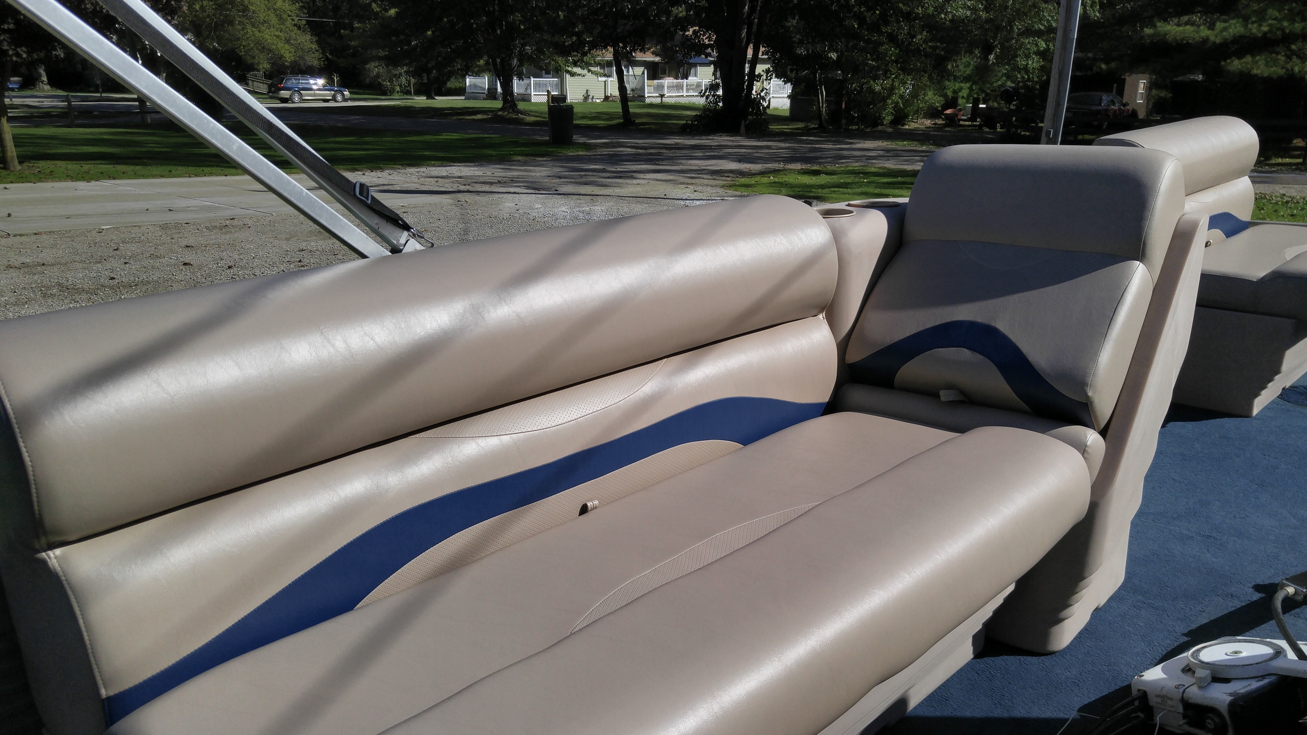

Boater insanity has set in. I purchased the boat, trailer and motor for $2800. The boat was re-decked and carpeted last year. A little over a week ago I ordered everything make over the boat into our dream lake cruiser. I *think* I've spent about $3500 on items for the make over. It's getting a L shaped couch filling the rear and up the port side with a lean back (88"X92") and 2 38" bench's up front. New Helm and flip flop style seat for the captain. I will be using the overton's Toonmate Premium Pontoon furniture (selected because their corner sections come in 25" which is what I needed to have 88" along the rear of the boat. I *think* these are make by wise and branded for overton's. I ordered them during the 20% off sale a week or so back.
Here's is a stock picture of the seat color's I selected.

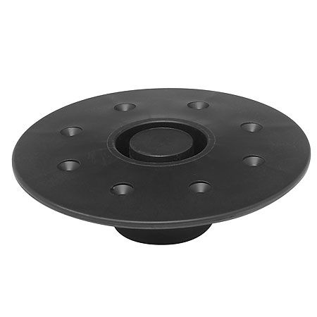

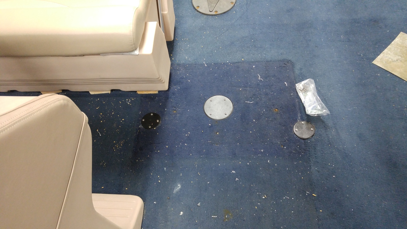

I still need to figure out what I am going to do about holes in the floor under the old console and where the fishing seats went. I'm thinking of just putting a pedestal base like this in
it's place (all the fishing seats use these already.

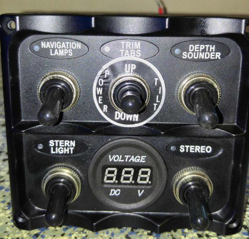

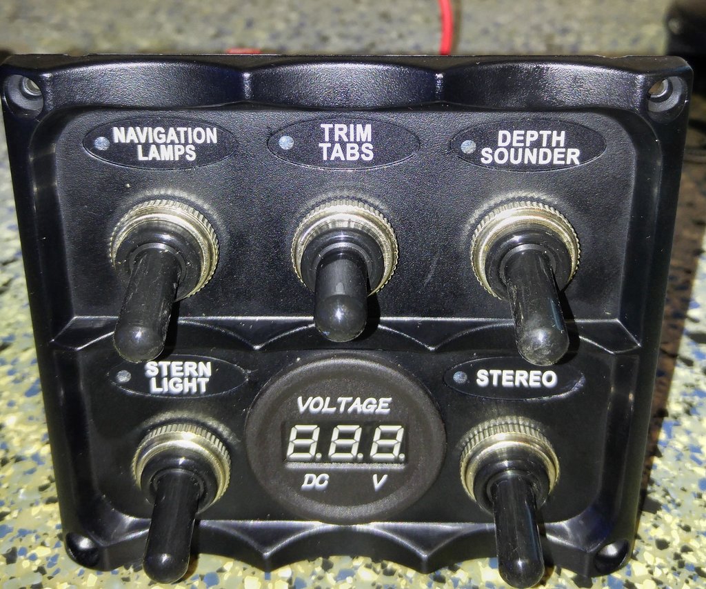

Opinions wanted. Keep the Power Trim up / Down tag on or off?
ON
Off

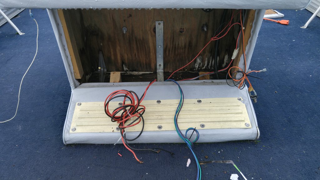

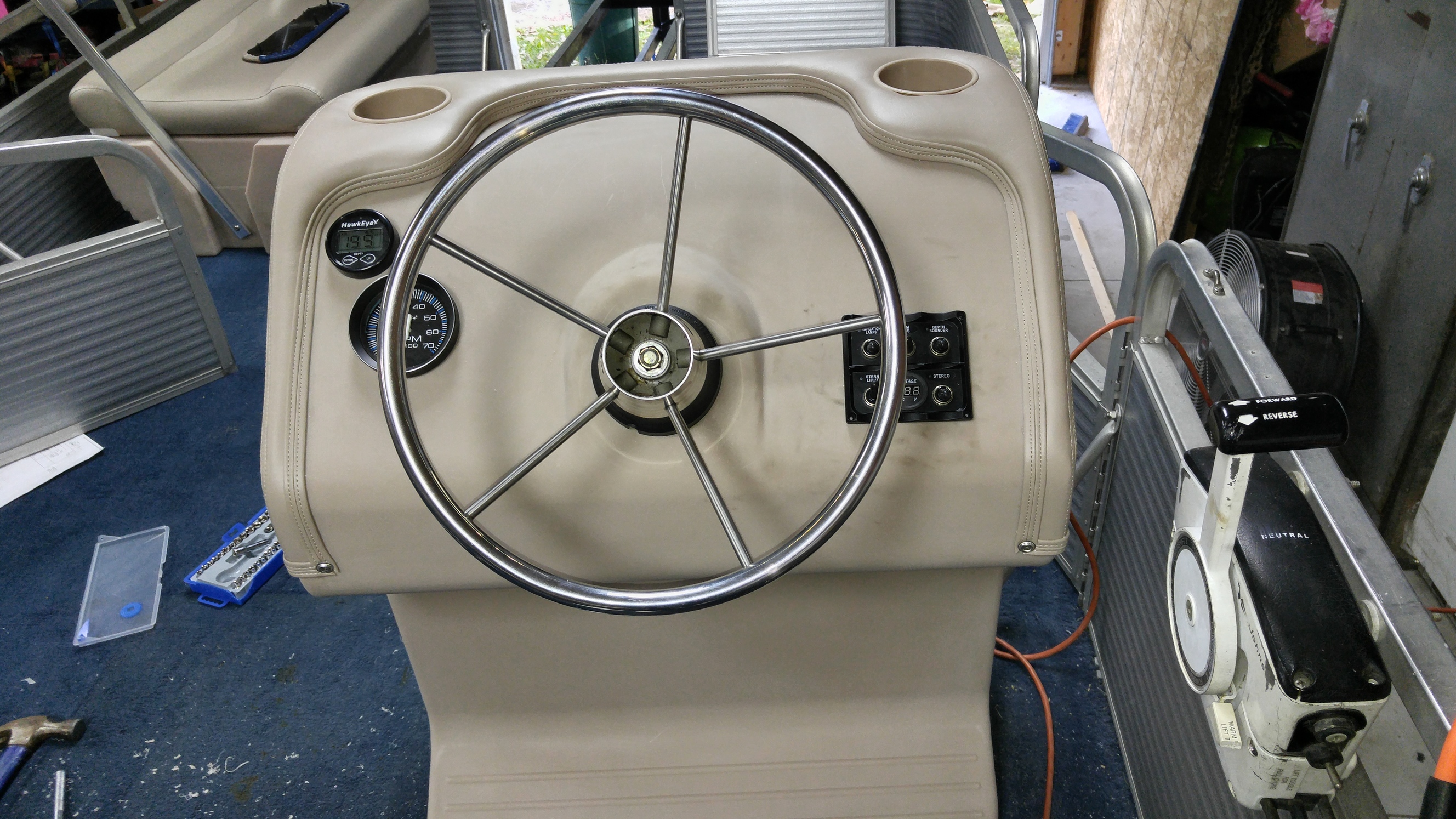

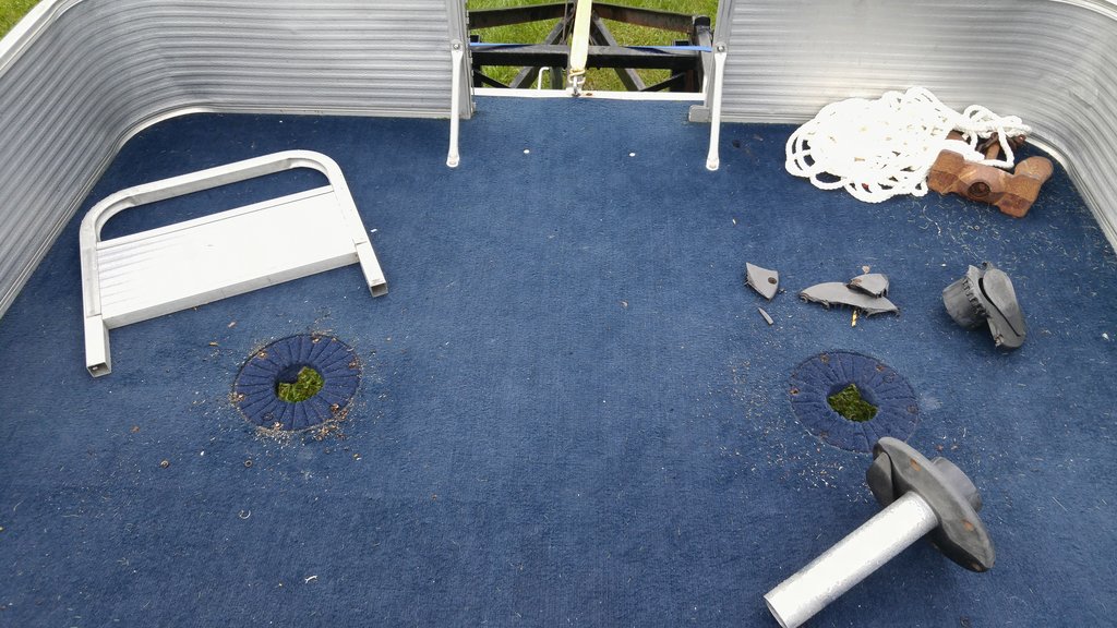

Started tearing out the old to make room for the new. The Seat pedestals gave me a little bit of grief. the bolts were rushed and the screw heads would just strip out. So I drilled the heads off and used a BFH to get them out. 1 more pedestal to go. Found a cluster F^&% of wiring under the console. a 12V hot just laying there next to it's ground partner.
Posts: 2656
Re: 1988 PlayBuoy Sportfisher makeover.
#5 Post by RcgTexas » Tue Sep 08, 2015 5:49 pm
Those are real nice pics of the console switches..............now give us a few of the rebuild. :wink:

#6 Post by toondown4what » Tue Sep 08, 2015 5:53 pm
RcgTexas wrote:Those are real nice pics of the console switches..............now give us a few of the rebuild. :wink:

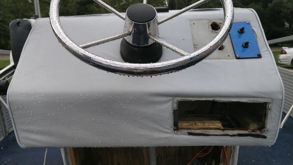

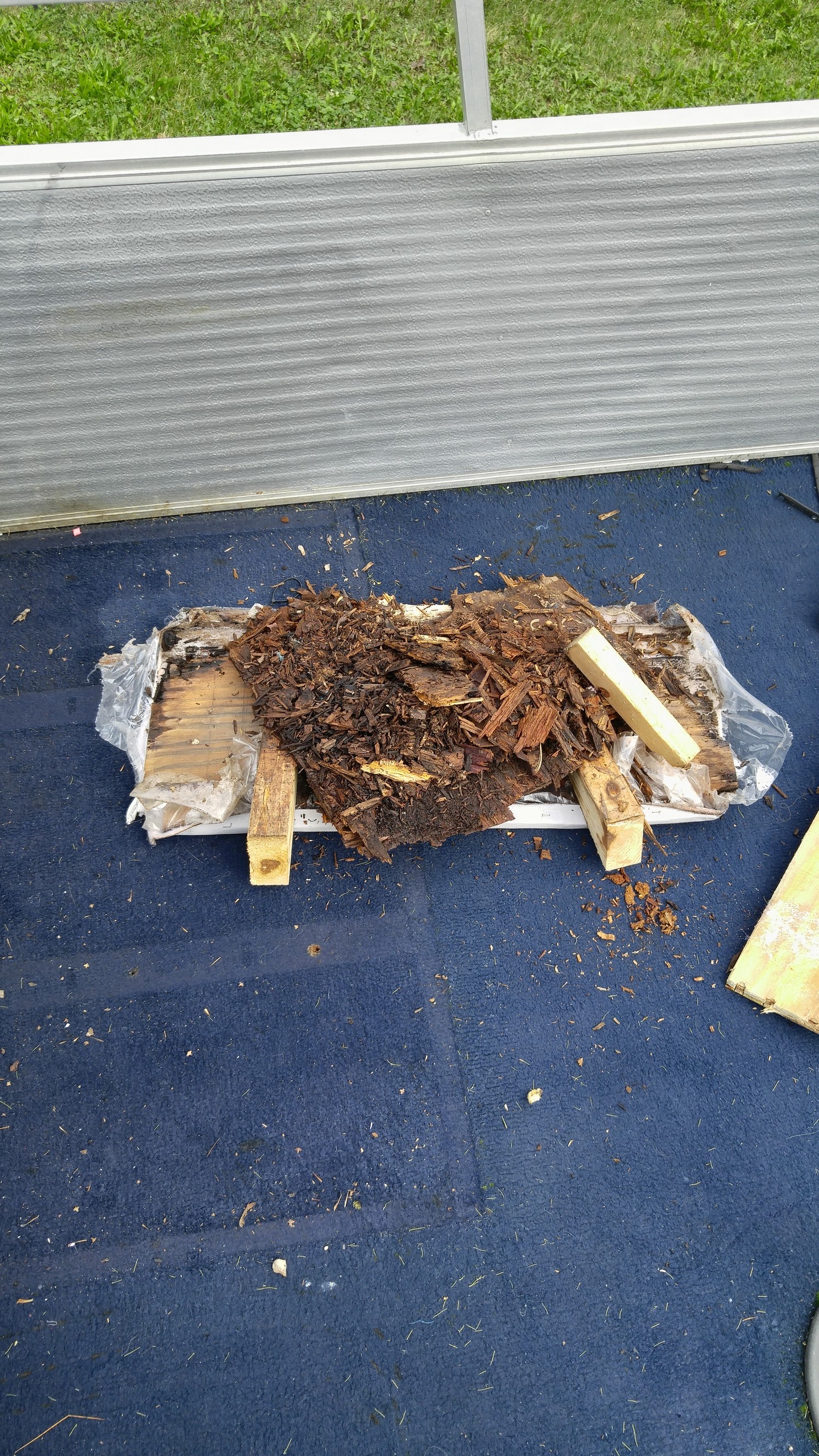

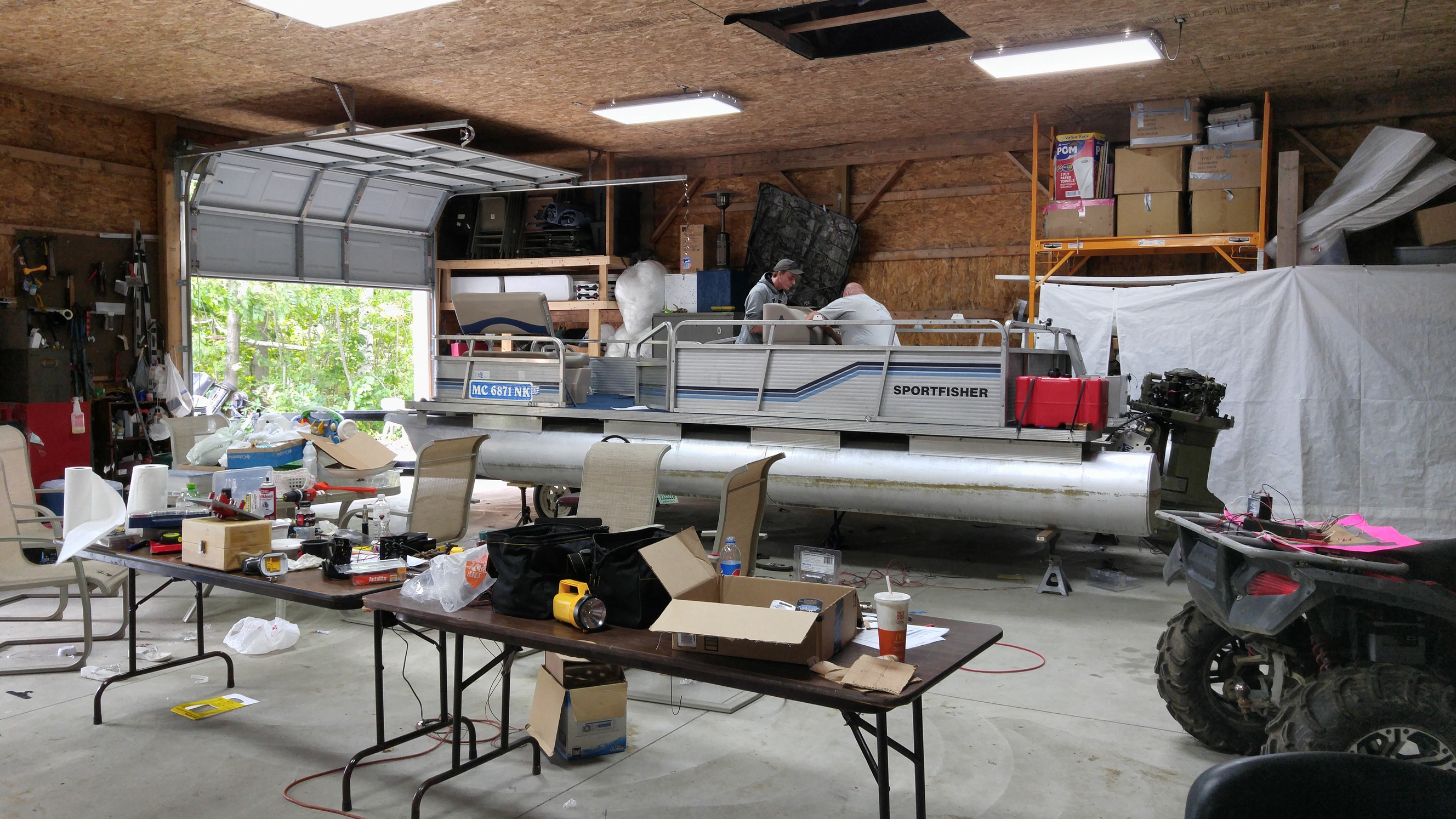

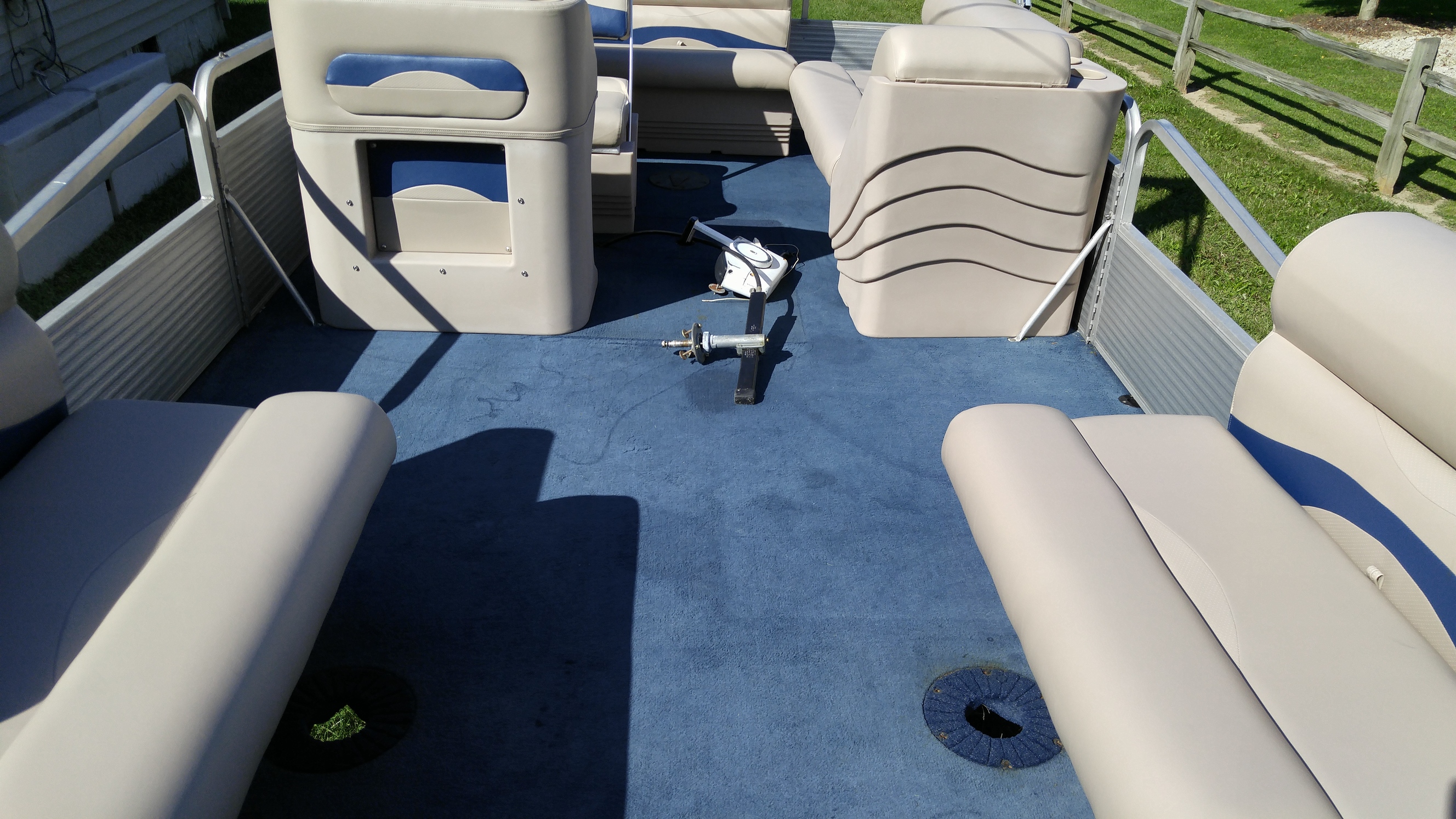

Obligatory before pictures. Actually I started a little bit of tear down yesterday.

#8 Post by toondown4what » Wed Sep 09, 2015 3:01 pm
Have most of the tear down complete. Under the console was a disaster.
Unable to get the steering wheel separated from the console. Have PB Blaster soaking on it and then I will tap with a hammer and pull.

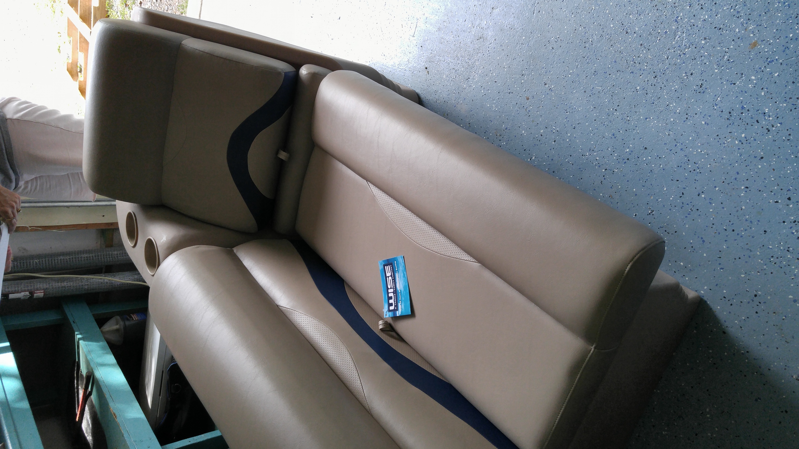

Best part of the day was the UPS semi coming down my road with 2 pallets. The downer is that I am still missing the 2 corner sections I need for the rear. I called up overton's to check thier status to discover the order was canceled because they are out of stock. I wanted 90 degree corners. So instead I had to order radius corners. This will leave a minor gap. But oh well. they said they will ship tomorrow and be 3-5 days.

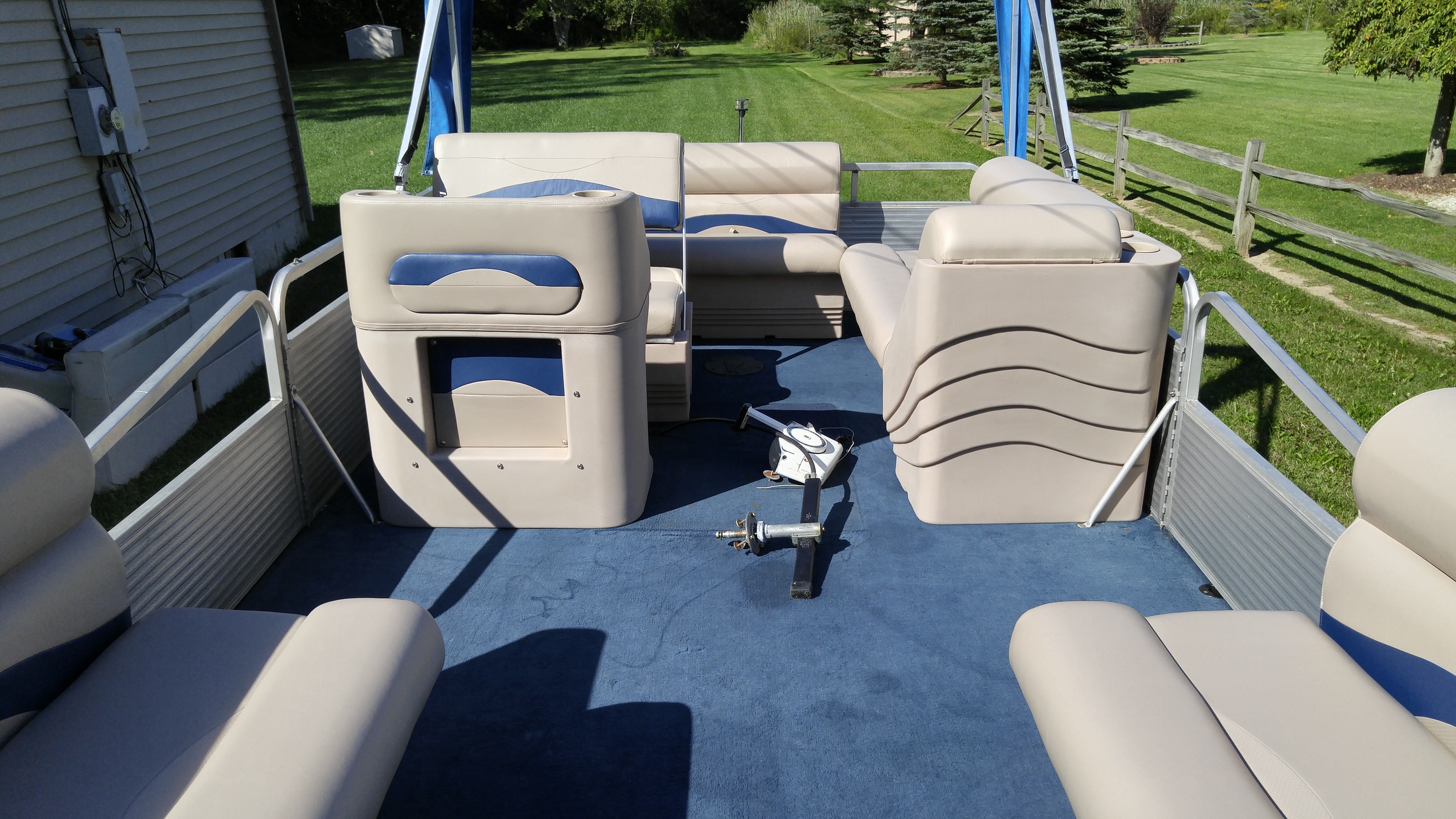

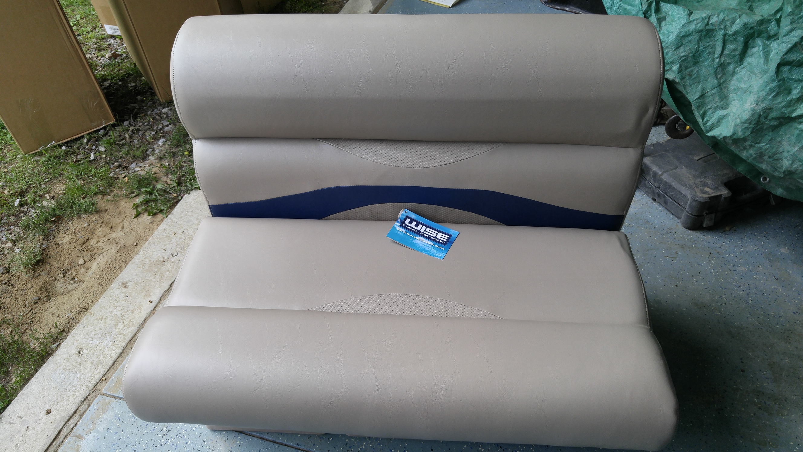

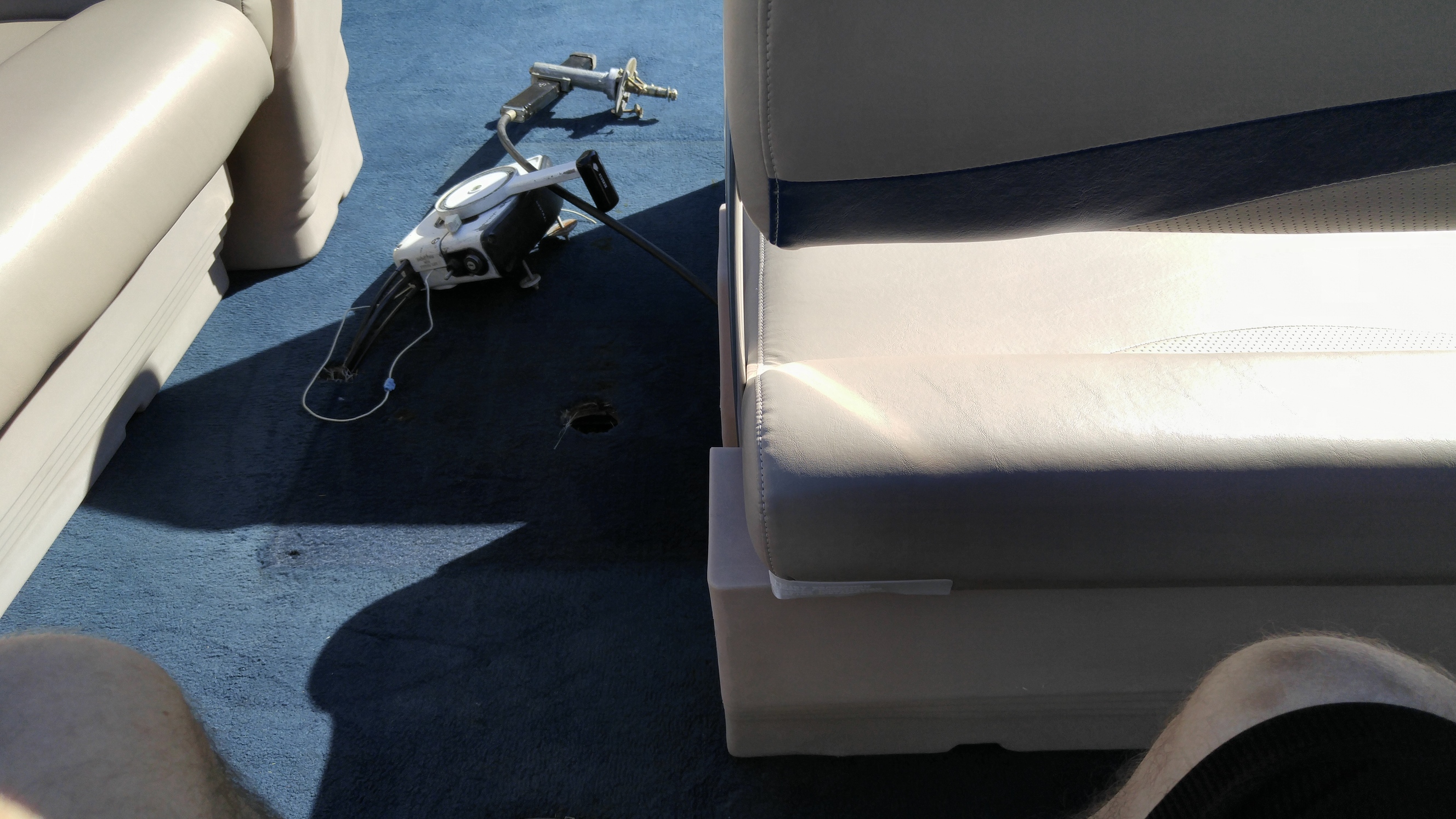

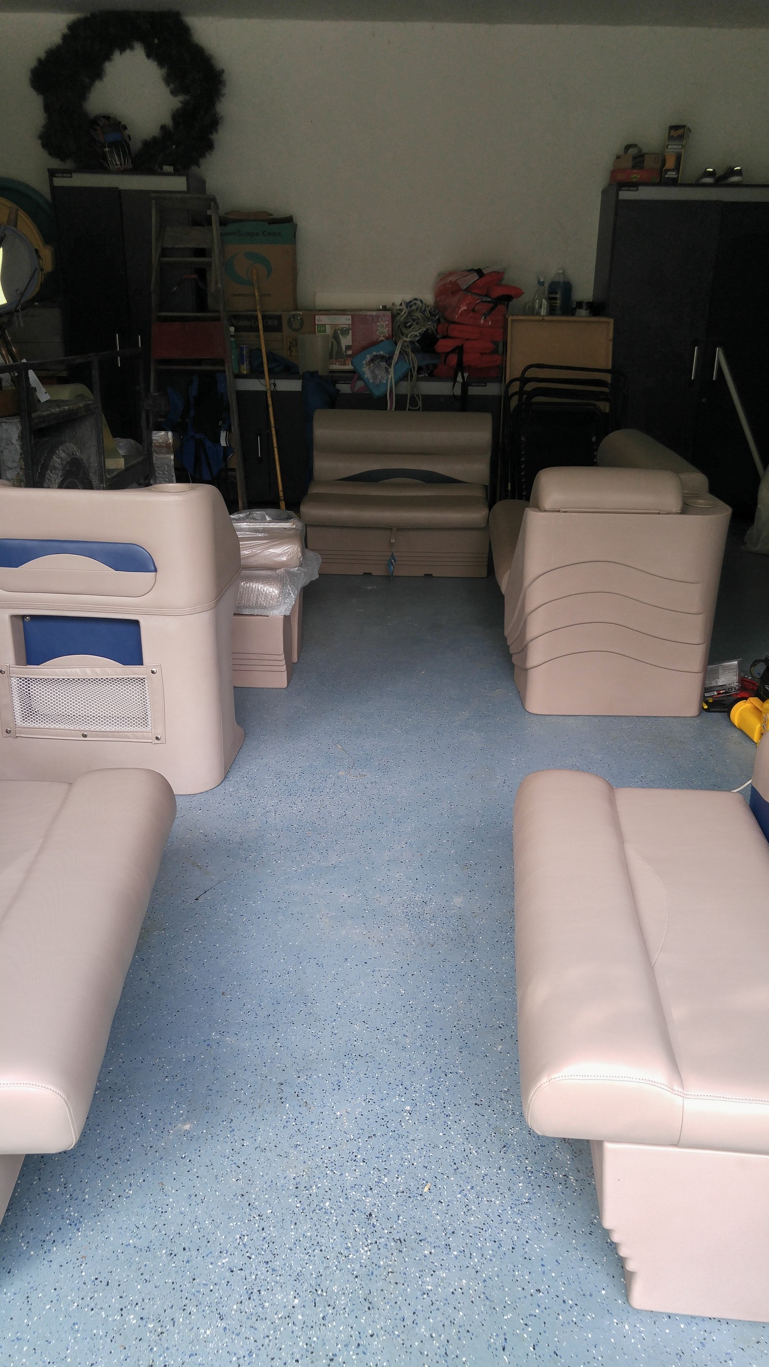

Fitting the seats and playing with location. Still waiting on the rear corners. It's going to be cramped in the seat behind the helm. Oh Well. EDIT. I went out and tested and I can sit back there :D

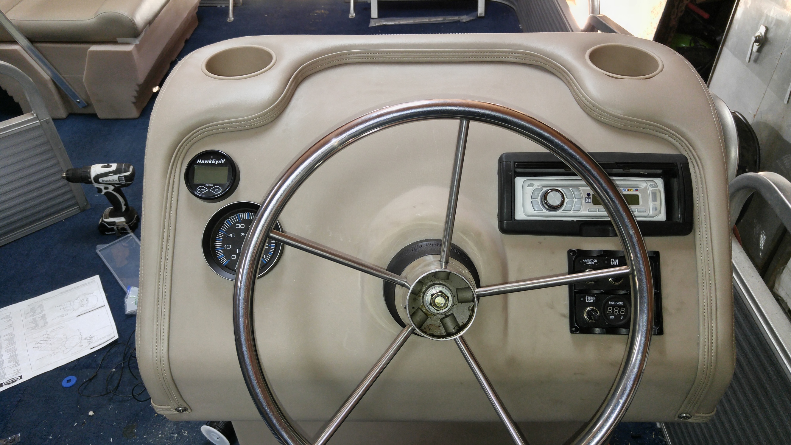

#12 Post by toondown4what » Sun Sep 13, 2015 10:03 am

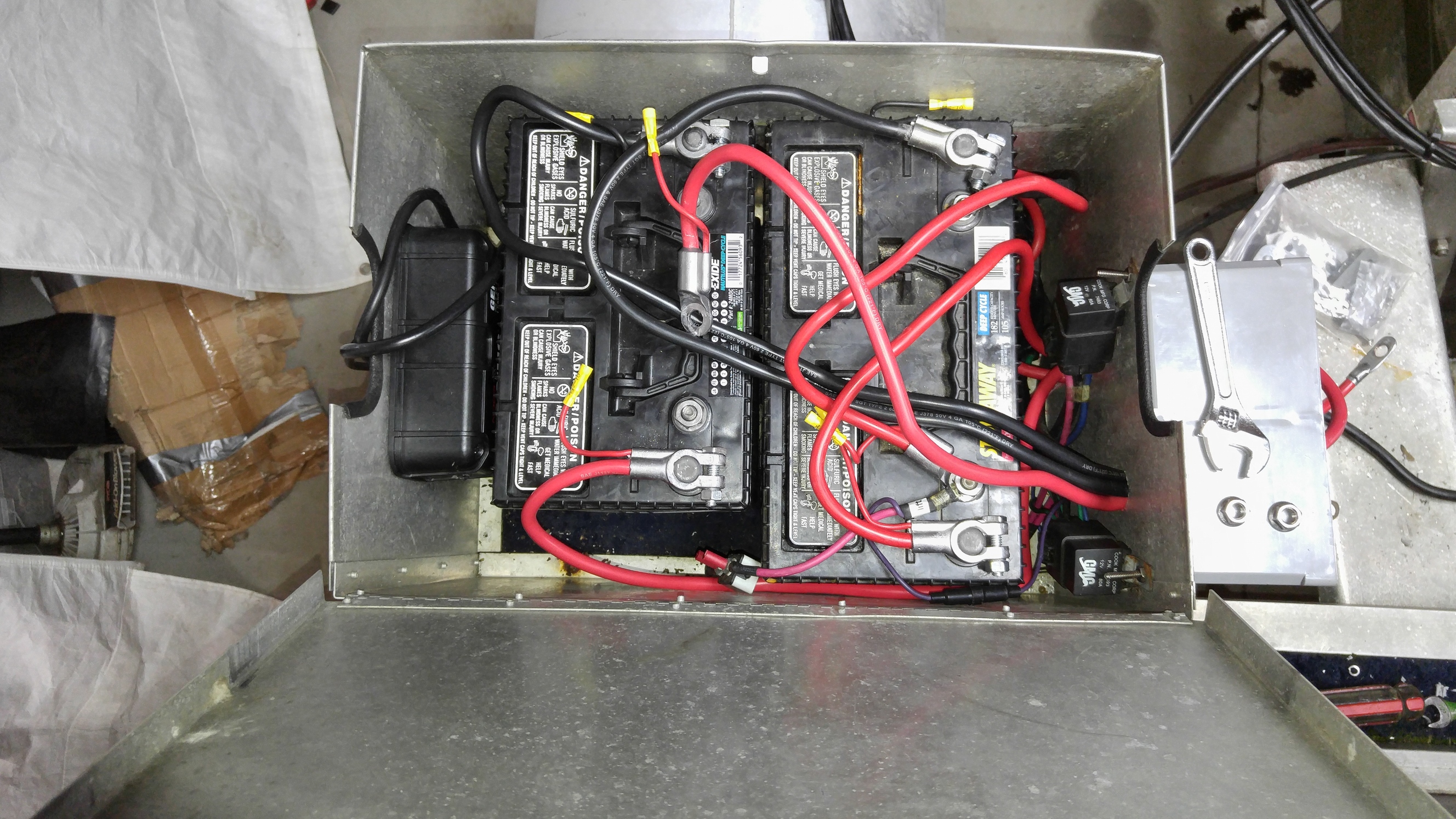

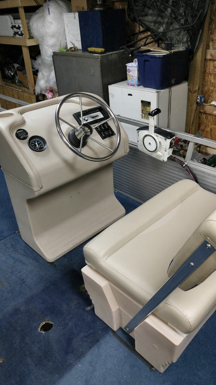

All of the "Hard work" has been completed. Steering, Controls, Gauges, All New Wiring, 2nd Battery and Add a Battery system.
Next up filling the holes in the floor, New Prop, Service lower Unit, Install Furniture and hard mount.

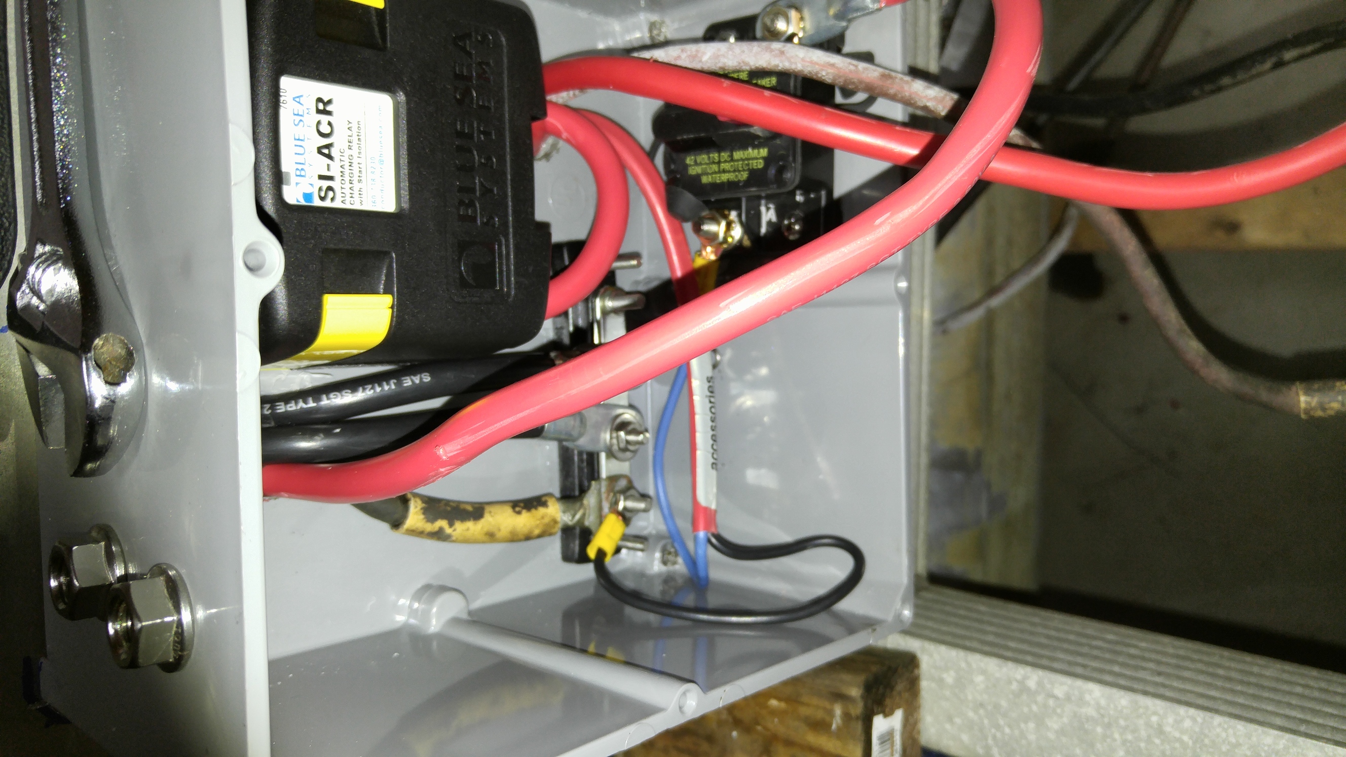

#13 Post by toondown4what » Mon Sep 14, 2015 7:06 pm
Almost done. Everything is wired and tested. adding the 2nd battery and the add a battery kit was a full day task. Moving the console from the center presented a challenge in how to cover the 3 holes underneath it, My solution was to fill the holes with water proof wood putty and then cover them with painted door knob protector wall plates. All I have left to do is ziptie the speaker wires under the boat, Add a couple more bolts to the console, Install the remaining seats, Cut out speaker holes and install speakers. I expect the boat to be back in the water tomorrow.

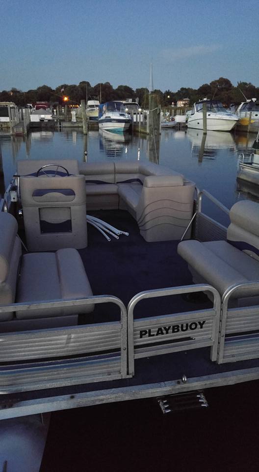

She's back in the water :)
