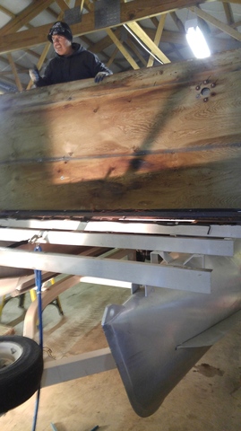

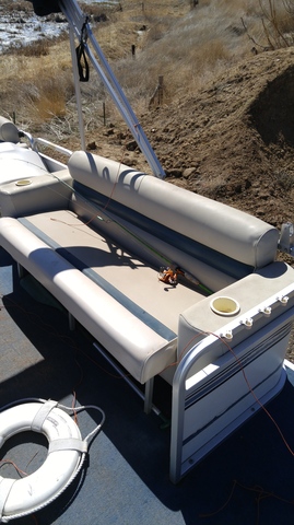

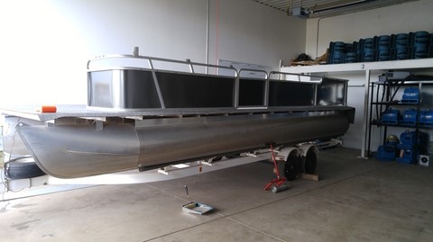

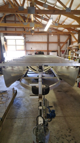

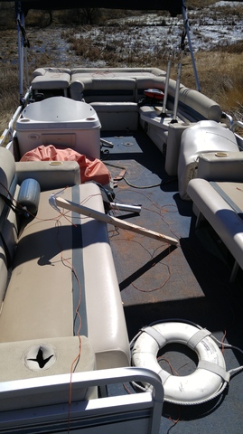

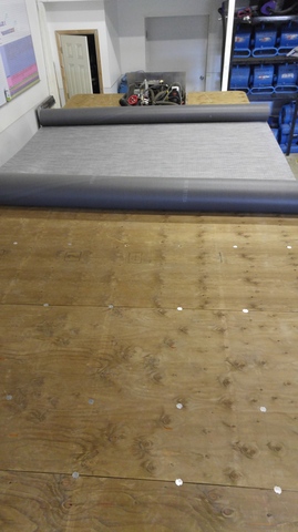

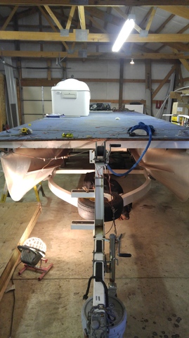

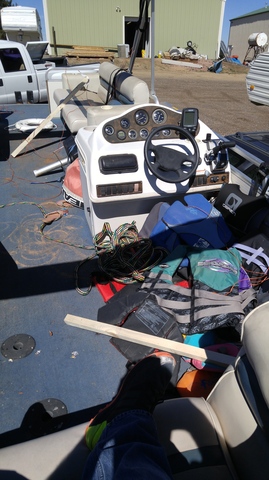

Finally got some pictures to upload. Hopefully they load in the order of sequence! Still plugging away but getting very excited!
- cG9IGE.jpg (66.67 KiB) Viewed 11440 times
- SGvnn0.jpg (77.44 KiB) Viewed 11440 times
- Vinyl getting ready to get laid
- YUUC9f.jpg (77.39 KiB) Viewed 11440 times
- 88Vbj9.jpg (106.85 KiB) Viewed 11440 times
- Wm0LSf.jpg (85.19 KiB) Viewed 11440 times
- Franky my 1 yr old Rottie "Helping out"
- RQNF6R.jpg (100.44 KiB) Viewed 11440 times
- b0uHkF.jpg (96.38 KiB) Viewed 11440 times
- NFreg6.jpg (106.8 KiB) Viewed 11439 times
- xe7Kh3.jpg (111.74 KiB) Viewed 11439 times
- The day I started to tear this baby down!
- Iqw42t.jpg (104.15 KiB) Viewed 11440 times

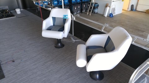

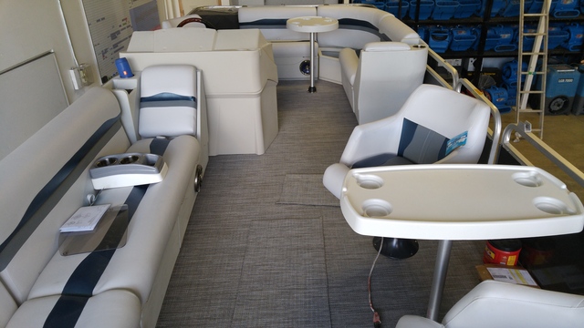

Project is coming together! I'm loving it
- EShQoL.jpg (124.92 KiB) Viewed 11317 times

Re: 1998 Aqua Patio Rebuild
nice! What brand furniture?
