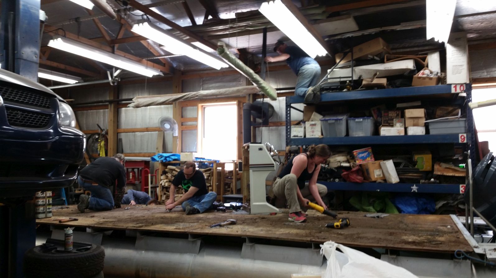

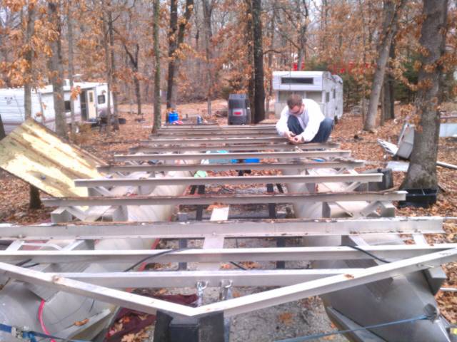

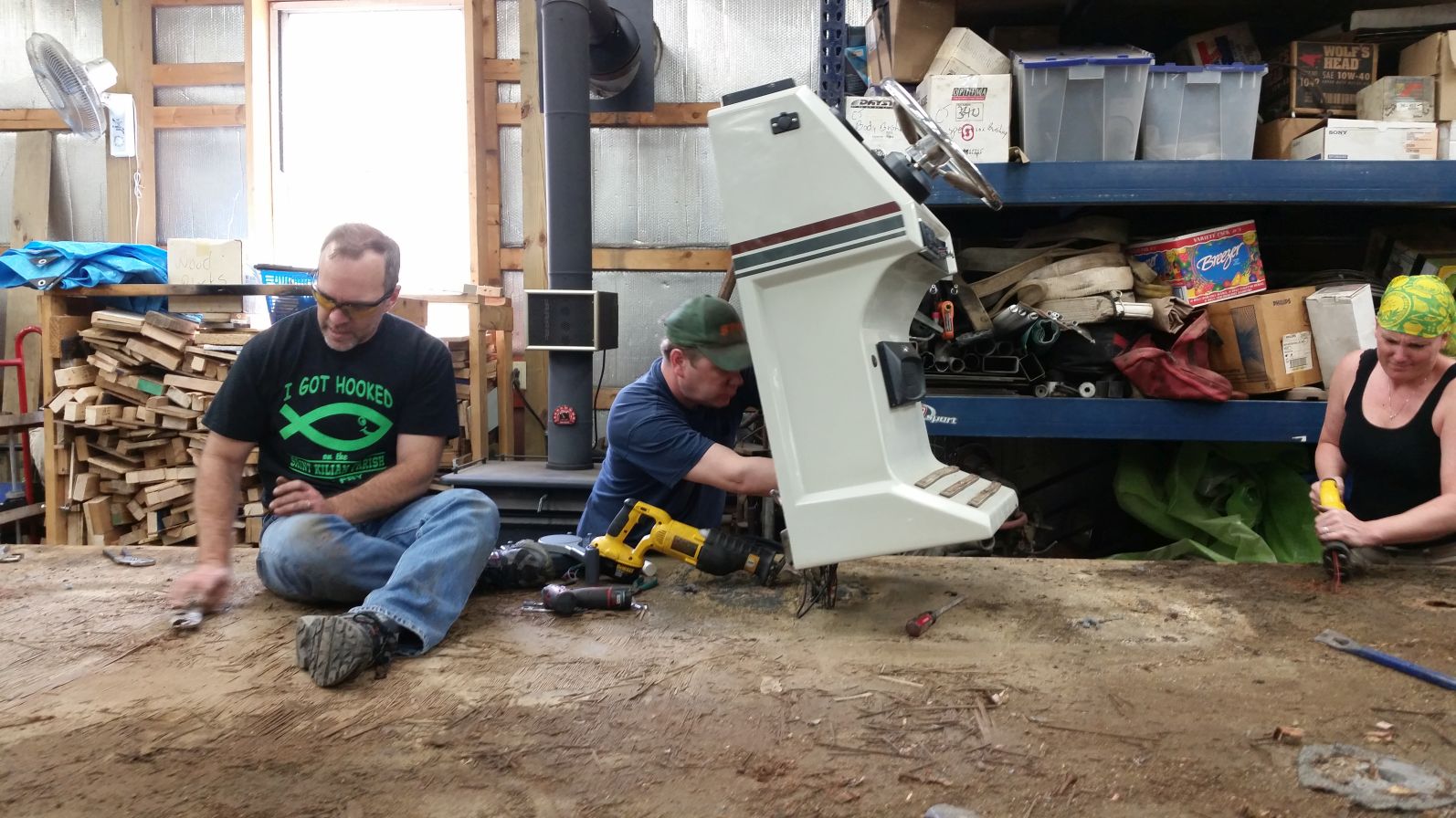

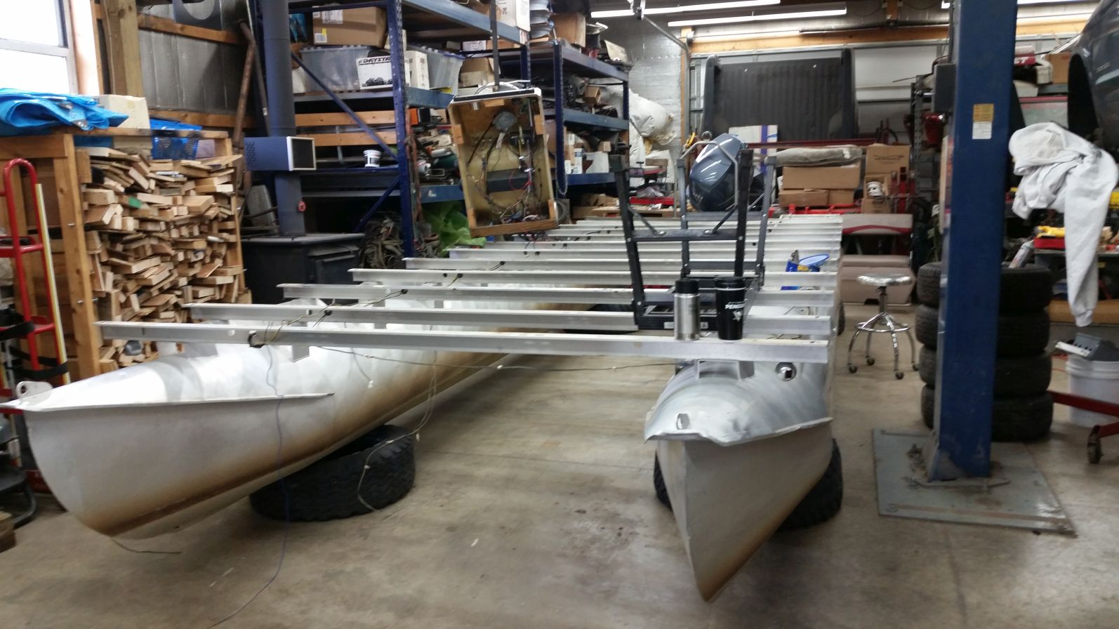

- down to frame
- rebuildtoon21.jpg (214.41 KiB) Viewed 20865 times
- removal2
- rebuildtoon22.jpg (206.55 KiB) Viewed 20867 times
- removal1
- rebuildtoon23.jpg (263.29 KiB) Viewed 20866 times

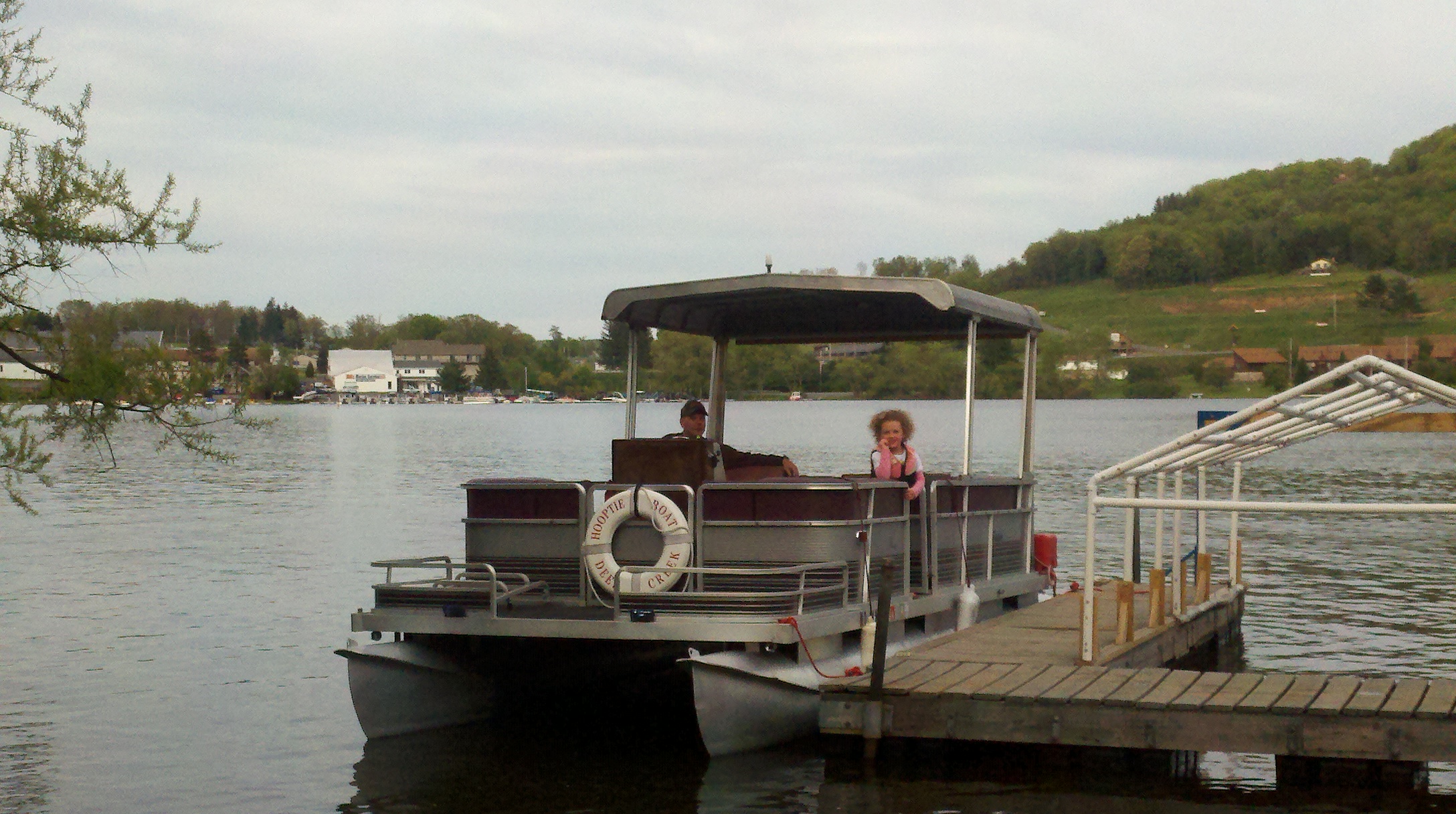

- Picture of the boat from a few years ago
- oldpic.jpg (940.78 KiB) Viewed 20869 times

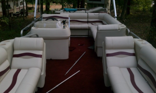

welcome! good luck at least you have a garage! We did ours outside! ask away with questions.
- IMAG0335.jpg (72.6 KiB) Viewed 20811 times
- IMAG0173.jpg (118.73 KiB) Viewed 20811 times

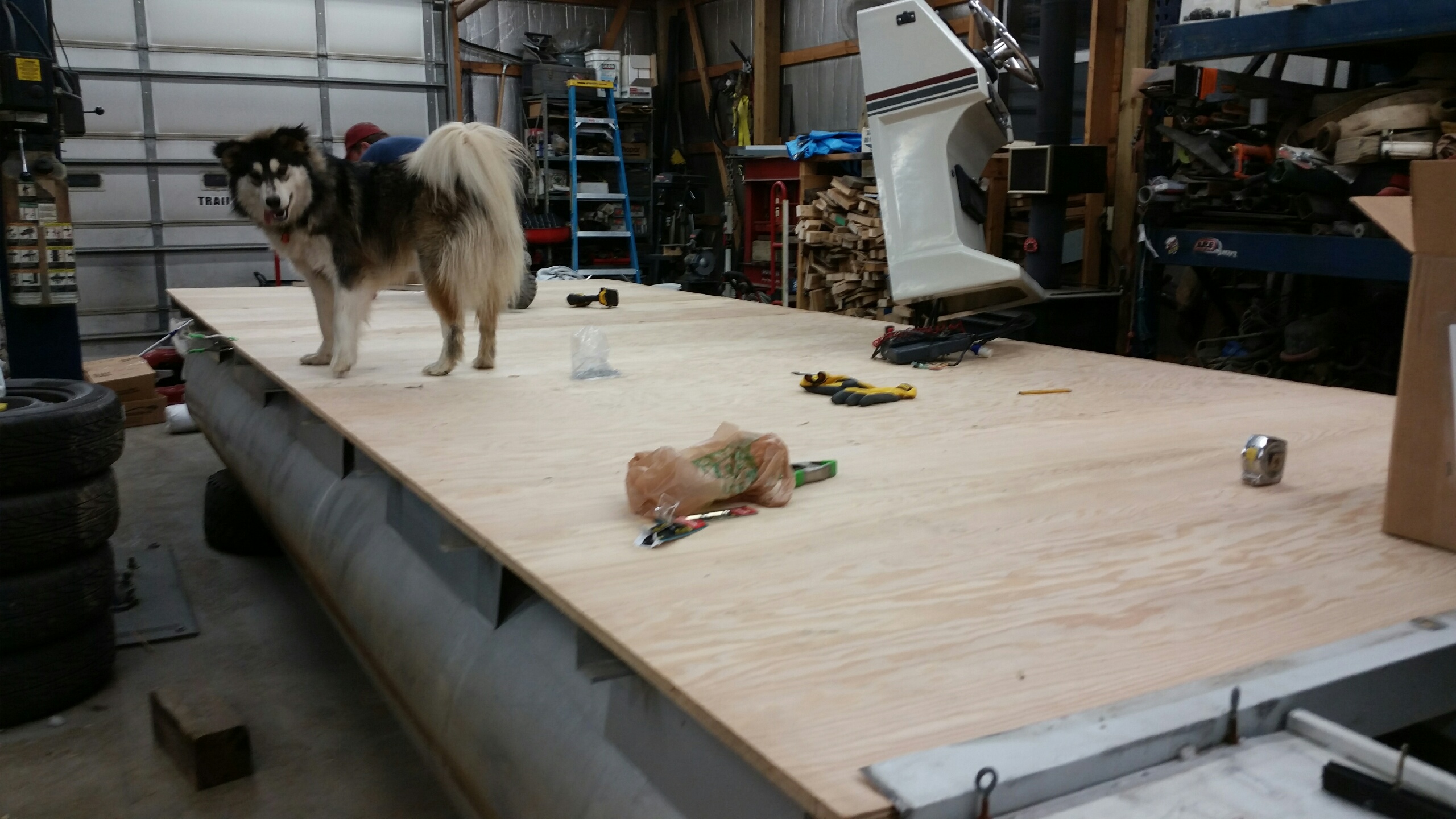

Re: 1985 Harris Flote-Bote rebuild
Some progress... marine plywood is down and after some touch up sanding..., the vinyl flooring has arrived and is next on the agenda
at least the dog knows how to dry boat!

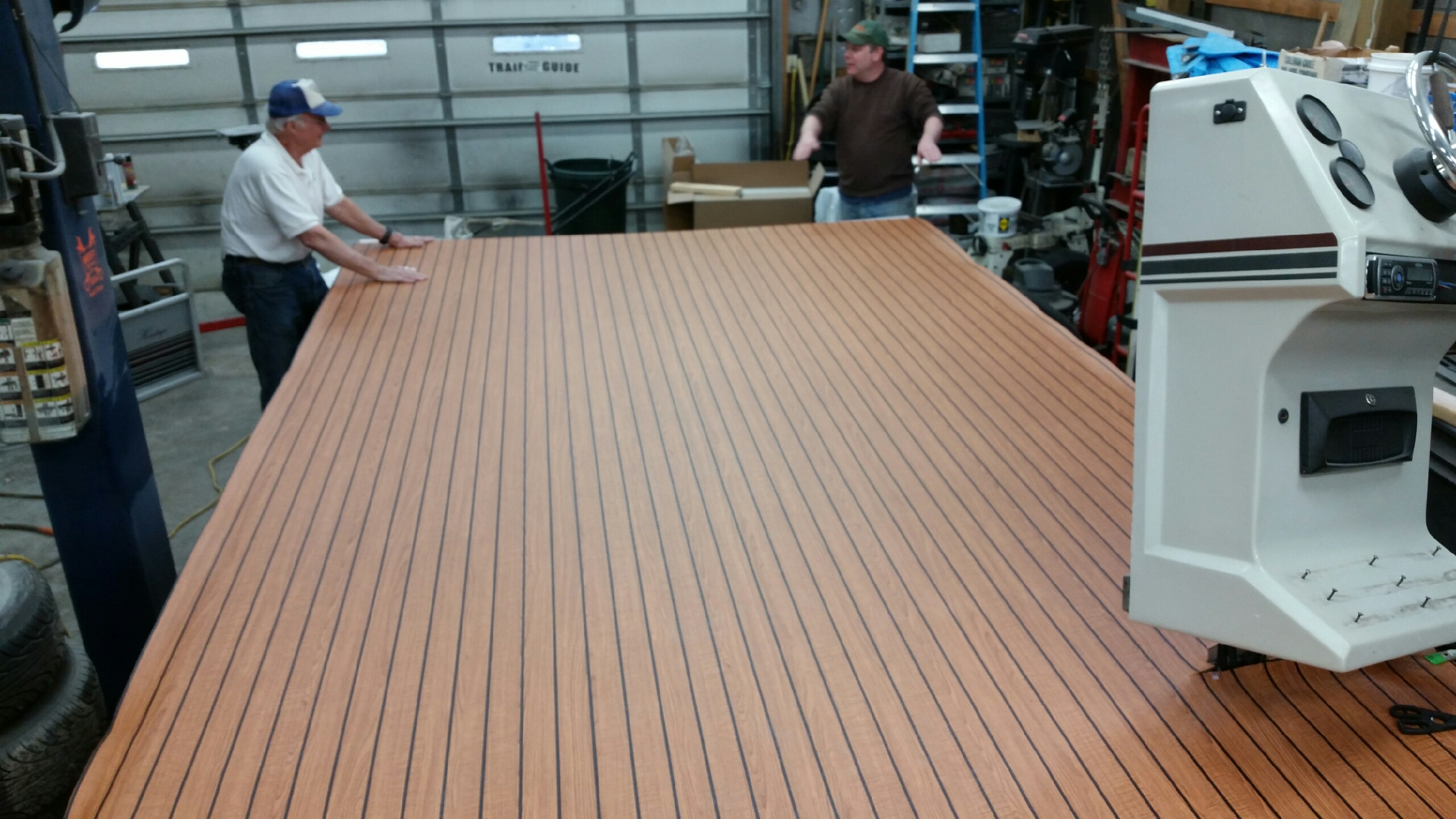

Mari deck "teak" vinyl is down
- 20160413_181418.jpeg (926.49 KiB) Viewed 20607 times

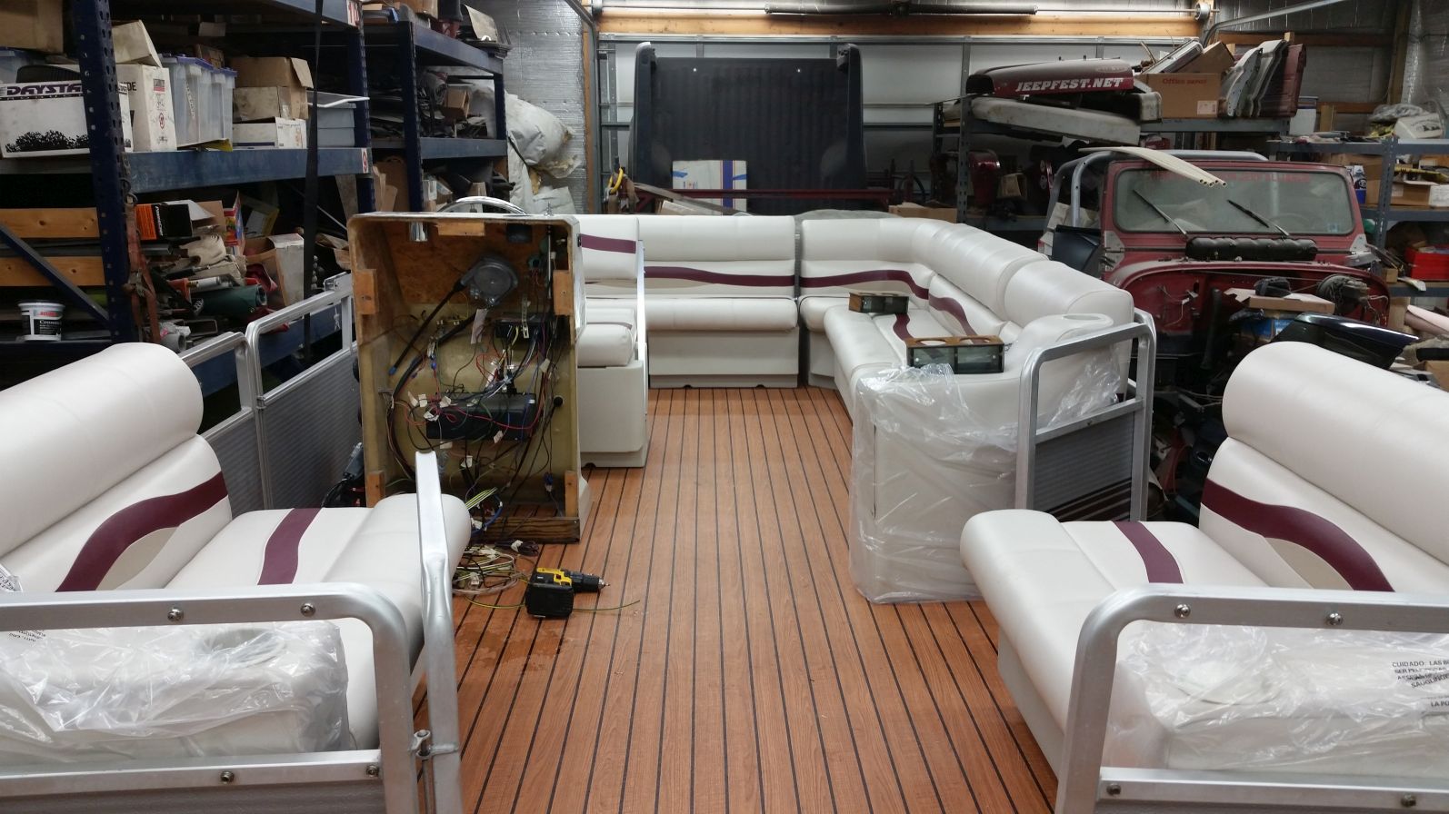

seat mockup. (pic was big and my friend was making a funny / not very flattering face, so a revised pic is 2 posts down)

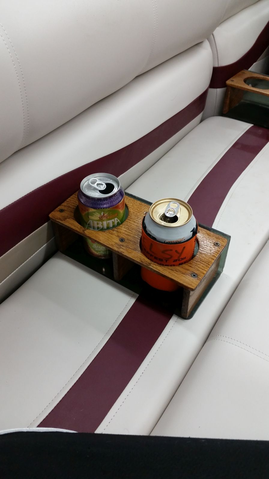

Revised seat mockup picture... and "repurposed" cupholders from previous furniture lol
- rebuildtoon32.jpg (237.94 KiB) Viewed 20441 times
- rebuildtoon31.jpg (120.25 KiB) Viewed 20439 times
Great job. It's looking terrific!
It looks really good.. man, I love that flooring... beautiful.
