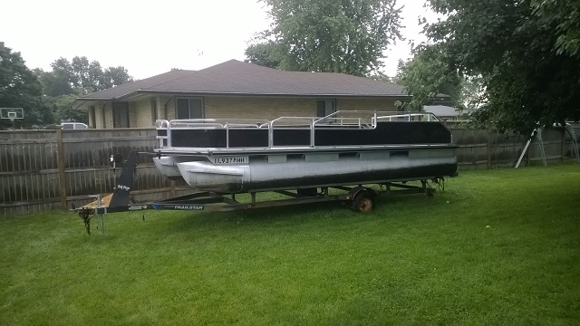

This is after I tore off the seats and rails.
- NCM_0066.JPG (145.48 KiB) Viewed 12729 times
- NCM_0065.JPG (136.22 KiB) Viewed 12729 times

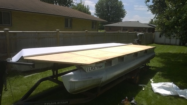

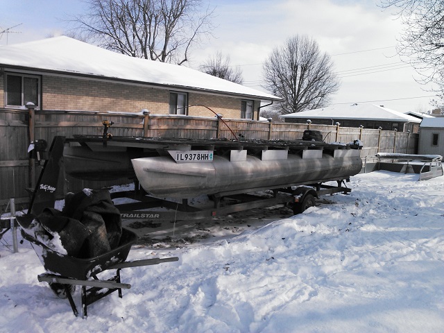

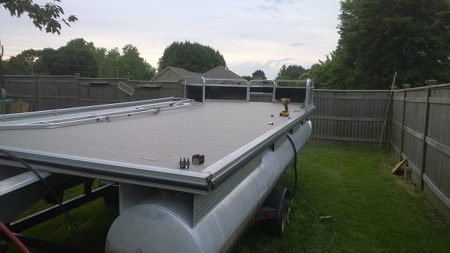

Here are a few as it went along. For the final product, I'll have to move them from my phone.
- 1023.jpg (87.38 KiB) Viewed 12722 times
- 840.jpg (99.37 KiB) Viewed 12725 times
- 818.jpg (124.41 KiB) Viewed 12723 times
- 816.jpg (104.63 KiB) Viewed 12722 times
- 810.jpg (109.66 KiB) Viewed 12725 times

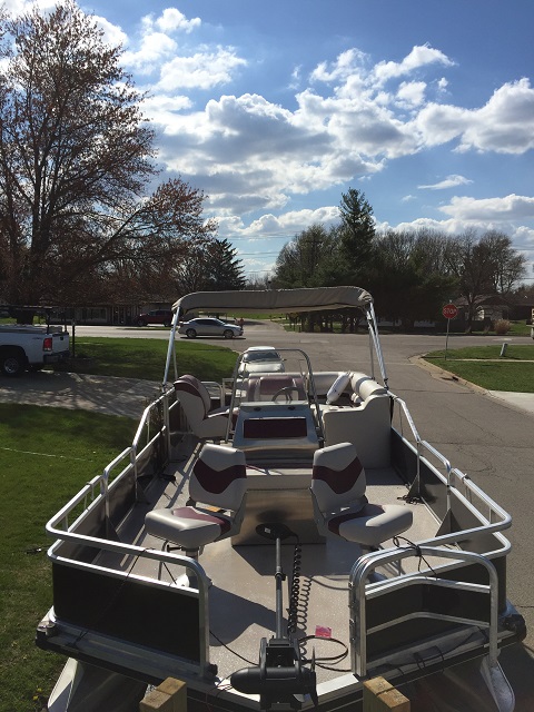

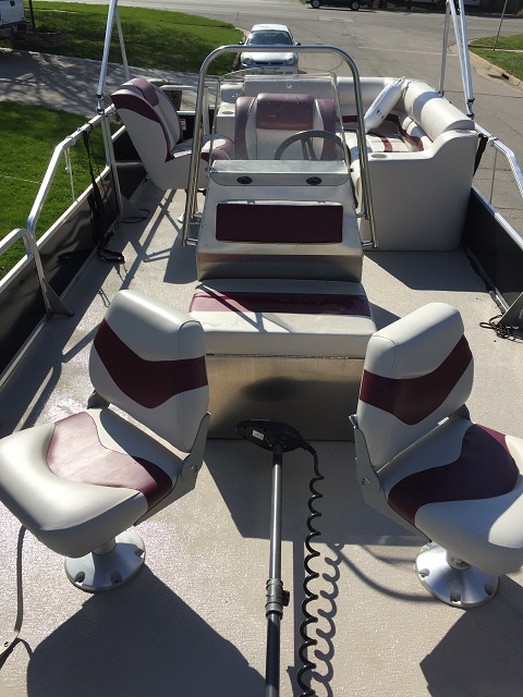

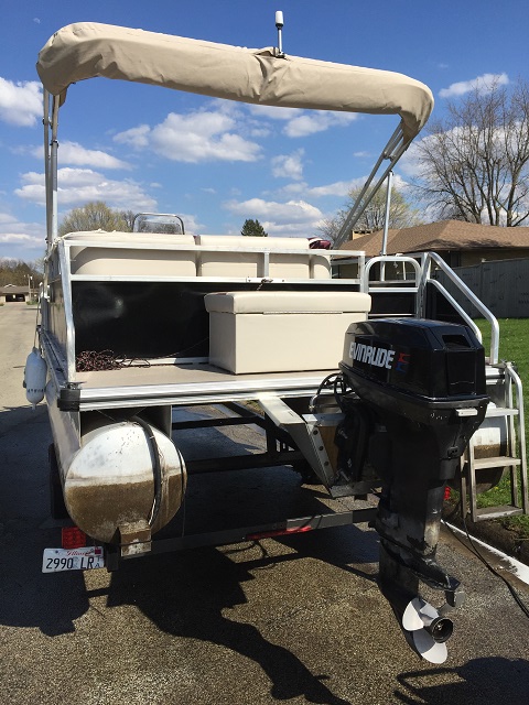

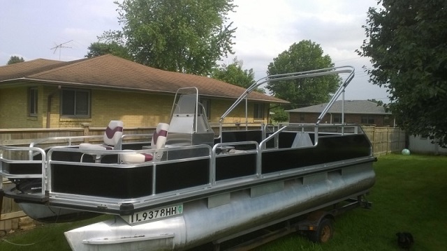

Got a few pictures of it, done. They were floating around in the cloud for about 3 hours.
- IMG_1153.JPG (158.23 KiB) Viewed 12631 times
- IMG_1152.JPG (145.55 KiB) Viewed 12633 times
- IMG_1151.JPG (130.96 KiB) Viewed 12634 times
Re: Bass Buggy done. Thank you.
Looks great !
The vinyl is the way for a fishing rig for sure!
