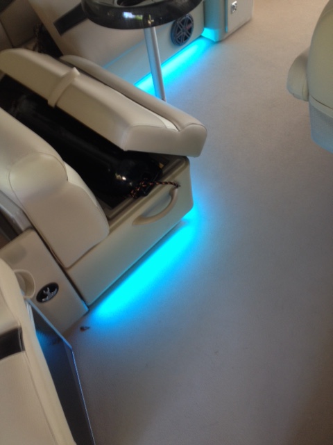

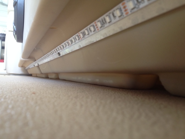

I bought mine off of Amazon also and then went to home depot and purchased some aluminum flatstock that I attached the strips to.
Here's a short video - https://youtu.be/Fl3LhrNAtaw

Re: LED light Strips...
That looks awesome!! Thanks... Hope mine look half as good.:.

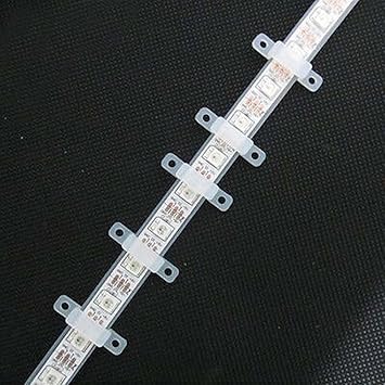

What about these? Not sure if the sticky backs will adhere well after time.

[quote="COTTS4x4"]I bought mine off of Amazon also and then went to home depot and purchased some aluminum flatstock that I attached the strips to.
Here's a short video - https://youtu.be/Fl3LhrNAtaw[/quote]
Question:
What made you decide to sort of stick them to the side, instead of sticking them to the top? Of the area in the pic. I like the way your pic of the light looks, but I don't want to be able to see the source of the light. I want it to be diffused, much like yours seems to be. I was thinking if you hung them from the ledge there, (which does look like they'd fit underneath there) that there would be no chance of being able to actually see the LED's themselves.
Question:
[quote="photonfanatic"][quote="COTTS4x4"]I bought mine off of Amazon also and then went to home depot and purchased some aluminum flatstock that I attached the strips to.
Question:
What made you decide to sort of stick them to the side, instead of sticking them to the top? Of the area in the pic. I like the way your pic of the light looks, but I don't want to be able to see the source of the light. I want it to be diffused, much like yours seems to be. I was thinking if you hung them from the ledge there, (which does look like they'd fit underneath there) that there would be no chance of being able to actually see the LED's themselves.[/quote]
That ledge isnt as wide as it looks in the pics, and the seats had molded spots that stopped me from going any higher than where they are now. Plus I didnt want any gaps between the seats and the way I did it allowed me to make solid strips. You would have to get on the floor to see the light source.
Question:
