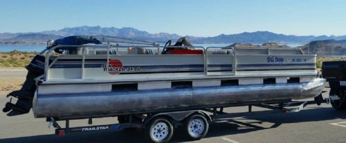

I just used the Napa Aluminum Brightner spray it on and let it sit for 30 seconds and rinse it off it is amazing stuff below are pictures before and after using it it will lot polish them but brightens it up lotTim

LOL I only had pictures of the original, before we finished the rebuild,Tim

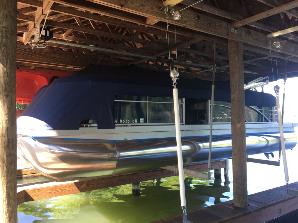

OK, You got me to bite........ I helped my lake buddy on HIS tri-toon this past week, as he needed it first, and I'll attempt ours late this fall.
We used the White Diamond polish on the Porter Cable machine with several foam pads...... as it took 4 hours for one outside toon, on the other side, we used an orbital sander first to help knock down the heavy stuff. Still spent another 4 hours on that toon too. We're NOT looking for mirror shine, just clean and shiny.
Haven't even gotten to the center nose cone toon......
We're committed to finishing this boat, but we're at least 8 hours in, with 2 of us working........ 16 man hours.... we must be doing something different than you were able to accomplish in an hour or so. I was the one to talked him into this saying it was a couple of hours total, with just the white Diamond.....
Not sure what path I'll take when it comes to cleaning our boat. Maybe I'll try the Zephyr polishing pads and rouge, or just the white diamond on the porter cable.
here's a couple of pics of what we've got so far.

I can tell you guys really put the elbow grease into polishing that toon. It looks just great.
But I'm not looking for a mirror image--just a great shine for the amount of energy expended.
You can do the job with foam applicators, however they're really intended for polishing and waxing painted objects. Aluminum's finish is much tougher than a painted steel fender on a car.
The wool bonnet is the proper thing to use for metal polishes. It's also reusable time and time again after washing out.
Like I've said before, I put 2-3 dime size dollups of polish on the bonnet, place it on the metal finish and hit the switch--going up and down, back and forth for about 90 seconds. The black oxide paste suddenly dries up and mostly blows away in the wind. I wipe it down with dry towels.
If I was a glutton for punishment, I'd be using my high speed buffer and the edge of a cotton round pad with rouge to polish the toons--like they detail heavy truck fuel tanks. But I'm just not willing to work that hard to maintain that near mirror image.
