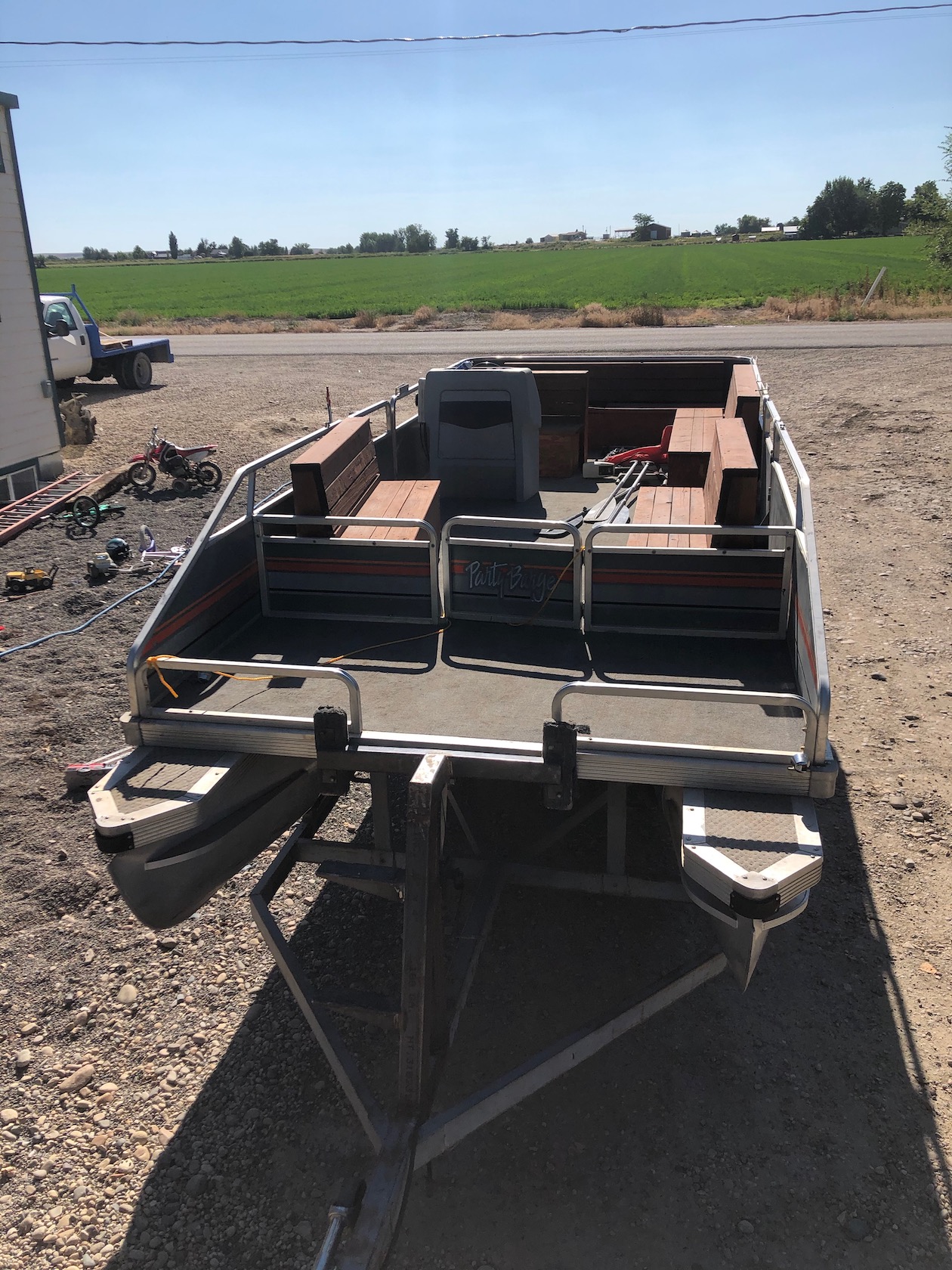

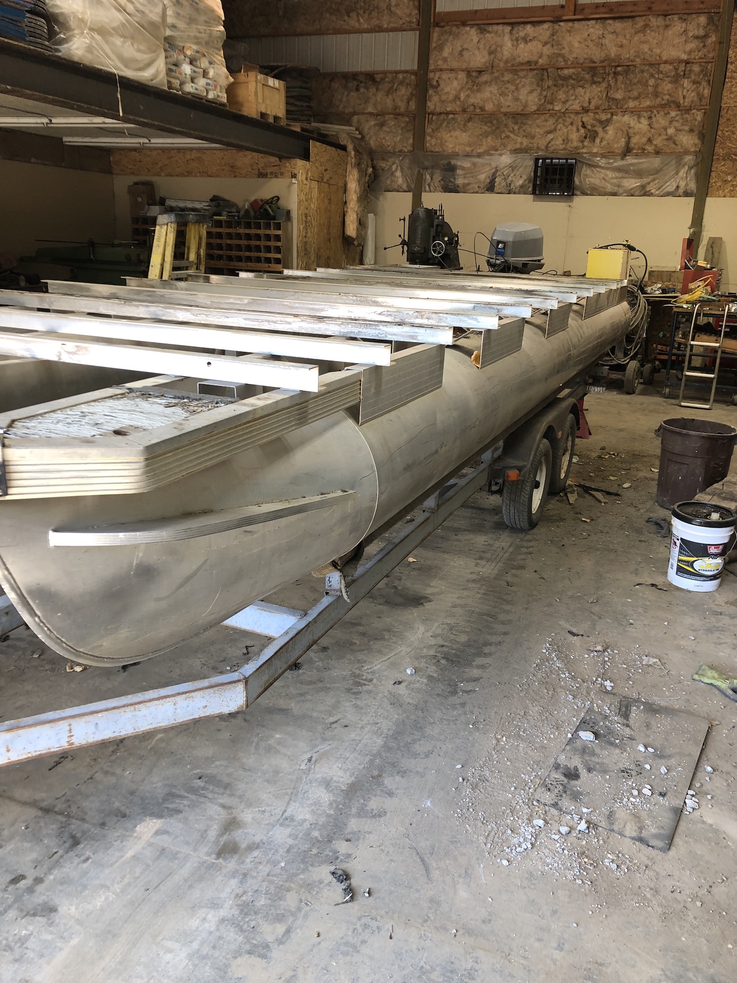

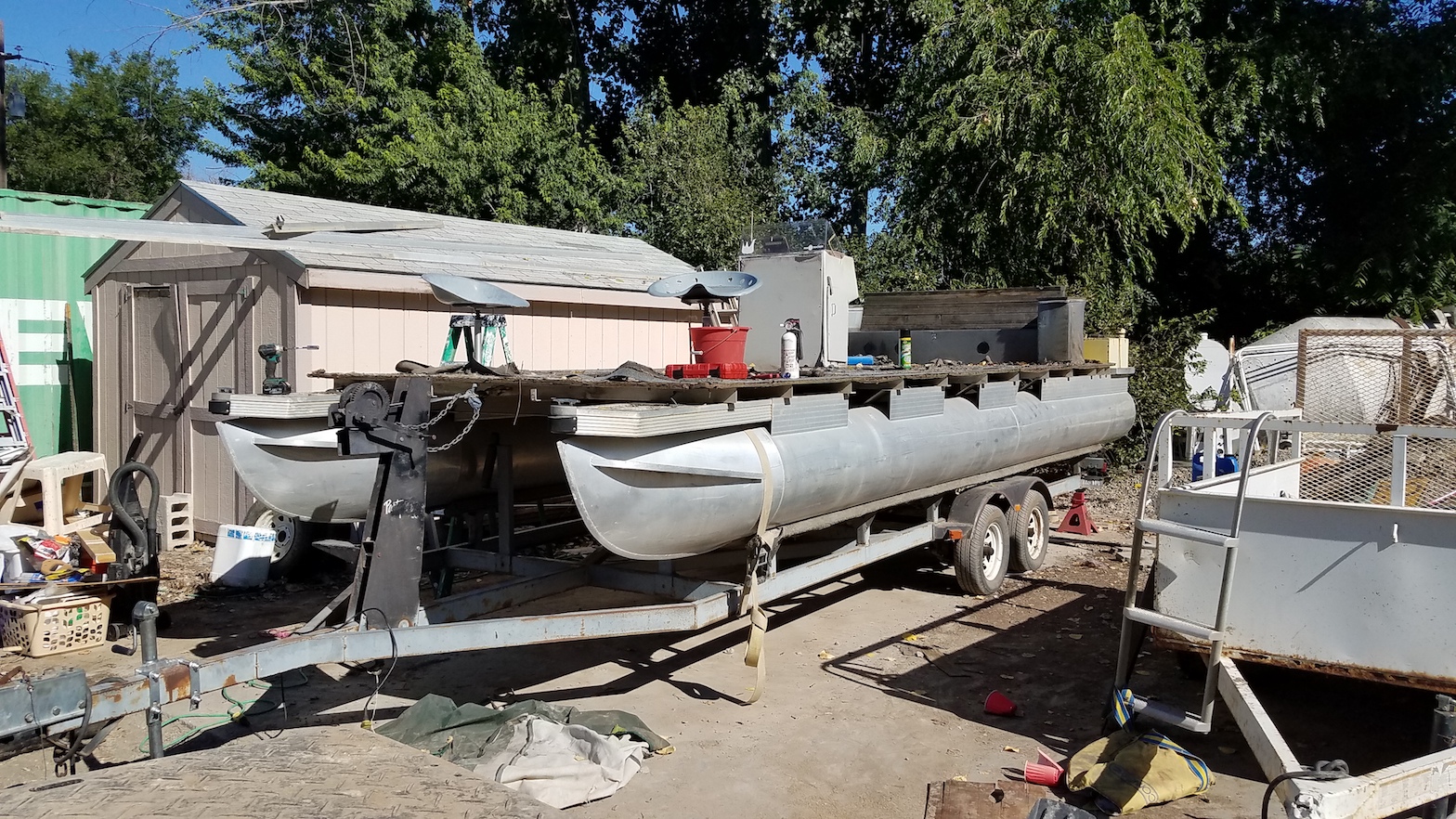

I dont know, I usually overthink everything and take to long. I guess if it doesn't last I can always redo it. anyway here is some pics I got super helpers.

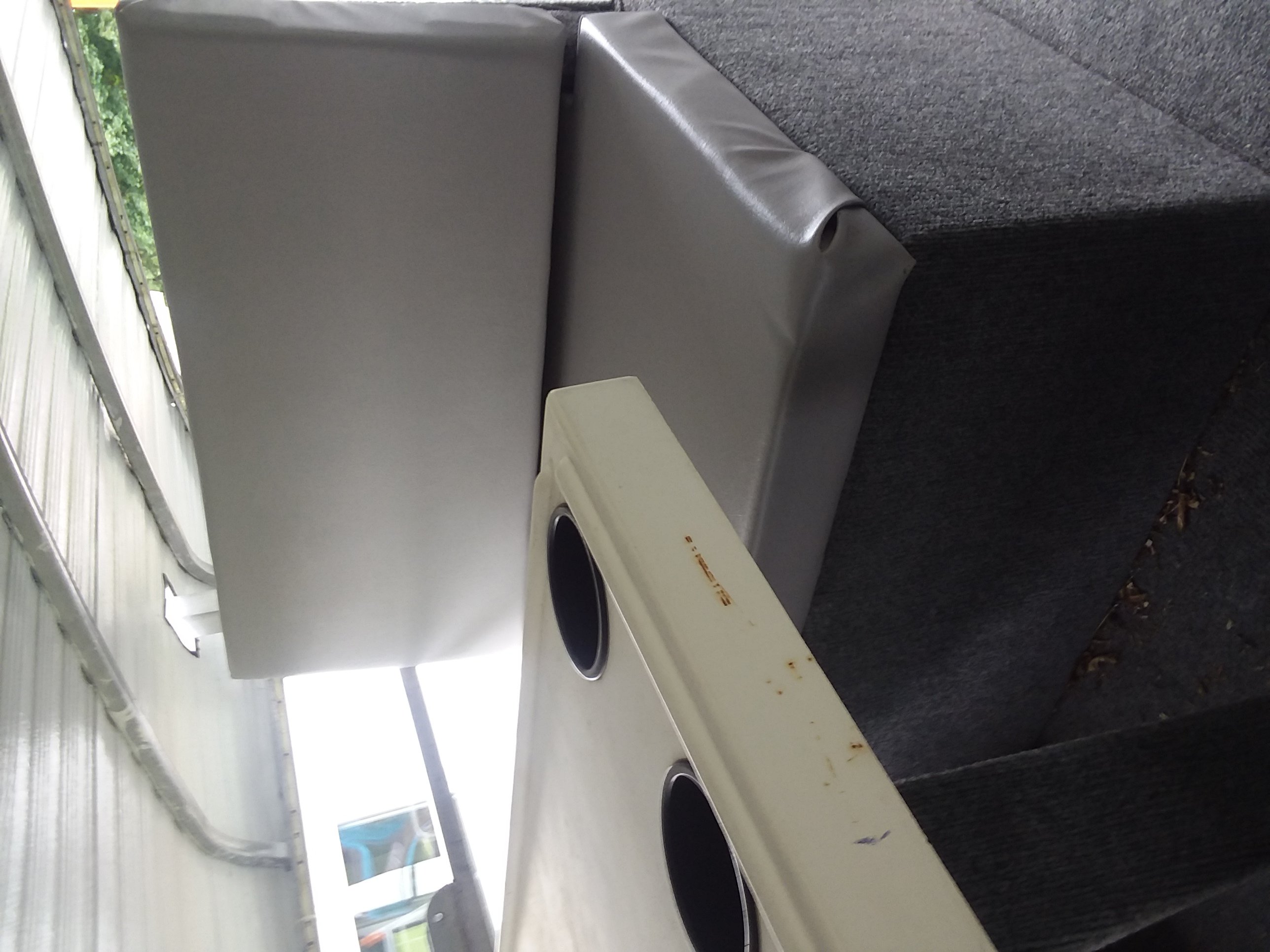

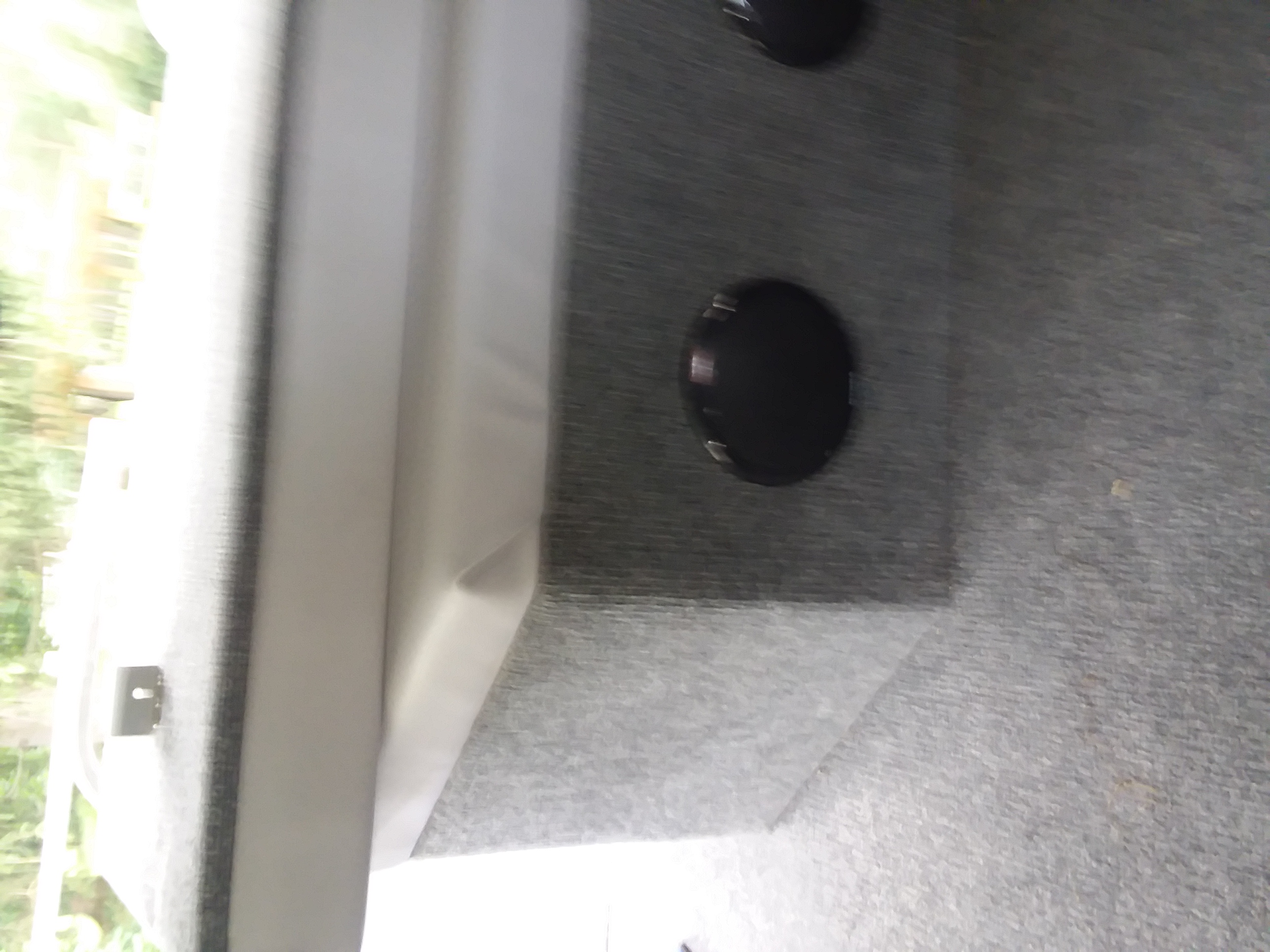

When we rebuilt ours on a budget,we used pressure treated plywood and 2 x 4s, 2 x 2s for seat backs and bases,console, foam cushions and marine vinyl coverings, but only up to the console, plastic lawn chairs in front, saves weight, stack out of the way, easy to put where ever you want. We have plenty of storage under seats for 3 anchors/ropes, 4 life preservers, that kind of stuff, 2 batteries and battery switches, ropes, umbrellas for extra shade. Under console we store 4 more life preservers and tools, flares, first aid kit. So I guess what I am trying to say is plan it out, mock it up in cardboard if possible, see how it looks.If I can get some pictures I will post.

Hope these give you a little idea of what we did. Our roof is on posts so we can slide it up and down, down to trailer and pinned in place. that is why the seat back in one picture is laying down otherwise it hooks onto the rear rail top. rear seat is about 6 foot wide, table is about 3 ft long by 2 foot wide, front bench is 3 foot wide, we have a changing room/bathroom over rear toon, that's why seat is not width of boat.
