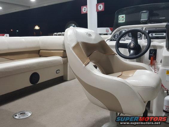

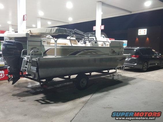

I was looking for a fishing oriented model but this deal and boat were just too nice. As expected, it is not a very convenient boat to fish from. The layout is similar to this (I don't have good full framed pics at the moment so this is a stock image):
The big difference between the pic and mine is that there's a little more open deck past the front fence and no seat covering the gate. The sundeck is all the way fully to the rear. There's a lot of deck but the seating and sun deck absorb all the good fishing points.

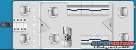

Anyway, the entire deck of the toon is going to be replaced and fitted as a fishing vessel. This is a rough layout of what I intend to do. I would like to get thoughts and opinions, tips and tricks because I've never actually done this before and I'm sure there is a lot of great experience here at the forum.
That's the PontoonStuff website's designer. The four stacked armrests in the rear are a placeholder for a fiberglass livewell/storage console that the gas tank will be under. Looking forward to hearing thoughts on what I may be doing badly and/or missing. Thanks!
