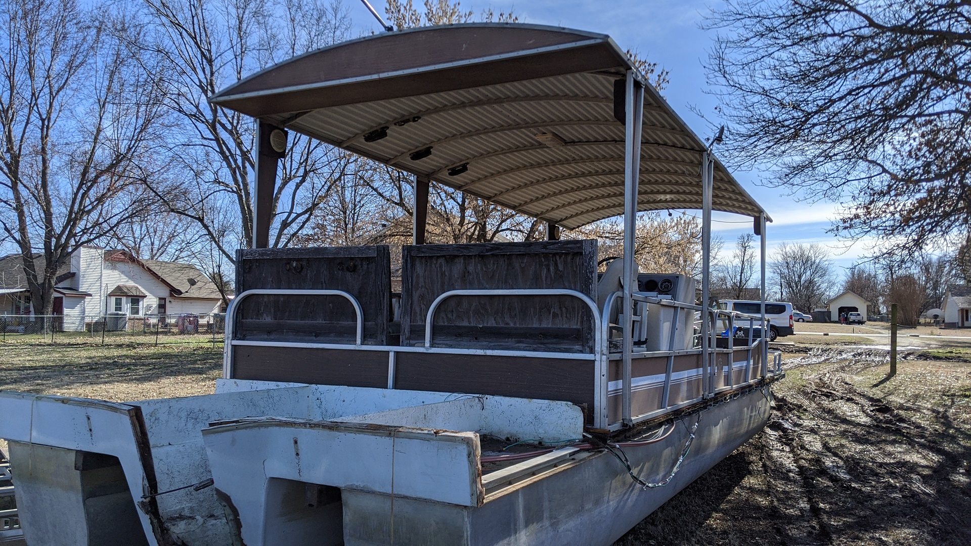

Hello! So I have this big ole pontoon project and I plan on making it sort of a dual purpose boat, part serious fishing guide quality boat \ family pleasure boat. In the end I plan on having a new 100HP Honda outboard, maybe a tri-toon, maybe just a pod w/fuel and a transom. I plan on making it a center console boat with a 50 gallon bait tank on board (I already have one). I know I need a large livewell (around 80 gallons) but I'm not sure what to build it out of, or where to place it. I also plan on having a loading ramp in front, similar to a ramp on a large uhaul truck. I might make or buy some T-tops but I also need at least one bimini top, maybe two (one in front and one in back of the center console) I wish I could figure a way to have a swim deck like some boats have but as of yet this eludes me. This is all just a general idea of what I have in mind, I'm far from having the cash on hand to make it happen right away. A few more facts some may be interested in, I traded a utility trailer for the boat (had $400 in that) and gave the motor and outdrive away cause it appeared to be locked up, and I have a couple people interested in that big hard top so I should *EDIT* (did get $250) get a couple hundred dollars out of that, making my total investment under $400 (I did drive quite a ways to get it, and had to work on the trailer a bit to get it road ready)

Why get rid of the hardtop? Only to replace it w/t-top and 2 biminis? Build your center console and have a support system (like a t-top) to hold center of hardtop. This will let you remove the 2 center supports and give you a wide open area to fish with only 4 corner supports. If you add 2 biminis you will have a lot less fishable space. And your not going to have an 8ft wide t-top, it would crack the tubes from stress. And that would leave a lot a folks wet with 3 covers not connected or flush to each other.
I would love to have a longer hardtop for our use

On one hand I do really like the hard top for family use, but I do some serious fishing and a t-top would give me some cover without hindering fishing so much (I'd remove the bimini's for a fishing trip). I attached a pic of my last pontoon (with almost no furniture) showing my fishing rods in use. In Oklahoma we're allowed 7 rods per person, and I expect I'll put rod holders all around this new build as well.

:happy hory carp that's a lot of rods! Could you not do the same with center console full cover? Taking biminis on and off would be a pain I'd think, unless you are young :mrgreen:

I fish all year but the family only likes going in nice weather, my last boat I only had one Bimini and only used it in the summer, often when the sun went down I'd take it off and put it in the back of my truck at the ramp.
To be honest I'm not sure I want any permanent top, but the t-tops could be useful in multiple ways, and when its raining it'd be nice to stand under, plus I have in mind a plexiglass windshield of some sort, still not sure about that.
