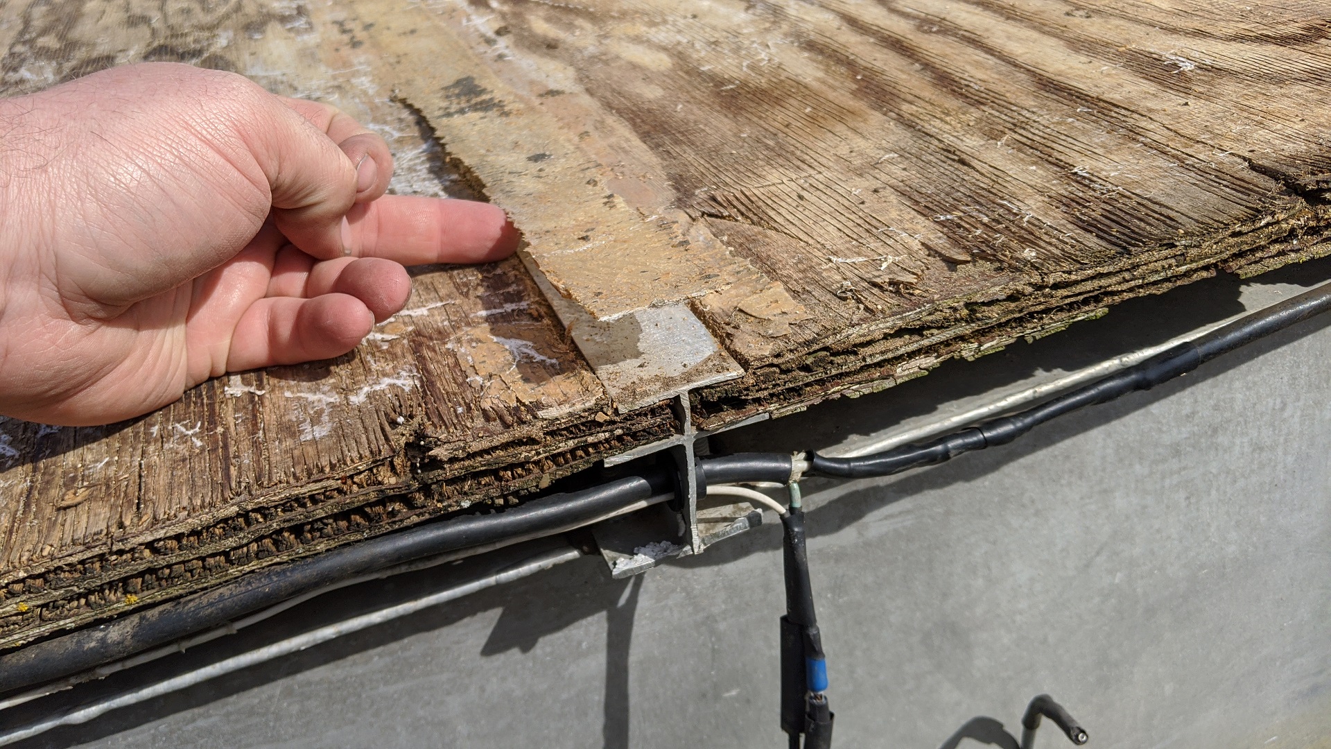

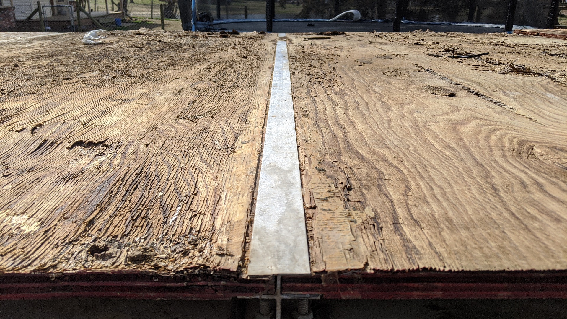

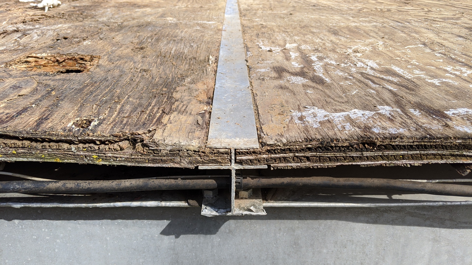

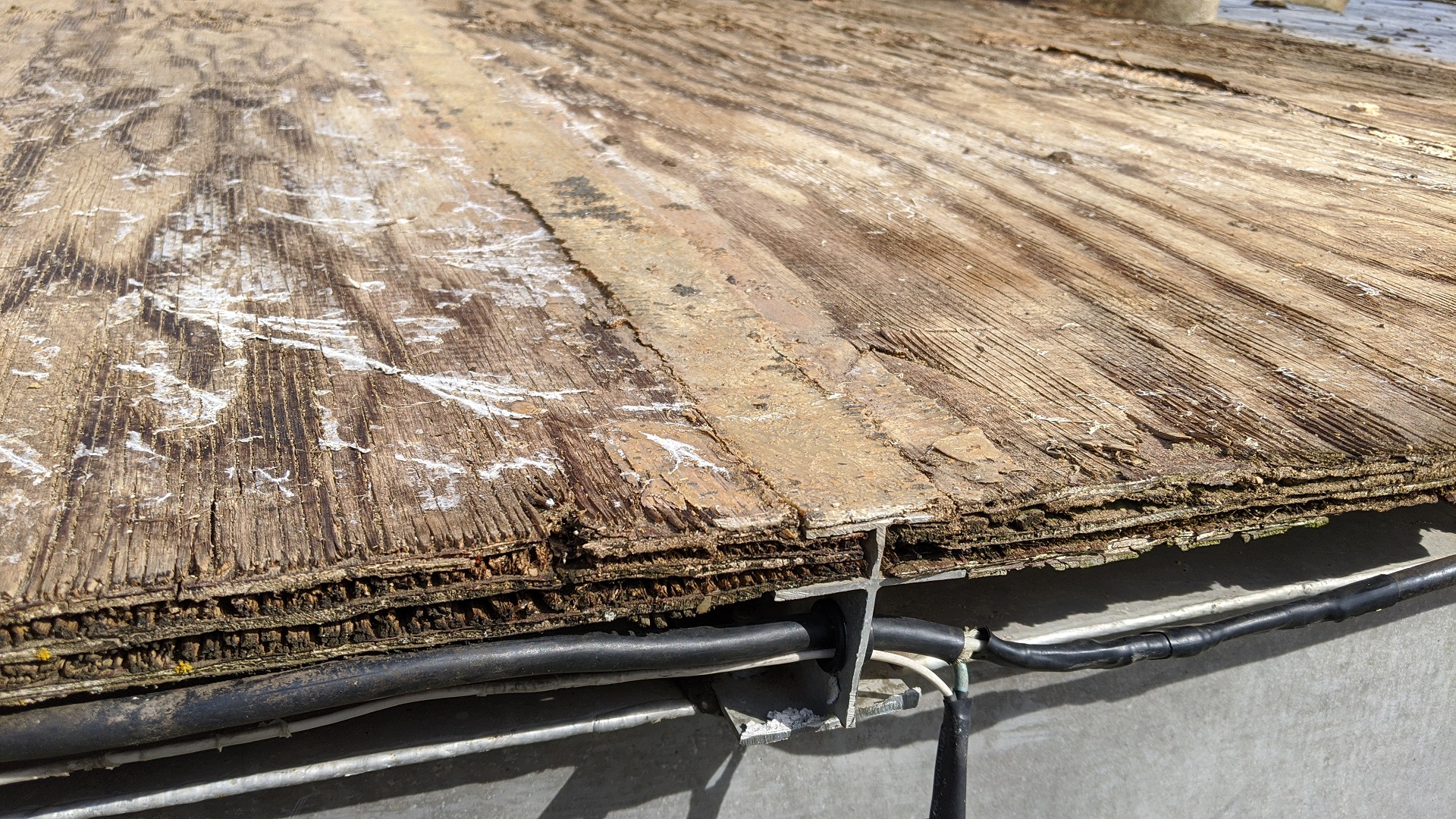

I also have a question about the braces on my boat, some of them are very unique and I don't want to re-use them as cutting the plywood to fit in the slot seems wrong, the original floor has what seems to be fiberglass strips over the top of the braces to make the floor even? not sure why they did that. Has anyone re-used this kind of brace on their boat? I have to buy some more braces anyways to replace the whole rear of the boat for the fiberglass transom I'm tearing out, figure I'll just buy extra to replace those braces.

I haven't seen them before, definitely dictates the wood thickness you need. Is that fiberglass or just old thick glue on the joint?

#18 Post by PaulinOK » Thu Mar 12, 2020 9:42 am
It has fibers in it like fiberglass but it could be glue I guess, either way that's not how I'm putting it back together

I have those same joint braces on my 07 G3. I did not re-use them. Not only are they a pain to re-use, considering the precise routing that would need to be done to fit the new plywood into them, but also the new plywood I got (from PontoonStuff) is thicker, so I would have had to router the top AND the bottom more precisely than I am likely able to. I know that any part that gets mistakenly routed too wide or too deep would very likely transfer that gap through the vinyl flooring, and since I am doing a full rebuild of the deck, a glaring mistake like that was intolerable to me.
Mine are 2-1/2" 'tall' and I got mine here. They have 8' or 12' stock lengths available and various widths of course. There may have been other alternatives but I couldn't find any stocks in 2.5" widths elsewhere without a special order.

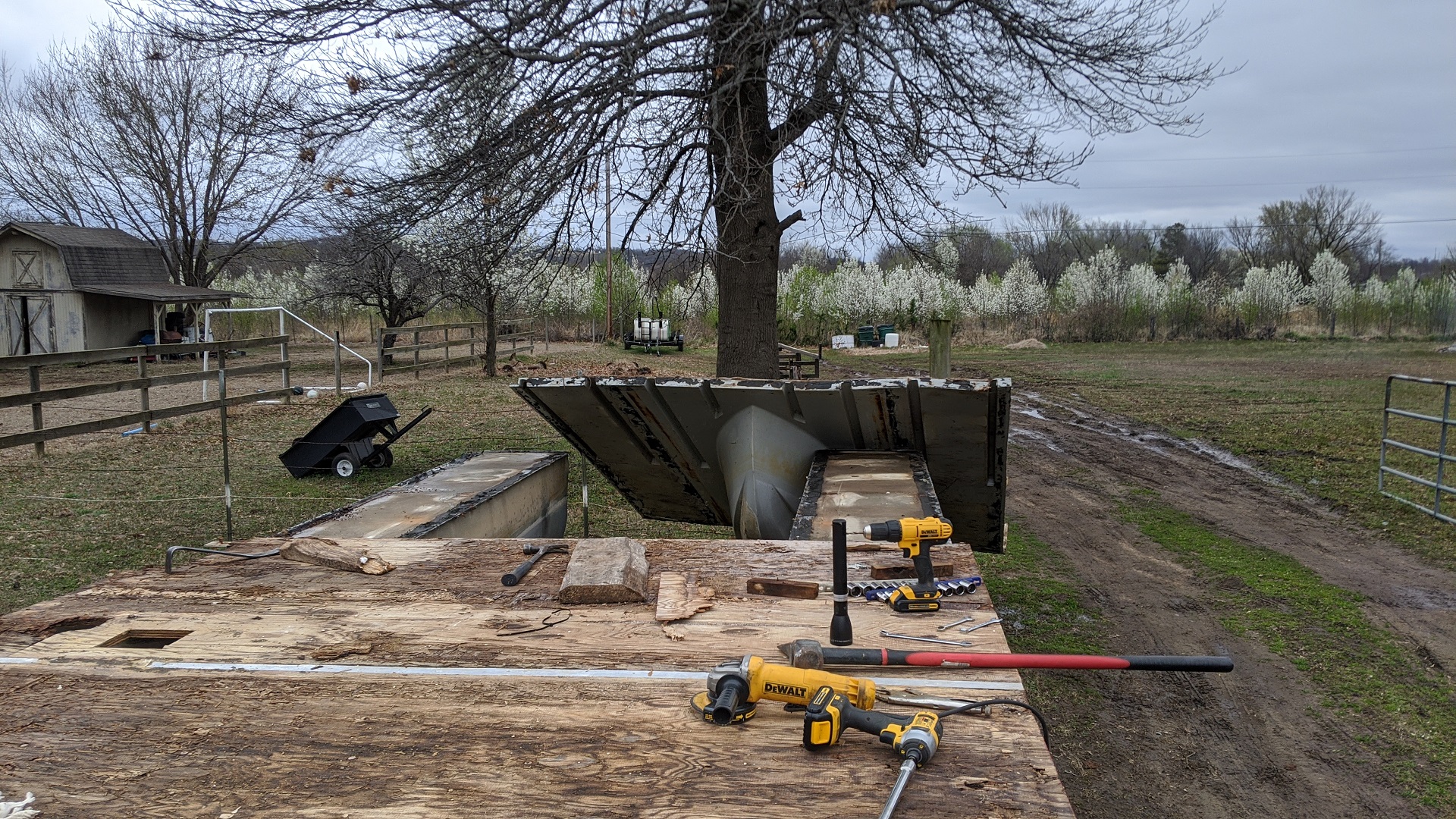

I finally got the trailer out from under the boat, the cinder blocks worked well. I also spent half the day and took the fiberglass transom off, MY GOODNESS was it HEAVY! I had to cut it up to load it in my truck and even the smaller part was surprisingly heavy.
