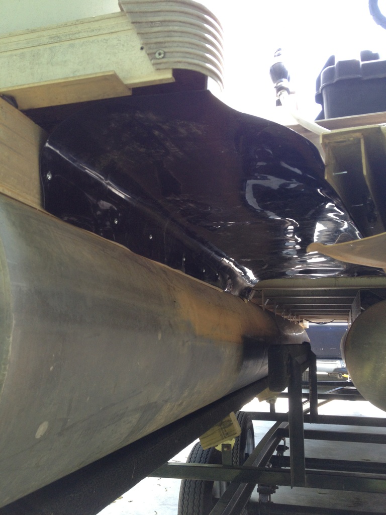

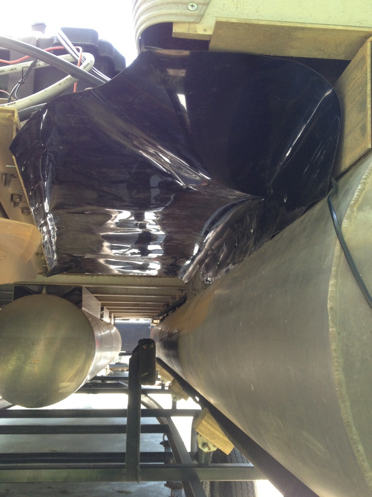

Re: Third log installed, still have work to do.
I could raise the motor, but that will make the bite worse, just too much turbulence.
I did make an alteration that gave me an additional 1 mph, I know that aint much, but every one helps.
Late last summer, Gfretwell hooked me up with some material he had laying around. Its designed for wrapping pilings in saltwater. Its kinda thin, but pretty tough stuff. I used a portion to underskin the back section just past the third log on either side of the transome, even before the log this section took a beating by water and stayed pretty damp.
I'm excited to get the rest of the boat done now, , my only real issue is how to put it in, then install my under-deck ladder.....Hmmm
Thought I posted this, but guess I didnt!
Gretwell was kind enough to hook me up with some material used for wrapping pilings in salt water. Tough, yet thin enough to work with.
I applied it to the area just behind the end of the third log and surrounding the transom. It ended up giving me an additional 1 mph so far, I'm looking forward to finishing the rest in the same to see what happens. My only hold up right now is how to mount my under-deck ladder after installing the underskinning? Hmmm.

spurhunter,
How was that piling wrap to work with? I am thinking about ordering some not sure if I should order the 30 mil or go with the 60 mil. what was your experience with what you worked with?
Thanks, Steve
I was a piece of cake. I am not sure what thickness this is, but it would not hurt to go with the thicker size for sure.
