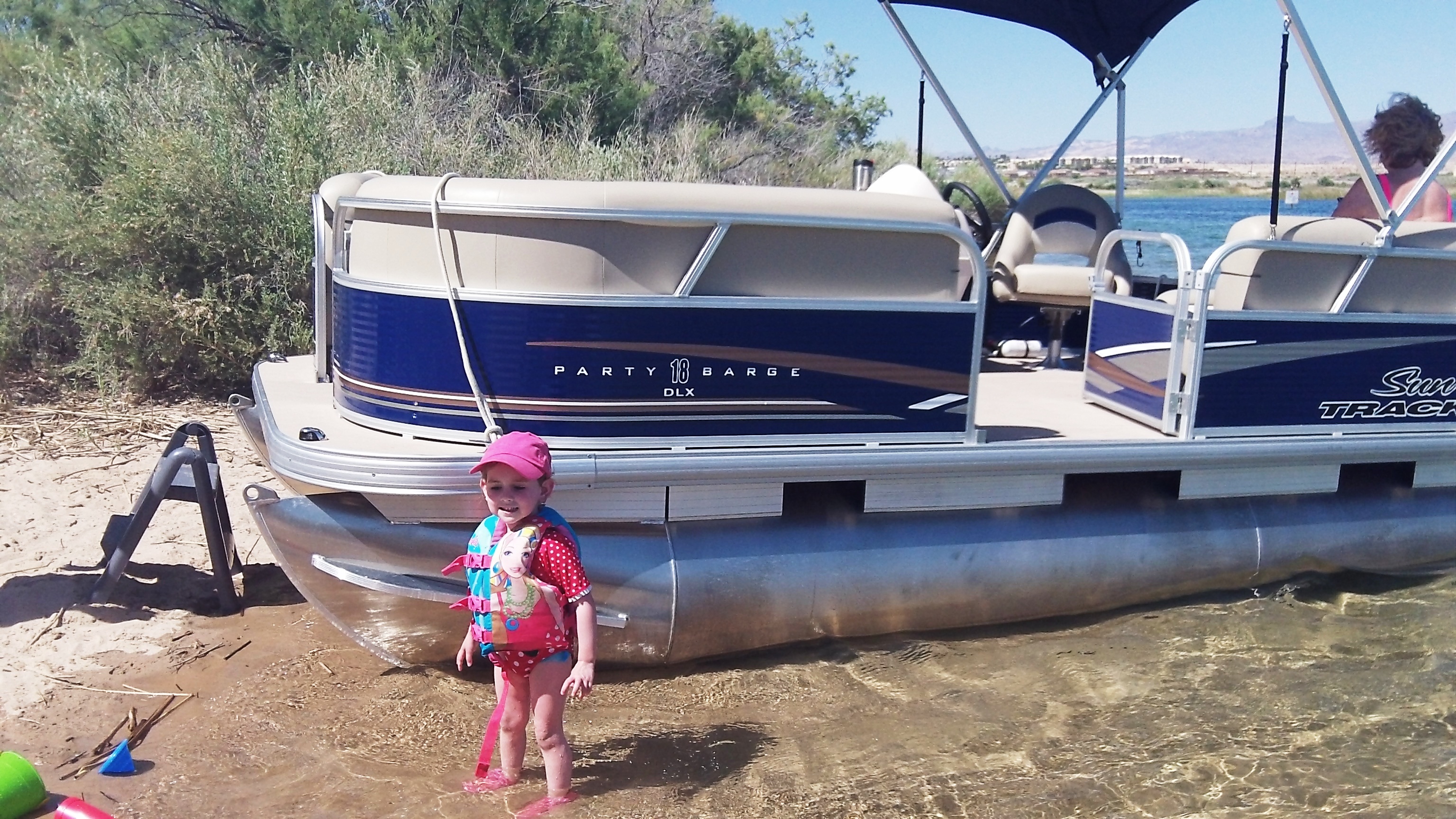

Re: Beaching a Pontoon...
beach on sand, anchor near rocks. Here on the Colorado River there are a lot of sand beaches so isn't much of a problem.
- 100_0009.JPG (1.78 MiB) Viewed 1066 times
