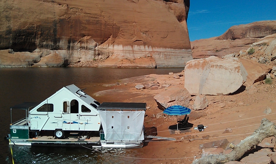

The reason I'll need to support the center is that I've got just a wee bit more weight on my boat than typical. :thumbsup It's well distributed over several stringers under the wheels where 90% of the weight resides - and over two stringers under the tongue. http://www.youtube.com/watch?v=c0IwHewPvEg
I'm still pretty sold on the idea of a center U-log to also help create a better "slip stream" for the two wakes to wash off the vertical walls instead of lapping on to the top of a round tube. It will also provide a better way to fare the new log to the existing transom since it is also U shaped. No need to transition from circular to vertical which would take some fancy sheet metal bending. Besides that I found a used one for $500.00, and it's local!

Ron, I assume you would have the camper off the pontoon while you are doing the swap, right? If so, I don't think you need to worry about support/bending/stress on the outer logs while you are doing the swap. I would think your boat would be lighter than most when doing that, so supporting the center may not be required.
