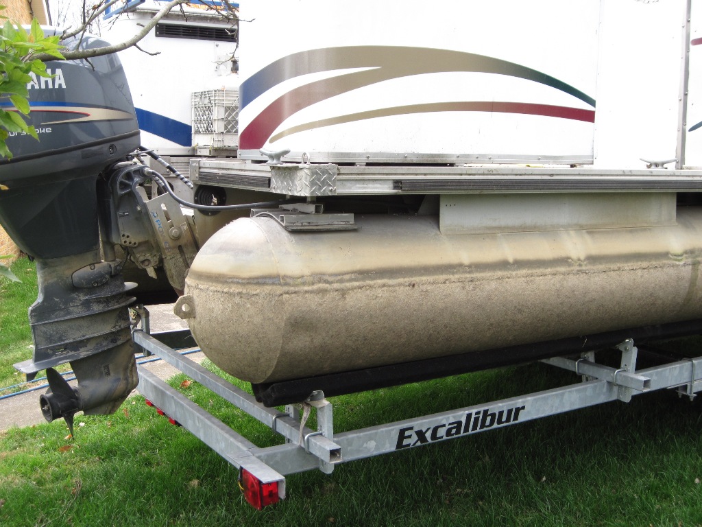

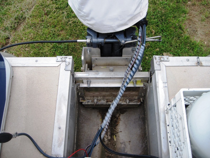

I had to install a jack-plate on our boat simply because I had the opportunity to purchase a new crate motor at a price I simply couldn't pass up. Though they call my unit a jack plate in reality the term is stretching things IMHO. It's all manually adjusted and a person wouldn't be changing anything on the water.
Jack-Plate 018.JPG (265.9 KiB) Viewed 5684 times
As you can see I probably achieved five inches in elevation with the jack plate and was able to utilize the 25" shaft motor on out boat. But if I could have had the 20 in shaft for the same bargain price I wouldn't have bothered fooling around with the jack-plate.
