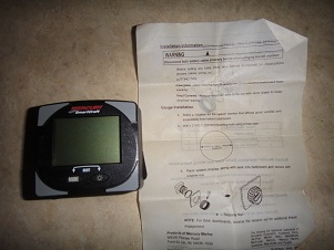

As far as the hour meter, there's 2 ways you can go.
1. Install a simple meter, analog or digital, hooked up to the "ON" side of the key switch. However, you'll have to add the hours presently on the engine, either in your head, or power the meter with 12 volts until you get to the number of hours on the engine. Run you $35-$75 dollars.
2. Have your Mercury shop install the Smartcraft gauge, which will be hooked up to the engine computer and, so it reads true hours, and also tell you oil temp/press, water temp/press, volts, and a host of other valuable info. $175 or so + installation. (Pic below)
Although I can't believe the "Performance Package" & Verado didn't come with smartcraft gauges. My Sun Tracker doesn't have an hour meter, but I'm going to install a new tach with the hour meter in the face.
