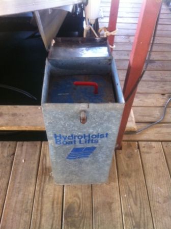

Just boat a used lift for my tritoon. I have a couple of questions? How would I tell what year it is?
The guy before me bought and it was used for a v-hull. He took brackets off and added 4x4 and then 2x8 that his twin tube sat on. My middle toon sits up in the air. Should I go ahead and just add another 2x8 or should I try to get someone to fabricate some brackets and pull the 4x4 off and make 3 bunks?
I was told if I had Hydrohoist refit, it would cost a lot. I know the cheapest thing I could do is add the third 2x8. Just wanted to get some opinions and or ideas. This will be the first experience with owning a lift.

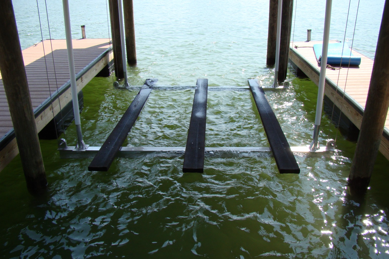

Here's how our tritoon is supported.

Likie mine, it is so old, age really doesn't matter. Fiberglass tanks have not been the in thing for quite a while.
