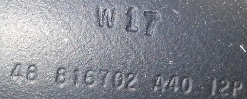

This is from a 93 70HP Mercury Force, aluminum.
W17
48 816702 A40 12P

I believe 48-816702-A40 is the part number.

Quick websearch....
SKU: #48-816702A40
Manufacturer: Mercury Marine
Brand: Black Max
Material: Aluminum
Diameter: 10 - 3/4”
Pitch: 12”
Blades: 3
Rotation: Standard (Clockwise)

According to this site: boatpartguys.com the number may be superseded to 48816702A45 - BLKMX 10 3/4 X 12 which they have listed for $123.

Interesting - so the diameter isn't even some part of this code.
