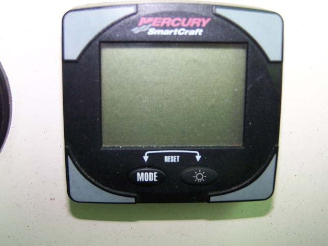

I had this Smartcraft System Monitor installed on 2 of our workboats (Mercury 40HP Jets). It was around $250 installed each. The monitor covers tach, hours, fuel flow, voltage, engine temp, oil pressure, inlet water temp, etc.
It's plug and play for nearly any late model Mercury OB, so if you're comfortable with carving up your dash you can do it yourself. Comes with all necessary wiring for $130 +/-.
