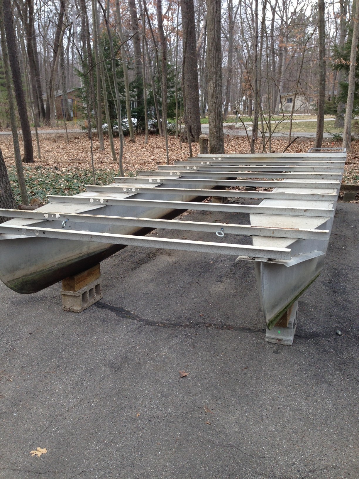

My toons expand and contract significantly with temperature changes much like a sealed gas can that moves from hot to cold environments and vise versa. When this happens, one of the toons "dents" inward (cold) or outward (hot), making a very loud "boom". My boat sits in the water about 200 feet from my house, and I can hear it from within my house (doors and windows closed) when the temperature drops at night. It's really annoying, and it's starting to tick off my neighbors.
Has anyone experienced this before, and, is there anything I can do to fix this?
I'm in the process of refurbishing the boat and have the thing stripped down to just the toons and the cross-members. I figure now is as good of a time to address this than any. Is there such thing as a water-tight pressure relief valve I could install on the top of the toons?
It's a 1988 JC 820
It's a 1988 JC 820

All pontoons will experience some canning effect in general but mostly it's usually not an issue. Your case though isn't what I'd call typical in circumstance. With the strong spring sun and leafless trees the sun has the entire pontoons to work upon to transfer it's energy upon. Once the trees come out in leaf or you get the deck installed the canning will become a lot less extreme. In the meantime if you're pontoons have drain plugs installed try loosing them up or removing them until it's ready to hit the water. Anyway it looks like a good project and please share your progress with us.
