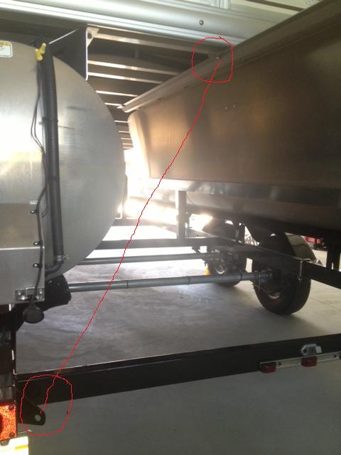

So here is my latest project that I believe will solve my transom tie down issue....
I will be using the retractable tie downs by IMMI (Boat Buckle G2).
In the attached pics you will see where the strap will be run. I will mount the retractable boat buckle at trailer eye strap. I can then pull strap end up and connect to an eye bolt that will replace the rear-most motor pod bolts. I will do this to both sides.
I will probably make a set of 3/16" thick straps (1"X5") to bolt to trailer eye tabs (one end to bolt to trailer eye tab and other end to mount boat buckle) and bend at correct angle so strap is as straight a run to eye bolt as possible.
Another option would be to drill 1/2" holes in trailer cross member directly below the motor pod eye bolts. The Boat Buckles would be mounted here. This would give the straps a vertical run as opposed to an angle. I kind of like this better, but am concerned with drilling 1/2" holes in the trailer cross member.
Questions:
1. Do you see any problems with replacing the rear-most motor pod bolts with eye bolts? The current bolts are 3/8" and replacement eye bolt will be 3/8" stainless steel.
2. Do you see any problem with running the straps at an angle from trailer eye strap up to motor pod eye bolt? Or use my option discussed above?
Thoughts?
Thanks

Most eye bolts are simply a bent loop where the end of the loop is not welded or attached where it meets back at the shaft. Under stress the loop will start to straighten and open up. I would use a "U" bolt. You will have drill an extra hole but that that's not too hard in aluminum. Your placement idea is very good.

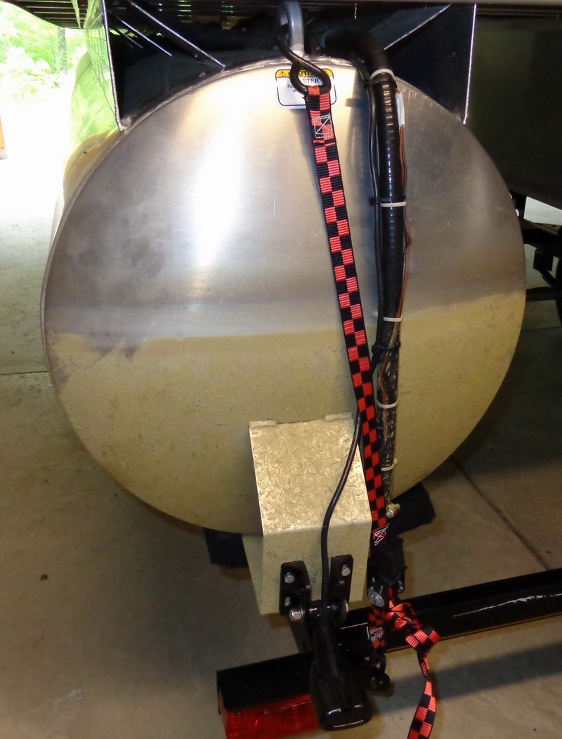

We have same boat. Here's our set up. We always use tiedowns! In this configuration, the strap is outside the transducer wires (tho there's no pressure on them). For a long trip, I'd run the strap underneath the wires.

crspang.....I agree, the unwelded eye bolt could open, but it would take some serious pressure. They also make the eye bolts where they eye is closed. I believe these are cast chrome bronze. These would still be plenty strong, I believe.
sailor.....thanks for the pic...yes, we have same boats. Maybe I should just do the same as you and use a simple tie down. I was a little concerned about the strap smashing the electrical and transducer wires.

I just noticed on your recent pics that your transducer wires are attached to the toon so you wouldn't be able to run the tiedown underneath. I'm with you, moving the tiedown somewhere else is better than running it over the wires.
Also looked at the location of the bolt you're talking about. It appears to be on the engine mount toon (don't know the name), in the same/close to location of the existing bolt. Would it be too much stress having both mounted so close? I'm NOT an engineer, and totally new to tooning. Just wondering. I like your idea of perm mounting of retractable strap to trailer. Very cool and hassle free. Just what you want when gearing up to to go tooning and coming in from a great day on the water. Keep us posted on what you end up doing.

landlockedsailor wrote:I just noticed on your recent pics that your transducer wires are attached to the toon so you wouldn't be able to run the tiedown underneath. I'm with you, moving the tiedown somewhere else is better than running it over the wires.
sailor...yes, my wires are mounted with wire holder to the transducer bracket. Kind of hard going underneath.

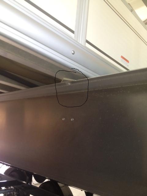

The eye bolt idea I am considering is replacing the current bolt on the motor pod (circled area on top pic). I would remove this 3/8" bolt (you should have this same bolt) and replace it with a 3/8" eye bolt. This would become my strap connection on the boat side. Is this any clearer of a description? Wish I had photoshop and I could add it to the pic for reference.
That was my question.....is having this double as both a bolt and connection point for the tie own a bad idea?

SoCal, I don't know if double-tasking the new bolt would be a problem or not. I know a lot of other people on the forum would have good answer. Glad you're a believer in tiedowns though!
